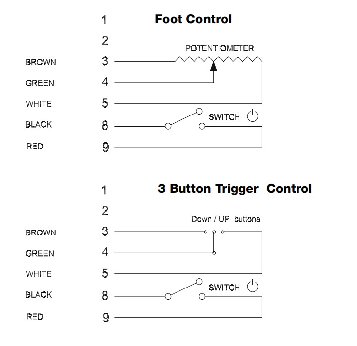

Good morning chaps, I bought a few years ago a pair of ta202 AC/DC and from experience I didn’t like the power dial button on the torch that came stock with the welders and for one I asked for a Parweld torch as that has a similar design -bar the naff color scheme ! Anyway, long story short I never noticed the torches have different plugs and gas receptacles on them and after selling one welder I was left with a welder that I couldn’t use ! I then went on the forum and Richard kindly offered to send me one plug for just the postage cost but- as a true gent he is- he sent 2 plugs for just a fiver ! Much appreciated Sir !
Last night I tried to graft the Parweld torch into the TA plug and the torch works however only down button works and power switch- up button doesn’t do naff all ! I wired it as per the colors but it seems to me that probably TA 202 has a pin into a different receptacle in the plug ! Just to mention the Parweld torch has 3 buttons !
