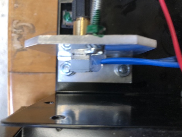

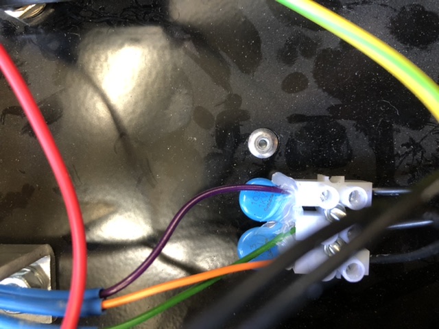

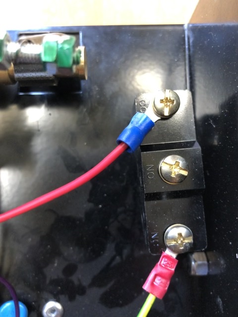

Attached are some pictures of the internals of the “amazingly” made foot pedal.
looking at the capacitors they seem to daisy chain between all wires (which doesn’t make sense)
