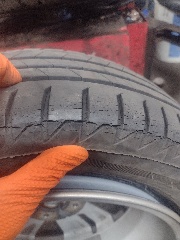

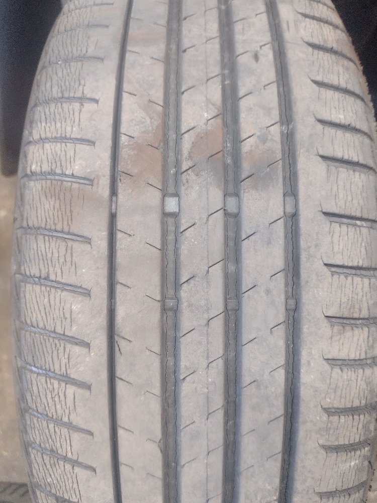

What brand were the tyres? they definitely haven't been looked after, some of it can be attributed to UV, but not the cracks in the centre or inner edges. Interesting to see the DOT codes, it wouldn't be the first time the tyres are significantly older than the rest of the car, usually caused by the seller not wanting to let it go with 'good' tyres on....

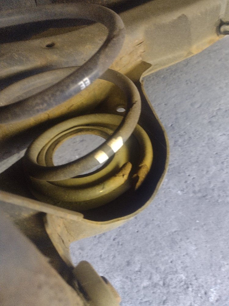

The broken spring is generally down to 'sudden decompression / recompression' caused by road surface deterioration - 'pot holes' if you prefer.
I am fed up with fitting springs at work.
Roads are full of deep potholes near me....
her last car did the same
i try to miss them and go over speed bumps real slow in winter as cold weather on the steel makes them more brittle and prone to snap, ive had about 5 go on me in the last 20 years
