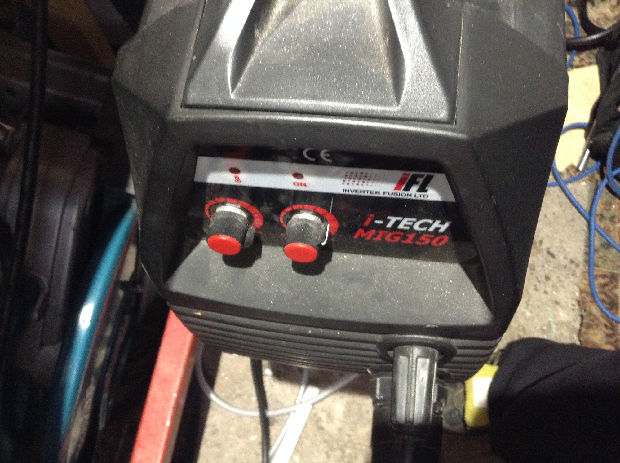

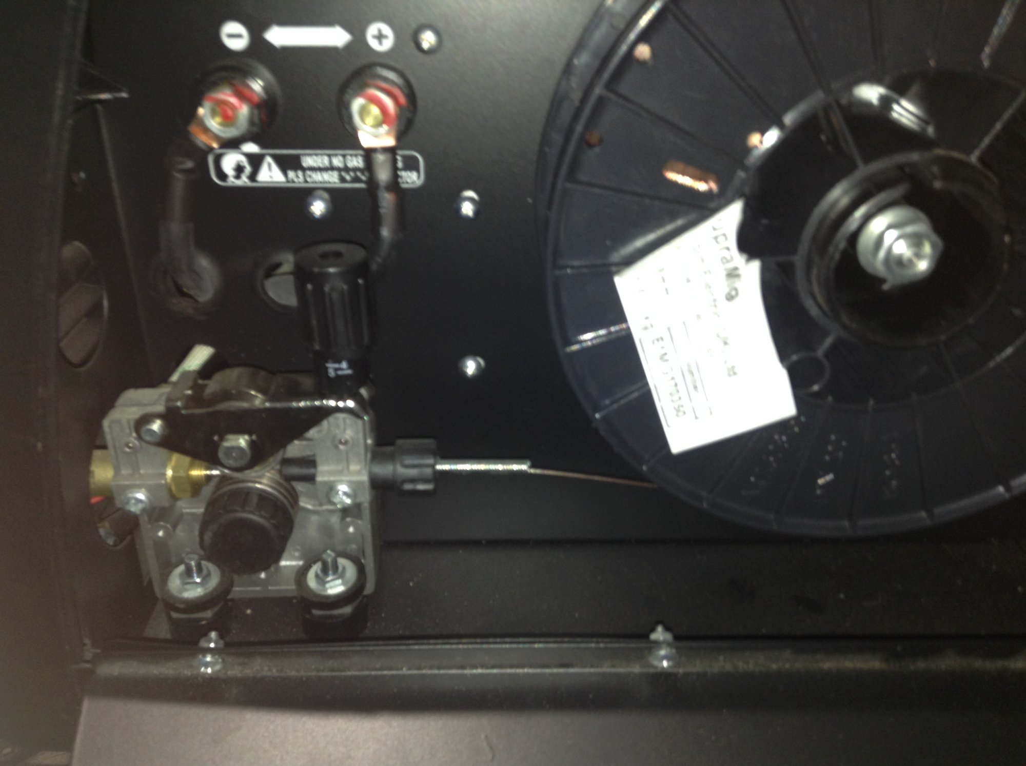

This is what I have for mig side of my work https://www.premierwelding.com/ifl-i-tech-mig150Looking for more than 100amps really. Besides the Morris Minor, I could do with welding some new hinge brackets on the garden gates etc. I don't want to be limited to just narrow guage steel and would imagine 135amps is the minimum I need really. Corfe Castle is a lot of diesel away from Peterborough too. Thanks for the heads up though.

It's because people hang onto them I manly do tig and only use the mig once or twice a monthThey seem hard to find second hand! It has been suggested that buying a second hand mig makes a lot of sense because once the car is complete, the option of selling the mig on for more or less what was paid for it is a real possibility. Finding a second hand IFL has been initially challenging! That could be that not many were sold or because people hang on to them.
I agree and with the ifl you can use any torch you want and it's inverterSomething that hasn't been mentioned is the flexibility of the torch lead. If you're trying to get into awkward welding positions lying on your back under a car you'll discover that a nice flexible welding torch is a godsend.

If you can stretch the budget I would advise you to go for an inverter based mig. It will be a lot nicer to use & easier for a beginner.
