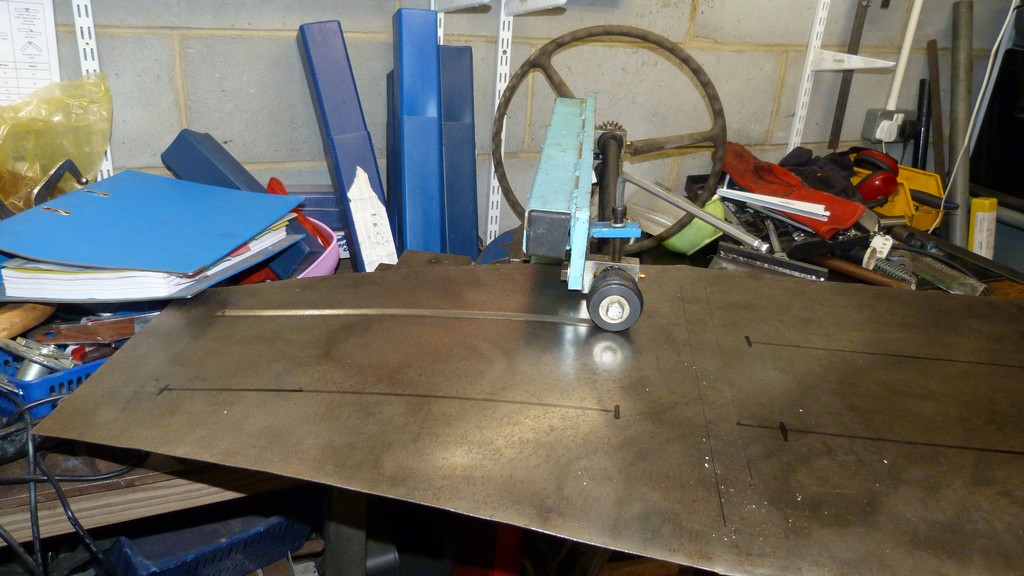

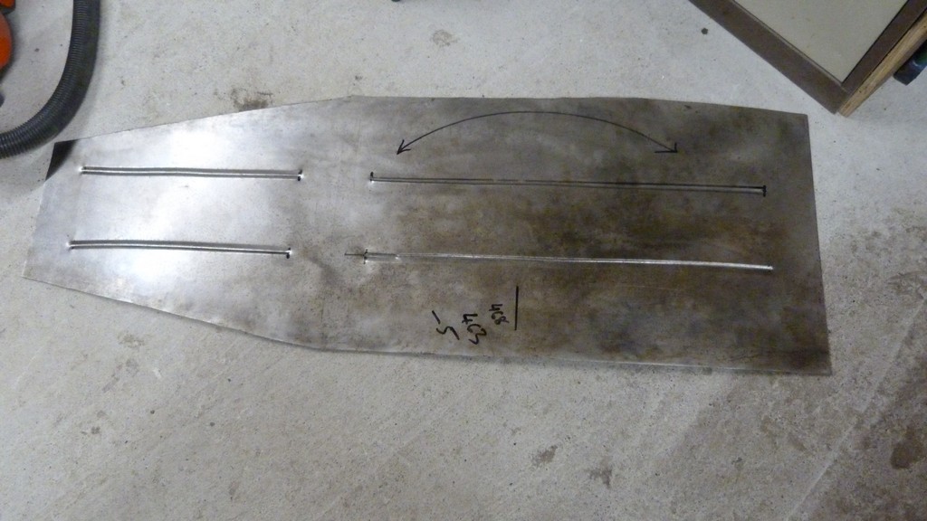

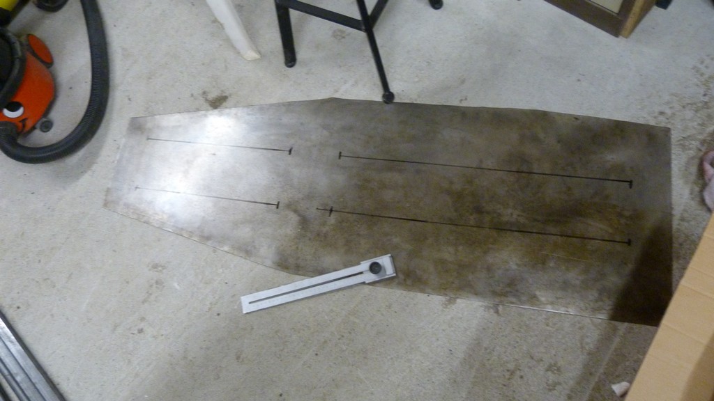

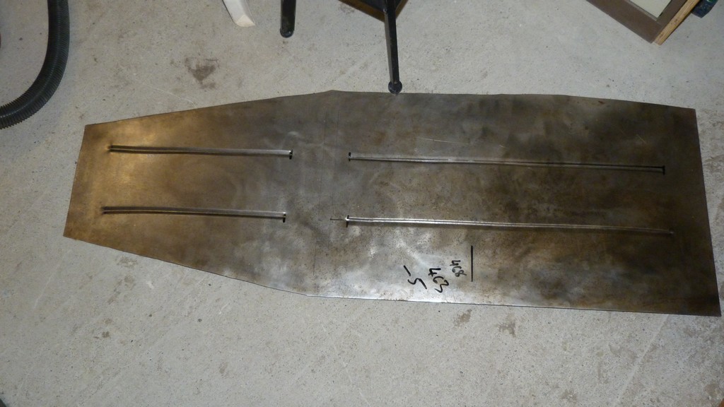

There's a curve front to back now that wasn't there before. I was curious to see how the material moved and measured the width of the panel before and after. The panel seems to have lost 5mm. The other panel lost 2mm which seems a more reasonable amount so maybe I made a measuring error with this one.
