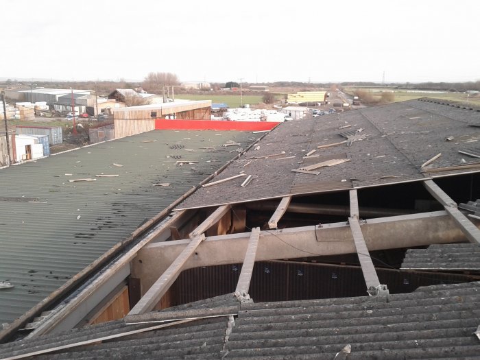

these type of sheets when old have a lot of thermal movement and just crack whatever is glooped on top of them....once they lose there compound strength the only choice is to replace for a one hit repair or if you have the money and a strong will to live then think about replacing the lot for insulated steel profile sheeting.Whatever you choose remember working and walking on these old assy sheets is like playing with a loaded gun if your not familar with them so be very carefull
