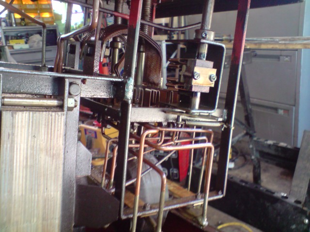

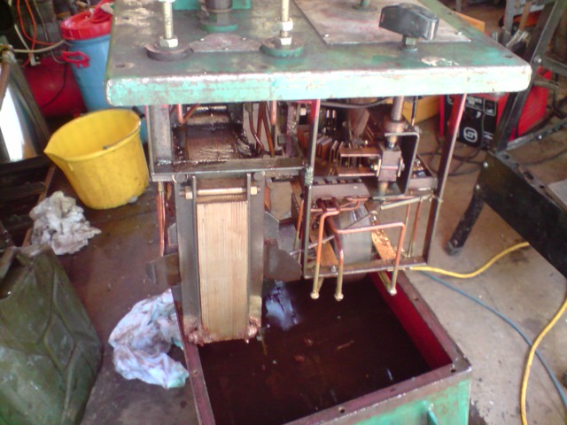

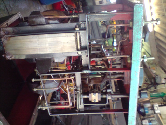

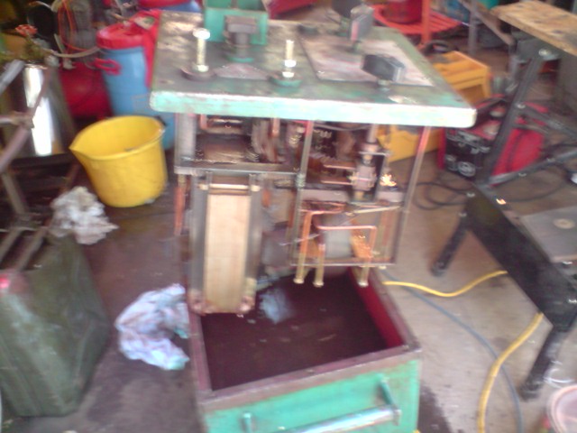

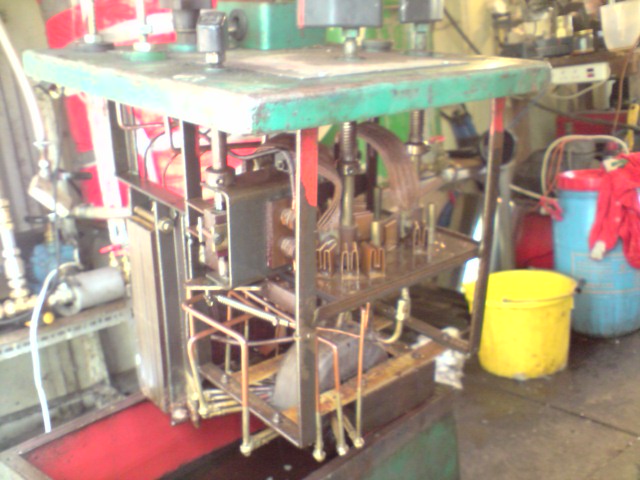

heres a few pics of the guts of my old oxford. i managed to get it out by myself, had to prize it out with a few screw drivers and then lift. not that bad. oxford rt180
. Is there some sort of seal between the top and sides and if so do you think it would keep out water from a power washer(I'm guessing the answer is no)
. I was looking at your photos and it looks like there is a bit of corrosion at the bottom it doesn't look to bad but it has made me think. Ours is still working but for how long. Is there any way to check if there is water at the bottom with out taking it apart? I've never looked underneath it, is there a drain plug do you know?
Thanks for the reply. You are right it looks like it will have to come apart, I had a look under it, no drain plug. I couldn't believe it when I found out the boss had power washed it, bet he doesn't do it again when he finds out how much the oil will be to refill it!![]()
what oil do you need to fill it with?
Shell Diala will do it. be seated though when you get the price!
