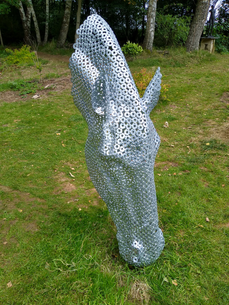

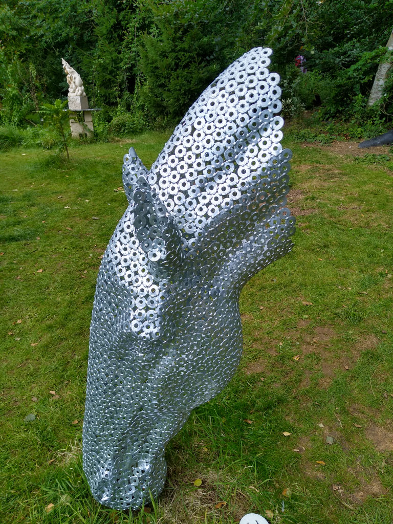

I've always found animal mannequins cost a lot more than ordinary human ones. A stylised horses head shouldn't be too hard to shape out of glued together polystyrene. Then coat it in plaster then some plaster bandage. My first sculpture I used papier mache, but it took ages and was a pain for burning. They don't take long to tack up, but the one I made out of nuts I brazed.
Can I ask what you used as a former for the female ones? A mannequine?
