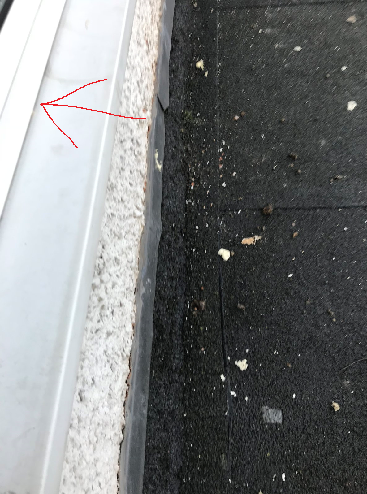

It's worth checking that the gap between the frame and cill is clear (red arrow below) - this was full of crud on one of my windows so water would accumulate in the frame rather than drain out through the drain holes and out of this gap.

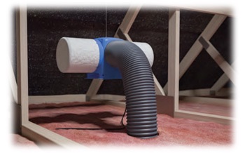

When I was sparking we used to fit a fair few of the Nuaire fans in the loft for a damp proof company, not cheap but worked wonders for condensation problems it seems. Usually fitted the vent on the landing. Works by creating positive air pressure in the house so there is a constant flow of air. We were both small local companies so we'd quite often end up back doing further unrelated work and the homeowners said they cleared up the problems.
