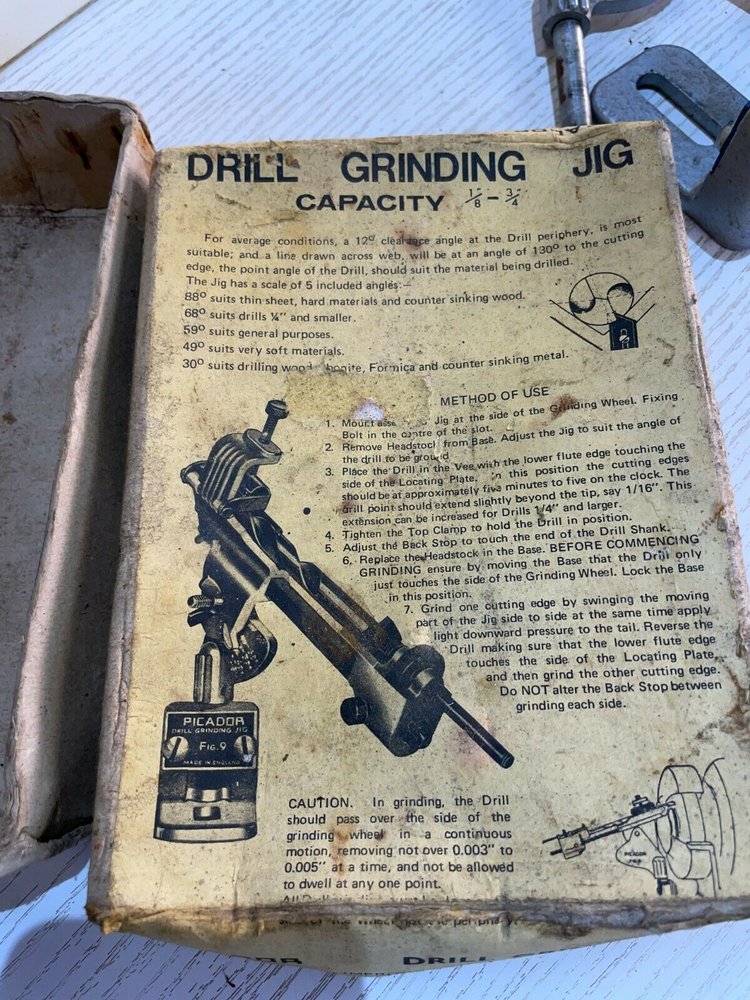

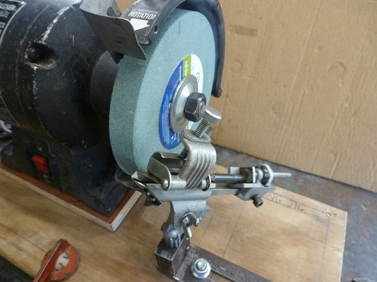

For anyone interested in setting up a Picador drill sharpening jig correctly.......................

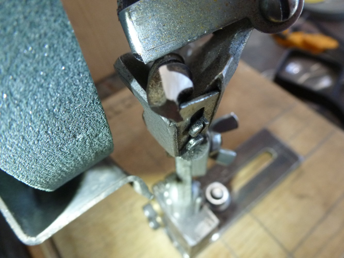

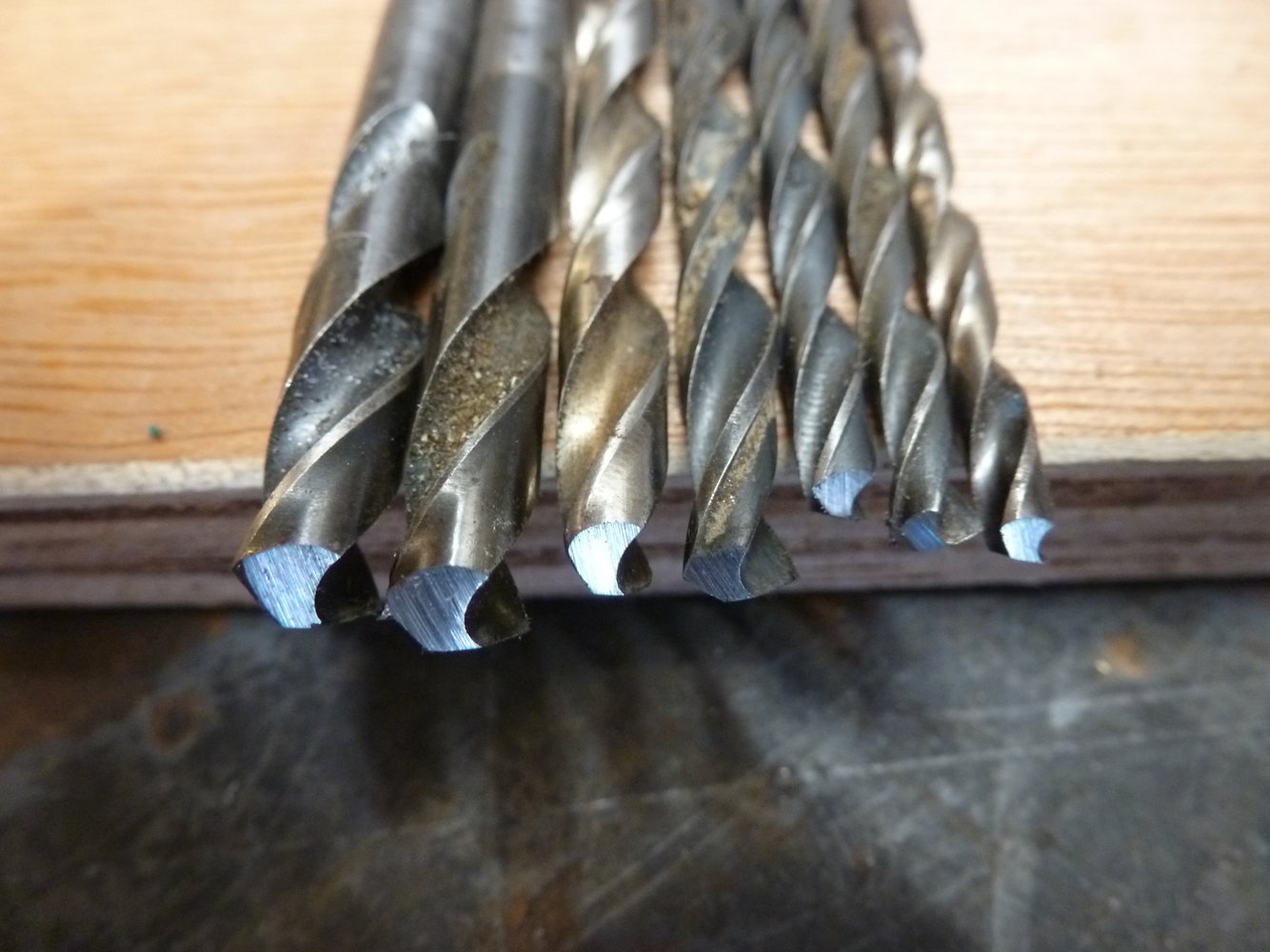

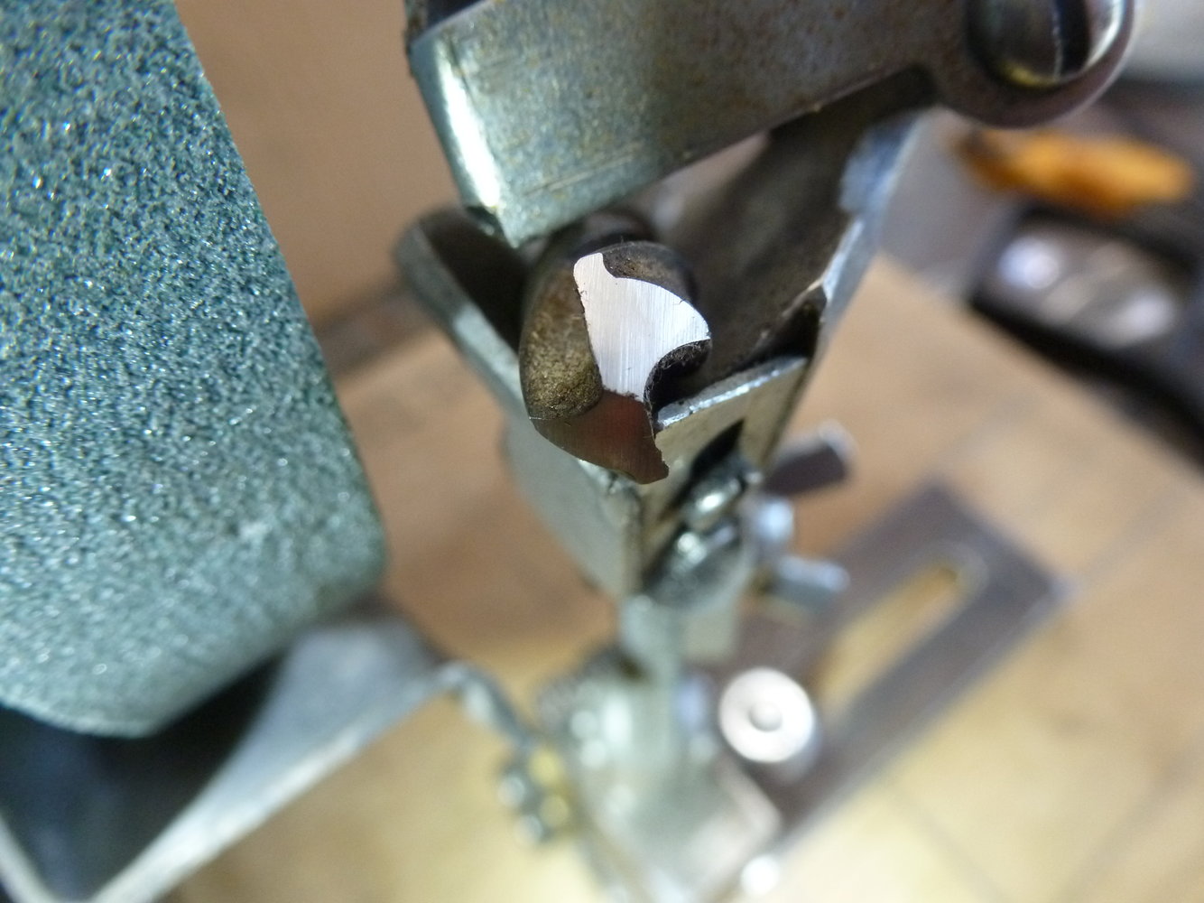

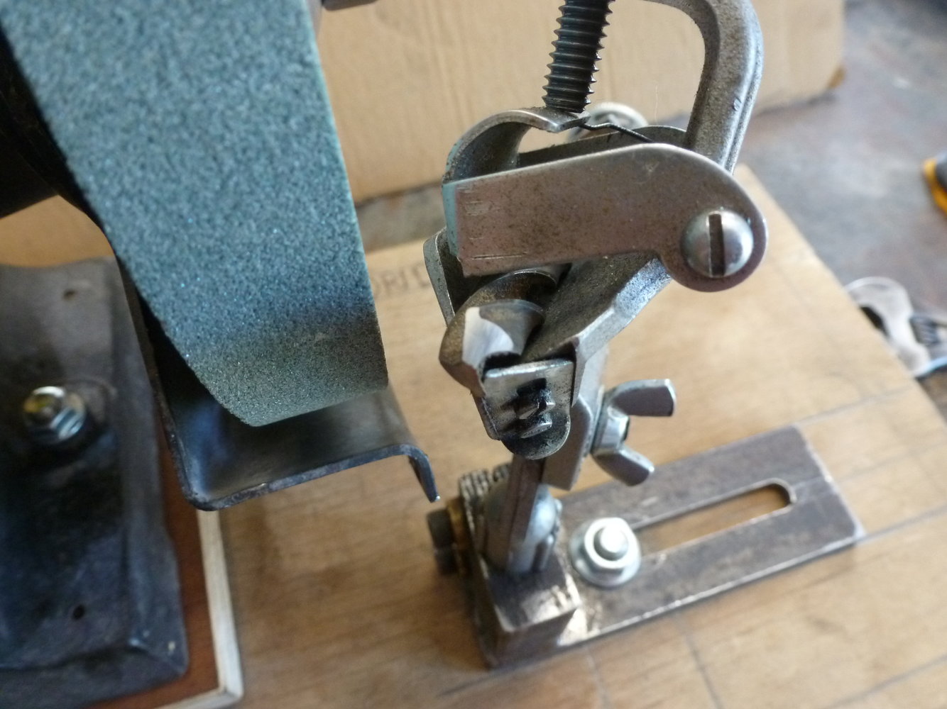

Ensure you set the drill bit with the cutting edges at the 5-to-5 position which will in turn ensure that the chisel edge is ground to approximately 45 degrees to the cutting edge.
I found setting the jig to the 59 degree position which achieved a total 118 degrees point angle gave very good results.

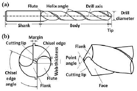

If you are really lost with the terminology see the photos below which includes a diagram.
