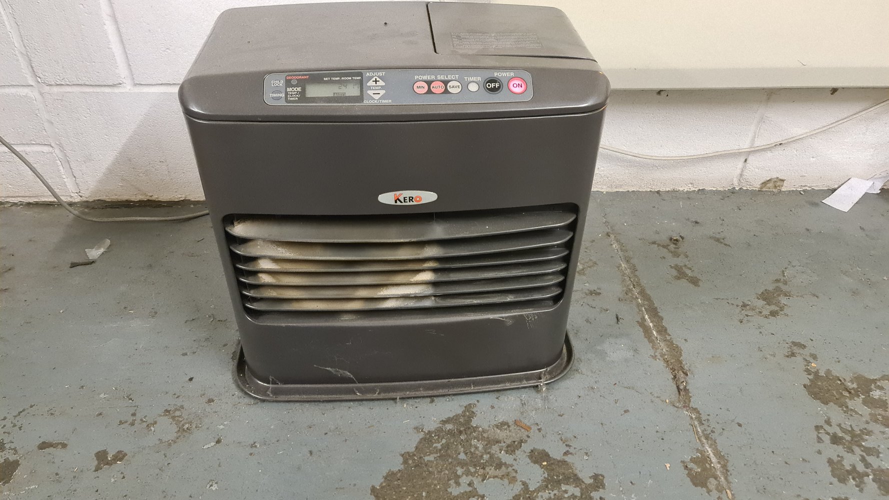

That well insulated you could use a 60W light bulb!The one and only thing that the ‘supposed best’ come out ‘best’ is that 100% of the heat energy produced goes into the area to be warmed.
For me, they fail miserably on several counts.
My workshop is well draught-proofed, so It would soon be making CO (OK it might well trip, but that is no good to me).
My workshop is heavily insulated (at least 100mm and much more on most) so does not need a lot of heat for very long (I don’t manage too long in the workshop, these days, before needing a rest, anyway).
Lathe, mill and tooling need a sufficiently dry atmosphere to avoid any rust risk - which costs me leccy to maintain a low relative humidity, using a desiccator dehumidifier for a couple hours a night when needed.
It’s not that large a volume - only about 35 metres cubed, so any smells would soon build up - it’s bad enough when I use cutting oil - and there ain’t much floor space available.
The warm air is easily directed from a diesel air heater, via ducting, to where it might be needed - and it can be ducted downwards (rather than convecting directly to the ceiling).
The air heater can be placed outside the work area if necessary.
The above reasons are why there is no way I would buy one. Furthermore I realise the benefits of paying out for insulation and draught-proofing - rather than paying to heat the atmosphere - as it is obvious to me that my method is much cheaper in the fairly short term. My insulation also keeps the workshop cool in the summer (as long as I don’t forget to close the door during the hot days).
But this is for my situation - a relatively small volume for my metal working hobby. I bought nearly all my insulation for peanuts - a couple of quid (max) per roll of 150mm rockwool insulation, approx equivalent of 7 1/2 sheets of 100mm celotex for just over £50 and 4 whole sheets of 100mm Recticel for about £50. All from car boot, and auctions over a period of time. A large roll of aluminised bubble insulation (about 1.8m x 20m for about £25. The garage doors for the original structure cost nothing - only collection costs.
I once missed 8-10 full sheets of 100mm celotex at an auction - they sold for a tenner! So bargains are out there!

Unless they're exhausting their output via a flue going out through the wall, of course they're putting water into the room. Approx 1kg for every kg of fuel.Of course 3 years of experience running one counts for nothing.....
And no they don't generate loads of water either.
