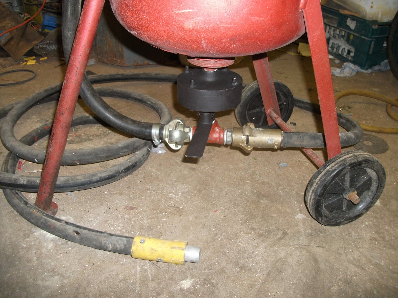

Think of it as an air relay.
It needs a signal to operate.
The "signal" is air, fed to a spring loaded deadman on the handle that is normally open, so the air just vents to the atmosphere. If you've loads of air and someone else is paying for making it, then no problem.
When you operate the deadman it sends the air through the deadman to the main valve and operates it, sending the main high flow, high pressure air to the pot to close the pop-up valve and start the blasting process.
It's a simple system and I would keep it operational however, they are really for big nossles that require a lot of air that can do serious damage if you get a burst or a medical emergency (for example)
If you only have a 3 or 5hp compressor I wouldn't worry overly.
Also, the amount of air venting out the deadman while you are trying to build up air pressure again, will get old very quickly.
A sealed system operated off a foot pedal, for example, is a lot less wasteful, but is not inherently as safe, but can be made safe enough. (In my opinion)
