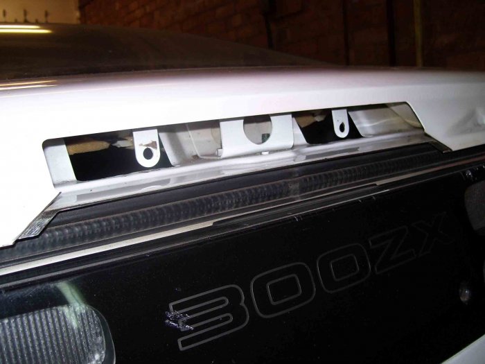

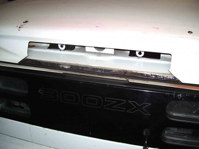

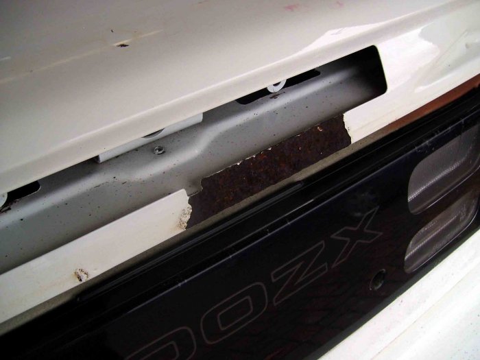

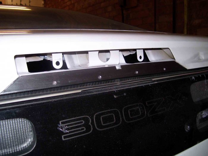

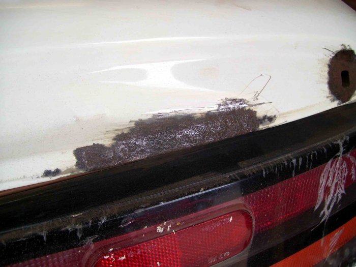

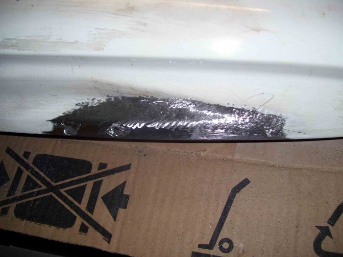

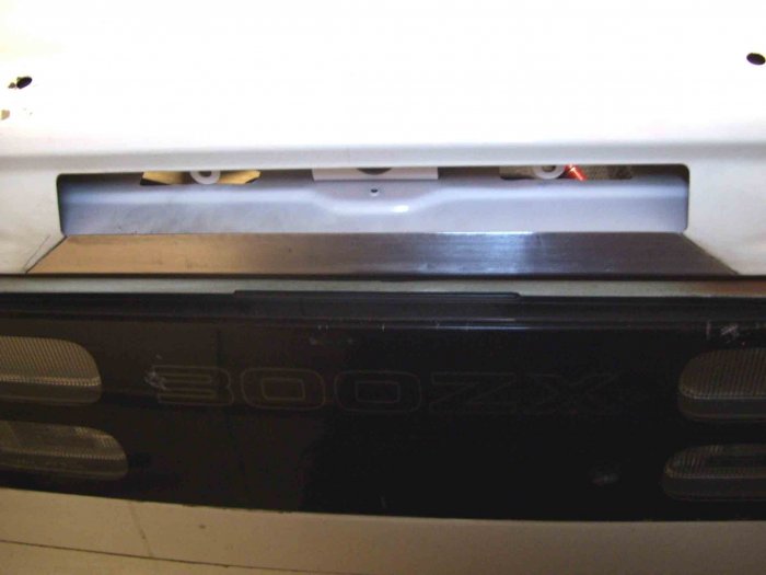

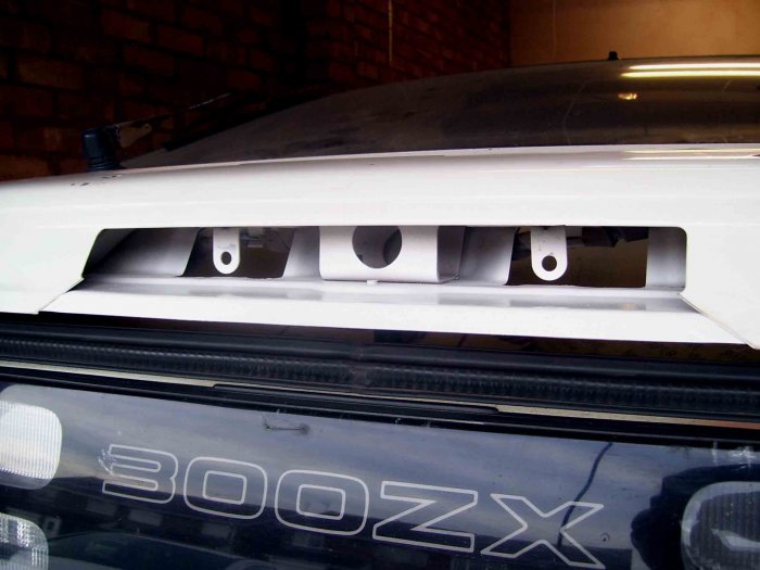

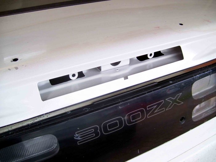

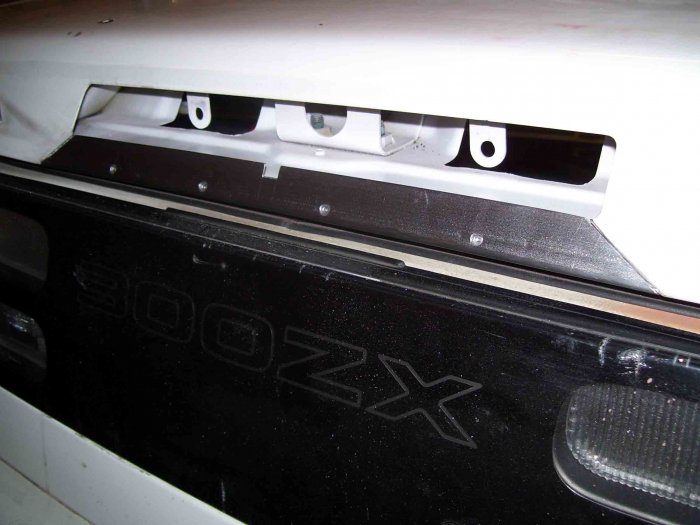

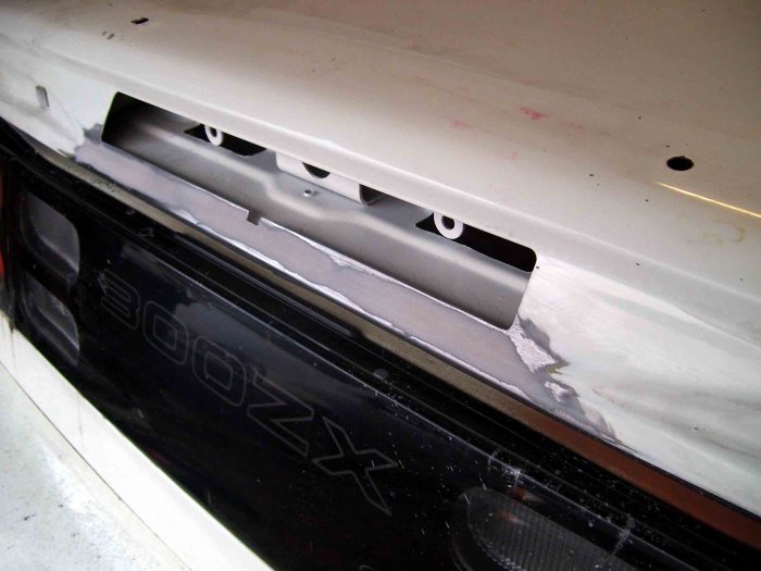

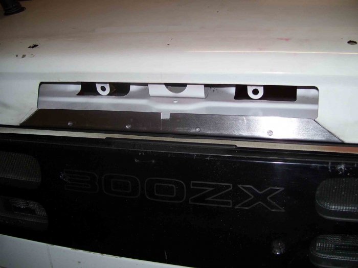

Decided to delve a little deeper tonight.

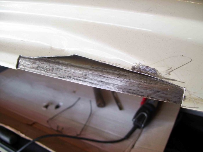

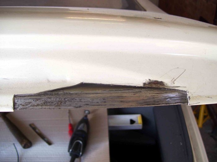

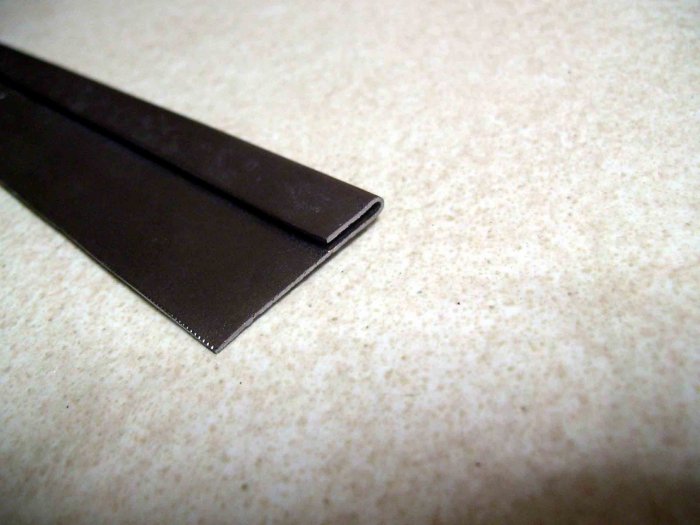

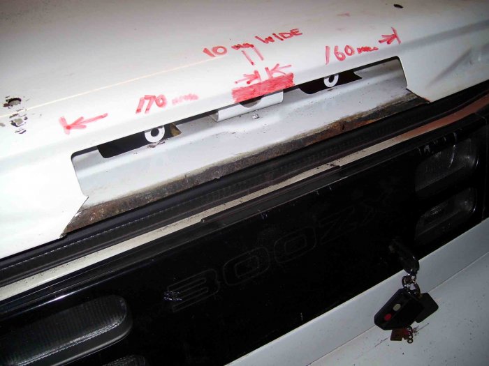

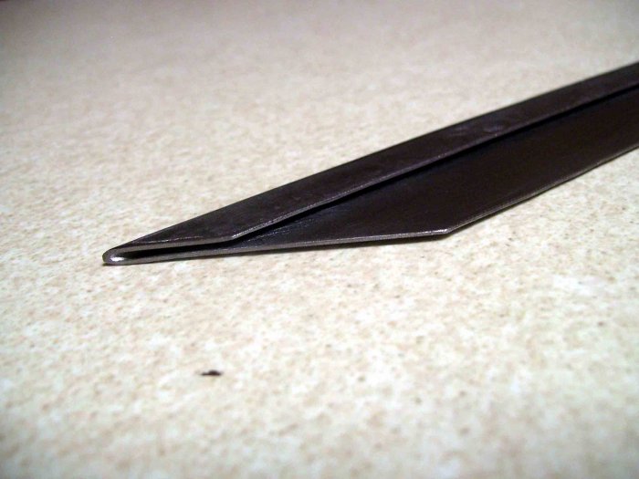

After leaving some measurements behind of the slotted feature in the section to be removed, I carefully cut the section of the outer skin away.
It was as I first thought, a folded seam.

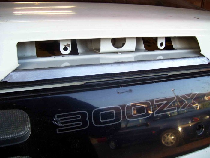

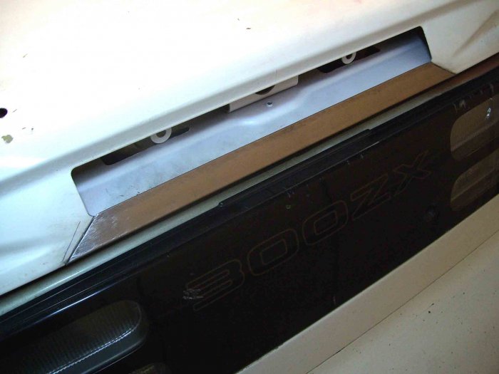

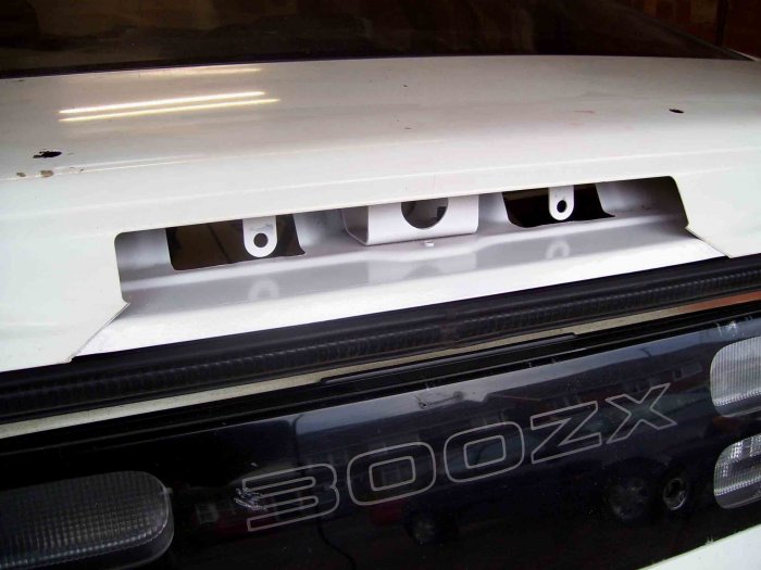

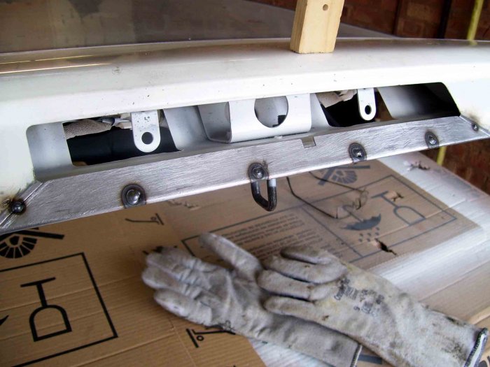

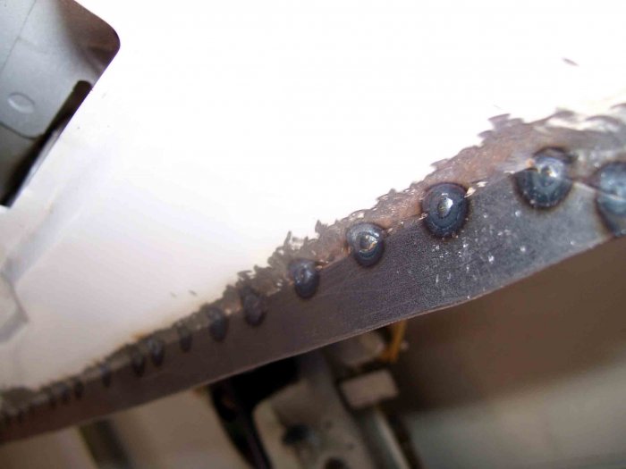

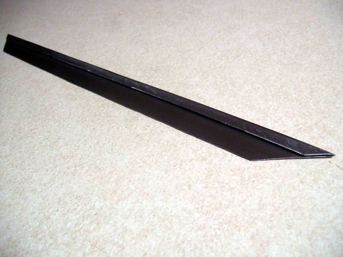

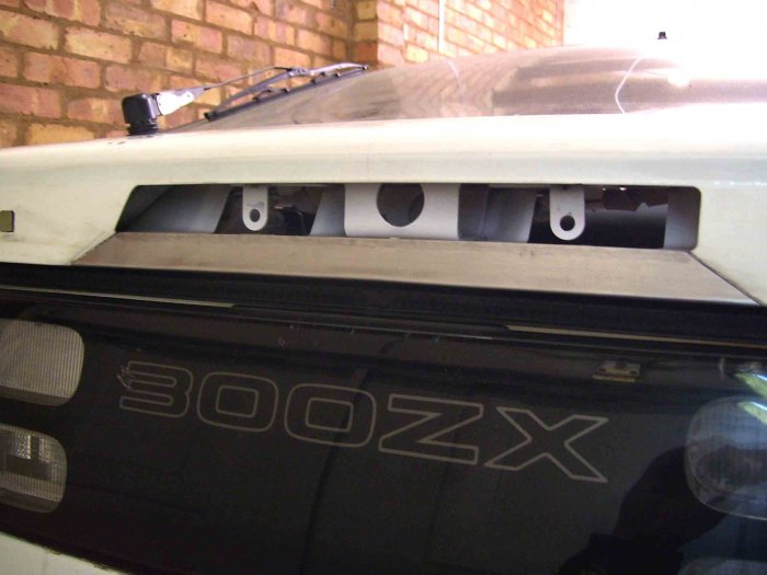

Once that was done, I decided to take out almost the same length of panel below. I stopped a little short so as to give me an edge to weld to.
Next stage will be to grind away any remaining surface rust and treat with inhibitor.
After that I will clean away the surrounding paint work ready for the new metal.

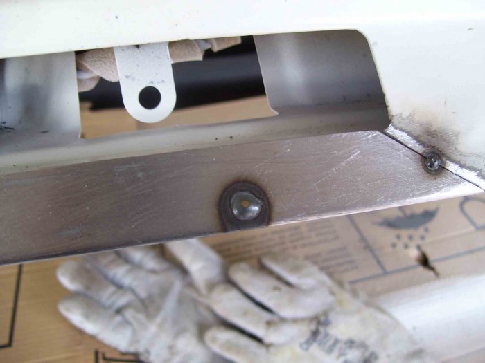

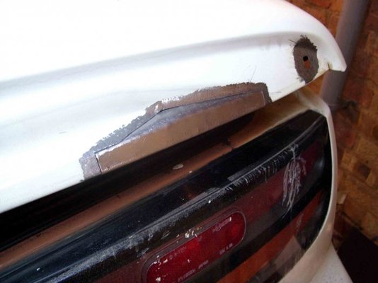

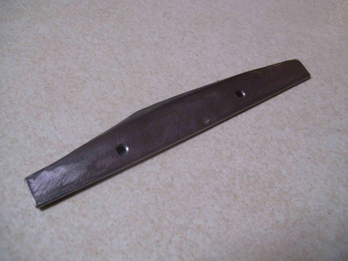

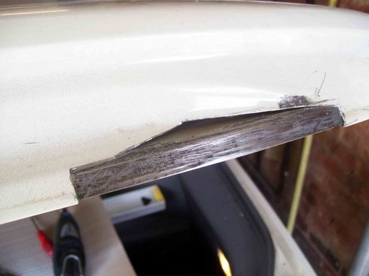

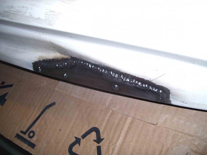

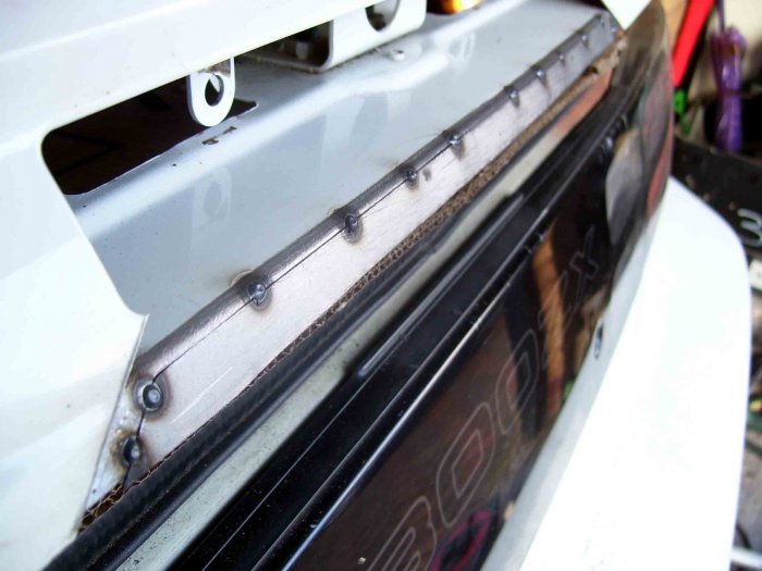

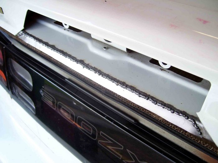

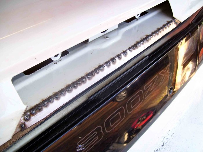

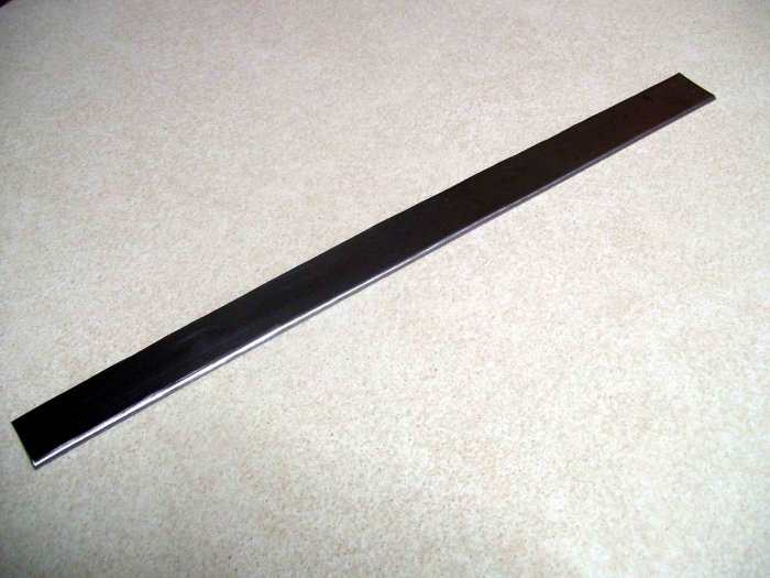

(well sort of)
and dressed back.
Fortunately it will be hidden from view and will not be too detrimental.
