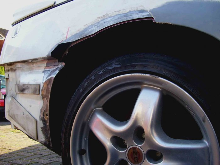

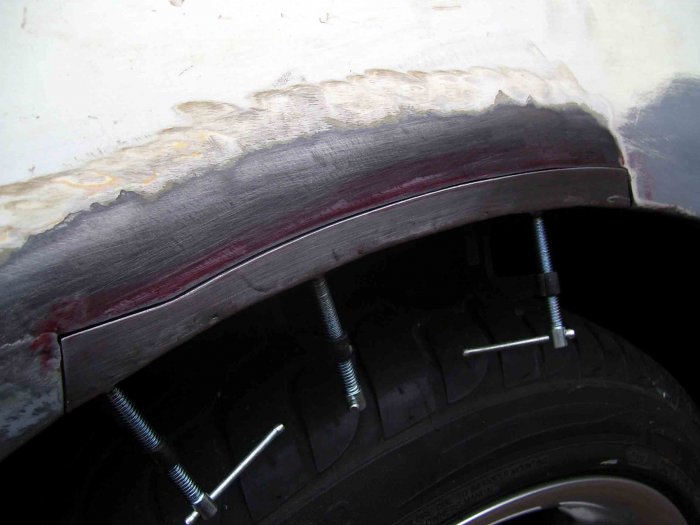

For all of you of weak heart or nervous disposition, look away now.

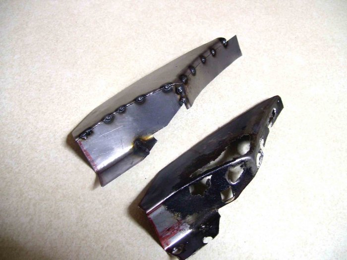

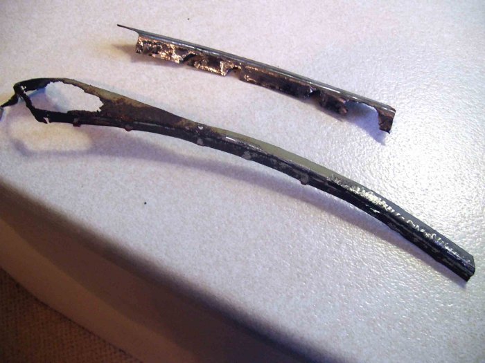

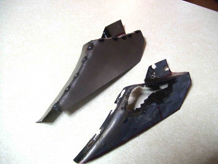

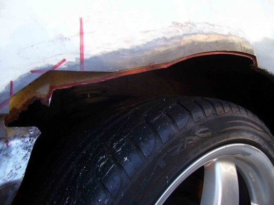

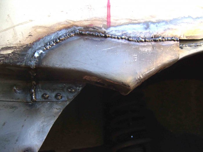

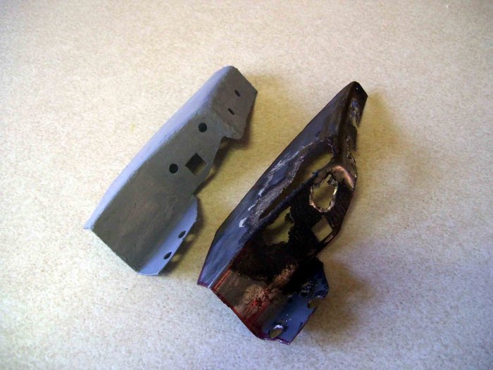

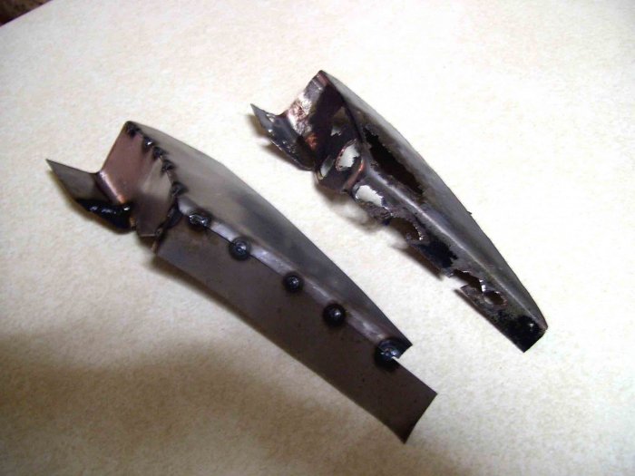

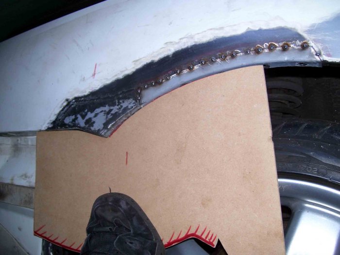

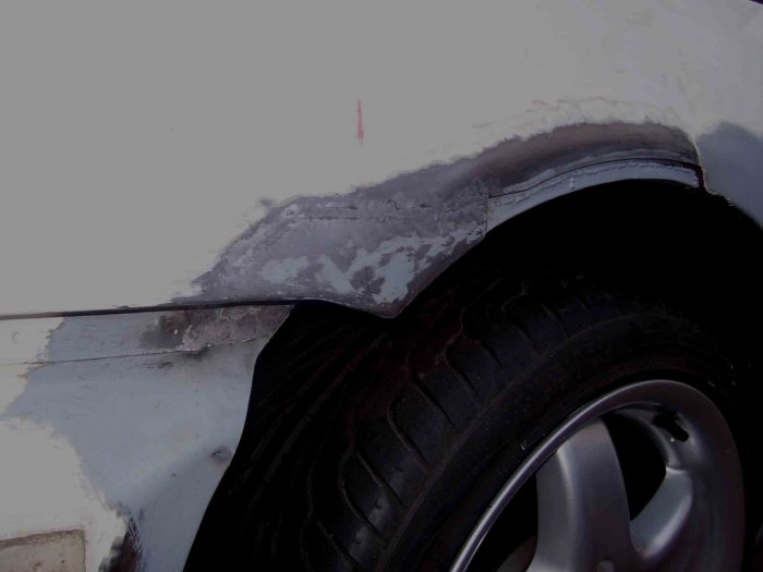

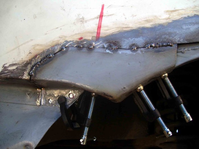

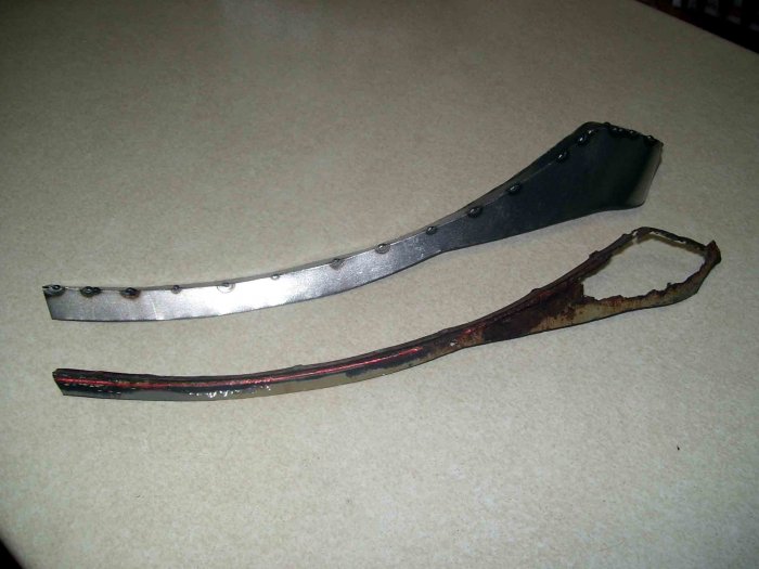

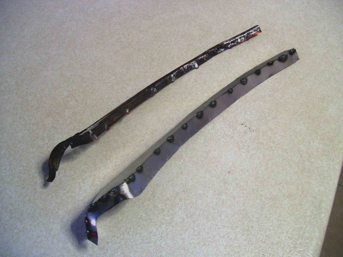

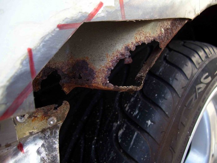

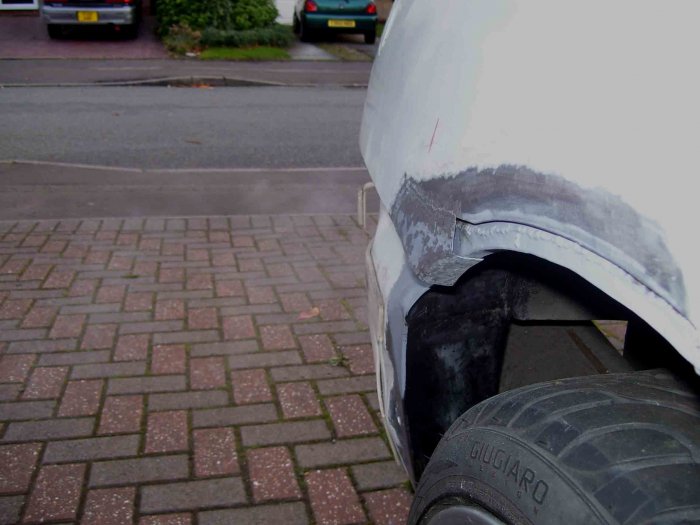

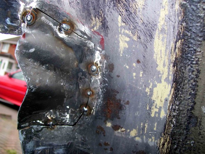

Making sure I could replicate the existing by way of templates etc' I decided to go for it.

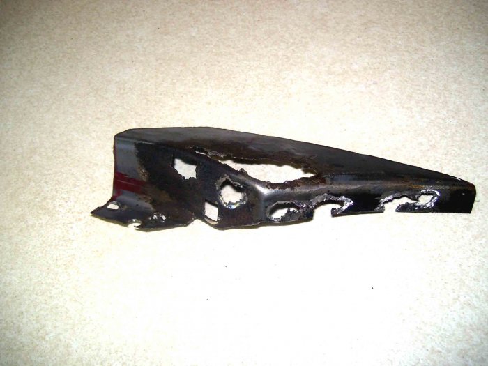

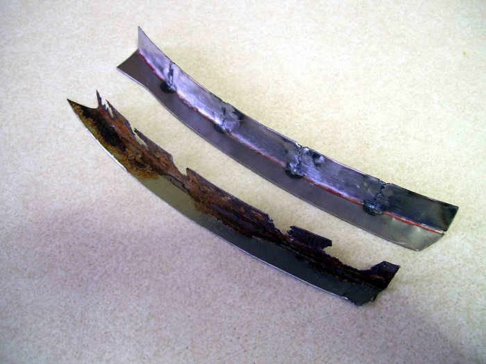

I tried to maintain the original shape of each section I cut away so as to use as a guide when making the replacements.
I will cut the inner areas out at the top next,
this will allow me to finish off this area complete before tackling the lower part of the wheel arch.

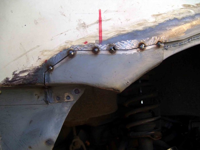

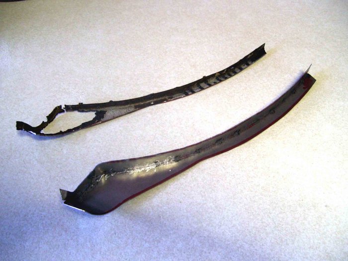

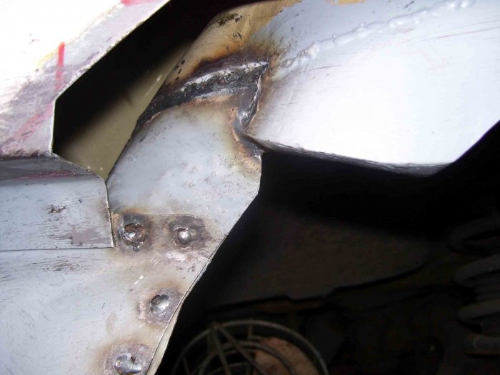

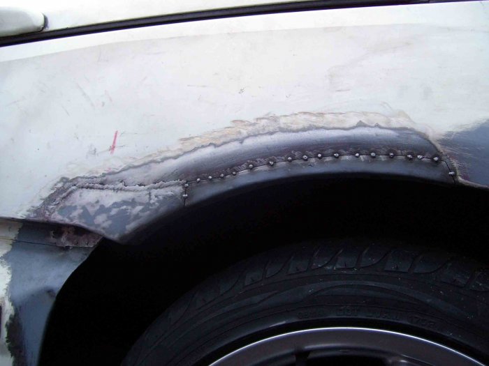

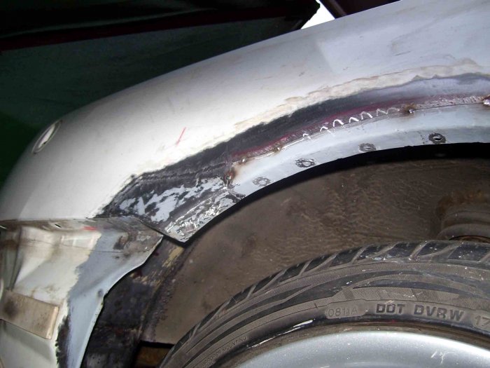

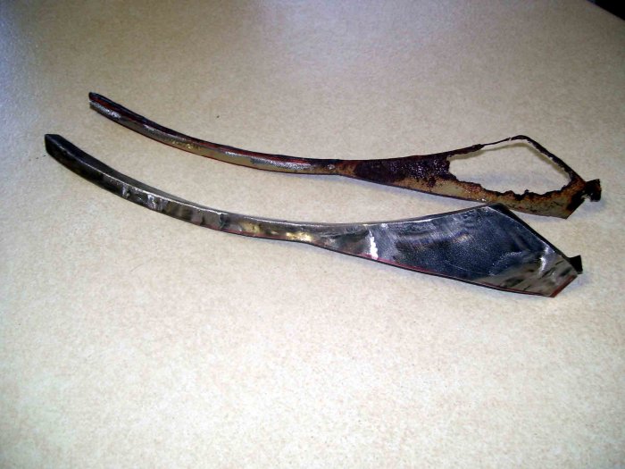

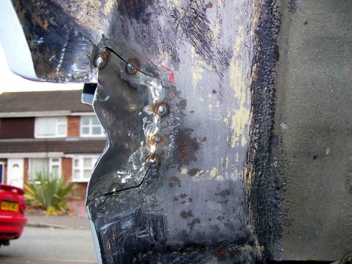

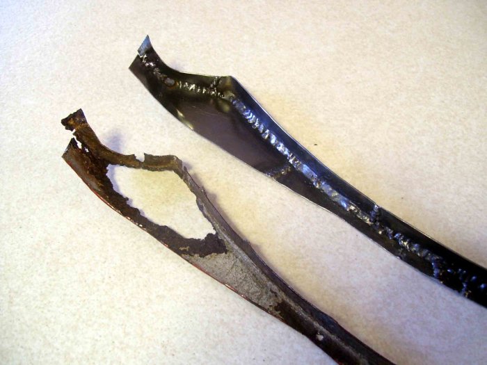

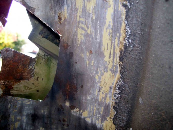

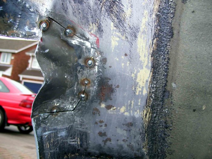

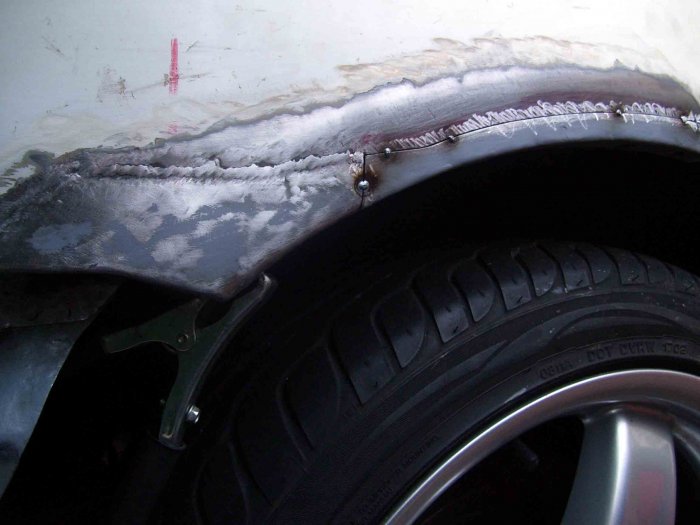

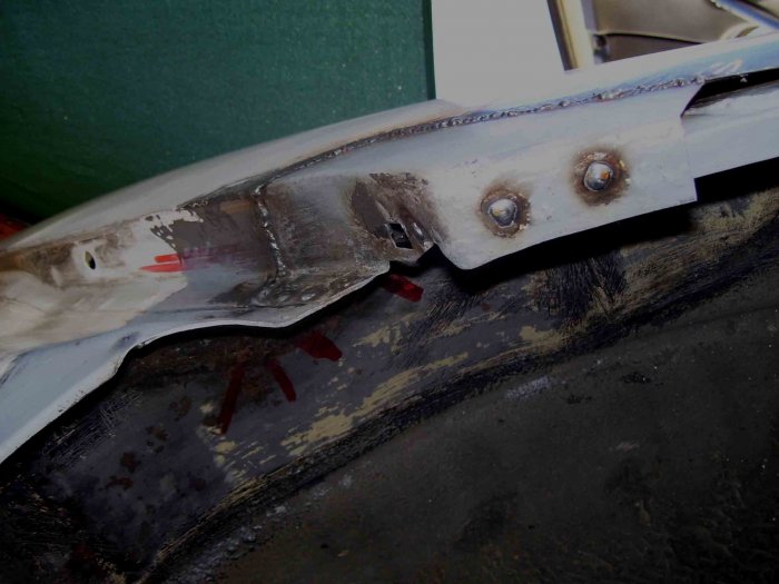

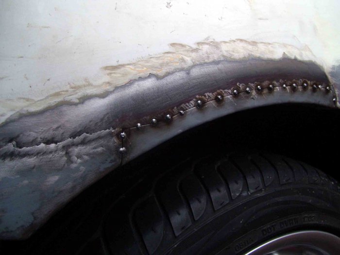

I will try and incorporate it for the next fabrication.
this would enable me to get something welded into place to build on.

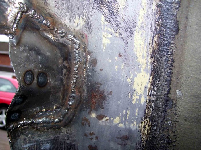

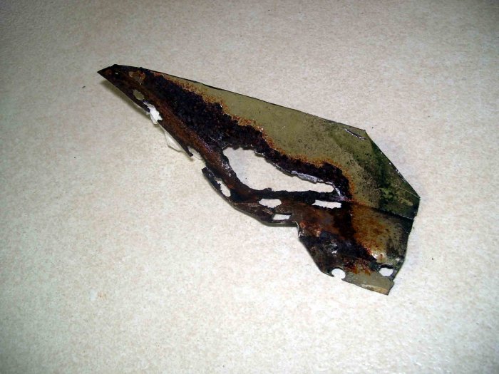

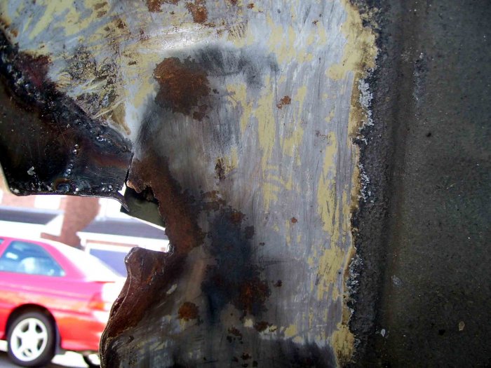

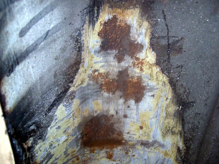

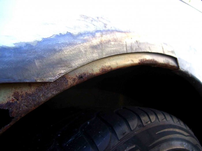

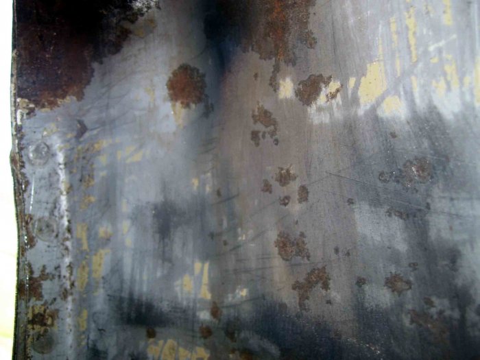

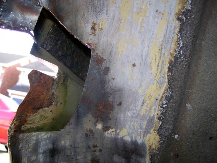

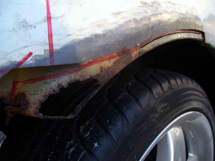

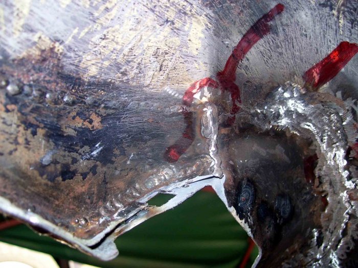

I will grind back most of the rust that appears treatable and cut out the remainder. The key point was corroded about half way through, so hopefully I will be able to salvage it. Looks like i have been lucky with the majority of the outer seam of the arch.

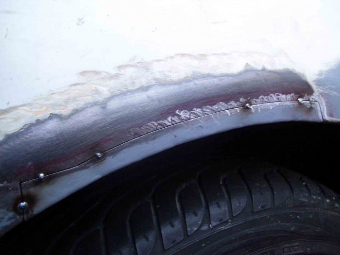

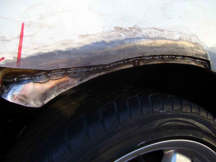

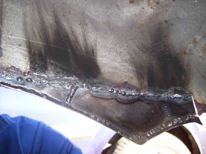

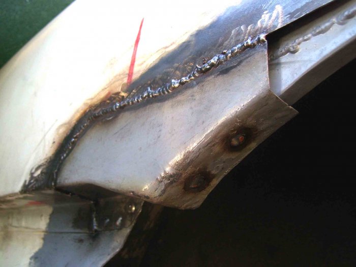

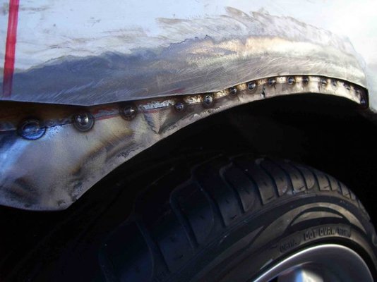

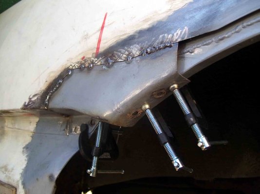

I think it was a combination of cramped conditions and a very strong wind.
I may be barking, but this appeared to make a significant difference to my finished welds.
