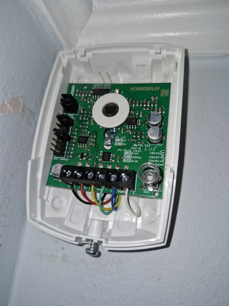

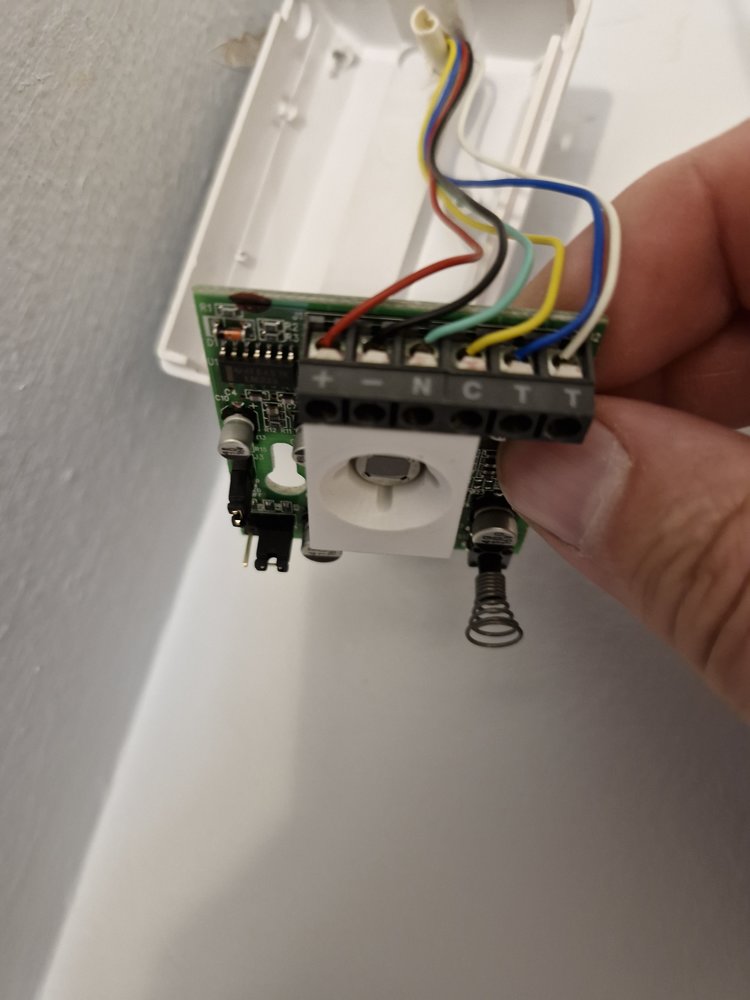

My query is relating to the tamper switch wiring on a Texecom or other alarm system.
My existing alarm which was pro installed 20 years ago had 6 core wires to each PIR. Inside the PIRs the blue and white wires were connected up. But at the control panel these blue and white wires were cut short and twisted together.
I wired up my new replacement Texecom PIRs to match the existing ones using the same blue and white wires.
Old:
New Texecom:

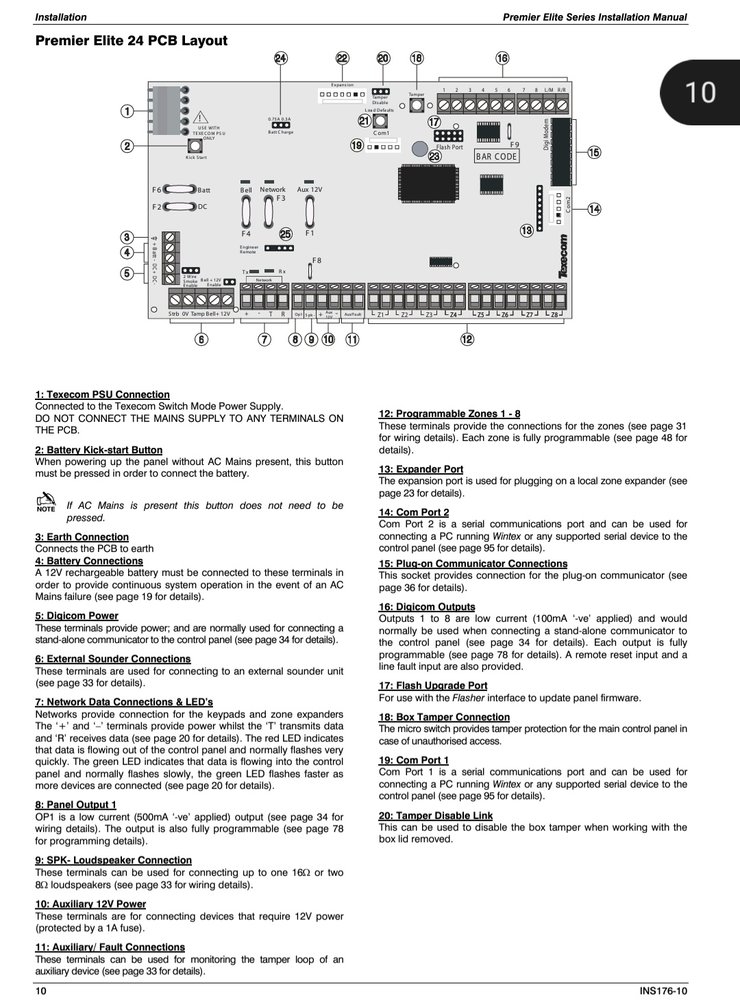

However my Texecom Premier Elite 24 panel also doesn't appear to have provision to connect the blue and white tamper wires!
Is it a case that I should leave these disconnected as only certain systems would support the tamper switch back to main panel?
Thinking about it anti tamper on a PIR in a residential installation is probably not required. Unlike a public buiding there should be no risk of access for someone disabling a sensor. And when armed they won't get to the sensor before the system is alarmed anyway.

who the hell on earth is even going to get in without setting the alarm off and cutting the wire
just link the tamper output at pannel
