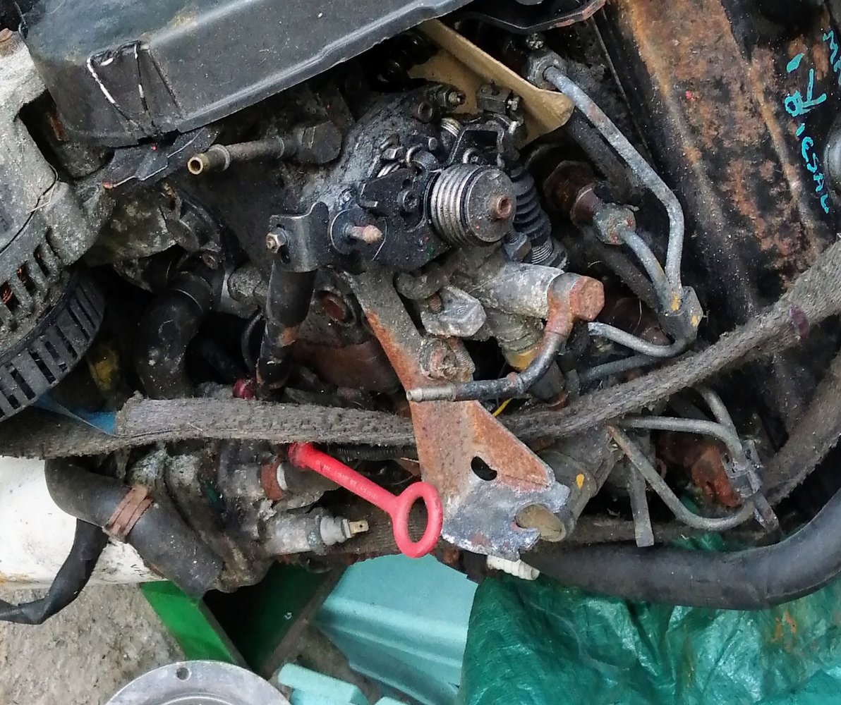

Standard fuel solenoid, you'll need to apply 12 volts, to get diesel, or as suggested, dismantle, remove rubber plug, and reassemble. 24 mm socket I believe.

I've got an old hand bleed bulb somewhere, would that be useful pushing fuel into the pump?Crack the injectors, 12 volts to solenoid, you'll need to bleed up the injection pump, crank it over, 5 or 6 seconds on starter motor, pause, repeat, when air free diesel pees out the injectors, tighten them.
You got a lift pump on the engine, no, probably an electrical pump.I've got an old hand bleed bulb somewhere, would that be useful pushing fuel into the pump?

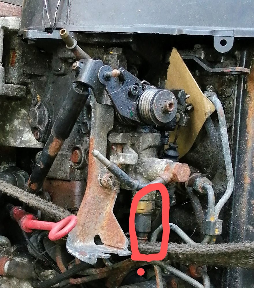

Pretty sure thats not the stop solenoid. No idea how to draw on the picture, but see the cast iron bit just above the dipstick handle? under the cable mounting. Is there a solenoid screwed into it on the top? maybe with a screw terminal?

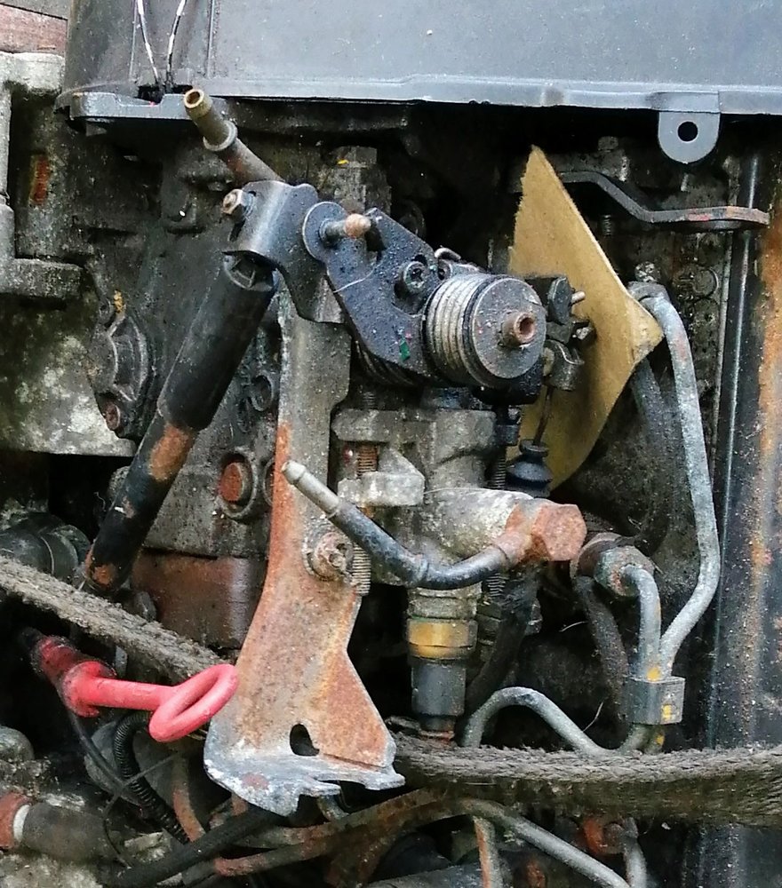

No, I think it's what is circled as it's just before the fuel inlet so on taking power off the plunger just pops in and plugs the fuel line there.Pretty sure thats not the stop solenoid. No idea how to draw on the picture, but see the cast iron bit just above the dipstick handle? under the cable mounting. Is there a solenoid screwed into it on the top? maybe with a screw terminal?
No, not sure what that is.
Yes my old 306 running the same pump had one as a primer. Just the jobI've got an old hand bleed bulb somewhere, would that be useful pushing fuel into the pump?
It's on top of that brown lump of cast iron just the the left of the dipstick (when the pic is round the correct way)
the thing with the electric spade end is an oil pressure switch on the oil cooler the rusty part on the right side end is where the four pipes leave the pump
