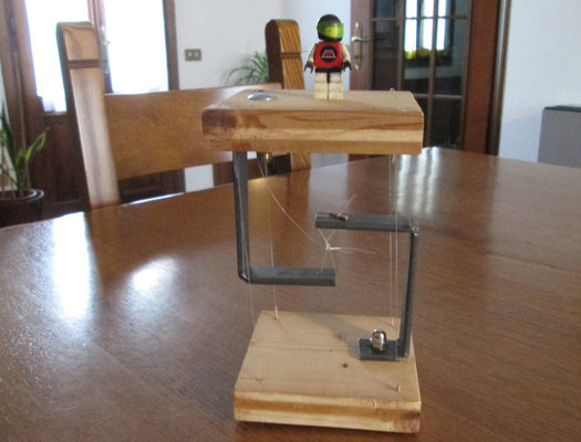

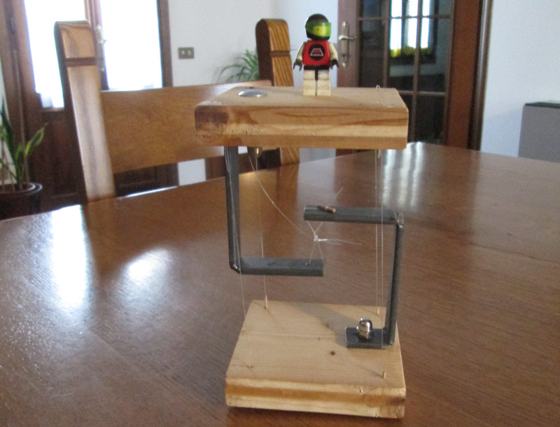

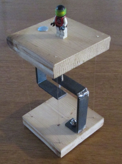

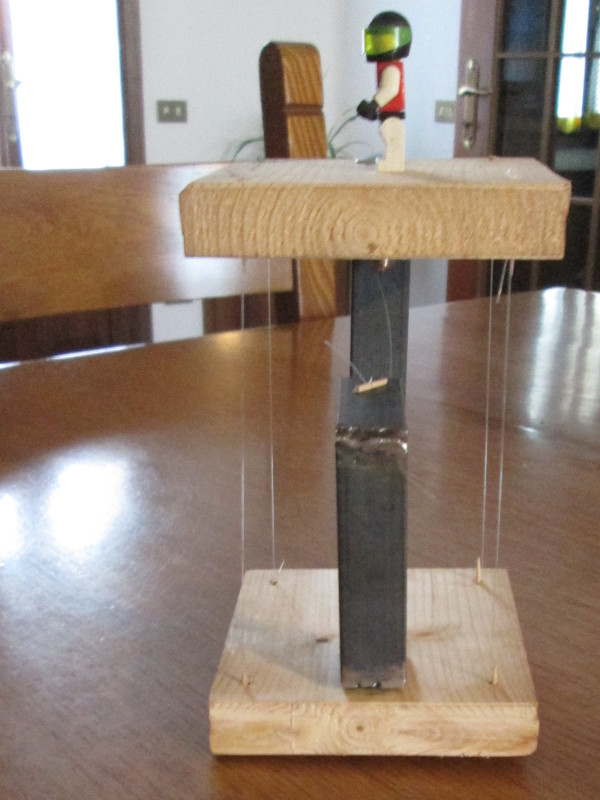

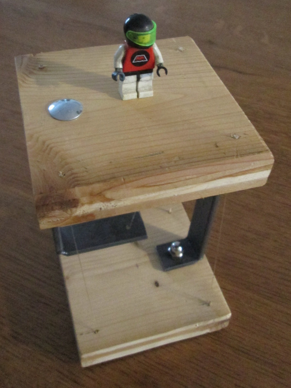

Sarto Small flower carts specialist Messages 478 Location Padova - Italy Nov 21, 2020 #1 Hi to all. Next you will see the (little) prototype for a simple tensegrity stool. Did any of you make one in the past? Are they really strong enough to support the weight of people? As usual, comments are wellcome (and I know, the welds are ugly!) Have a nice weekend. Sart0

MysterG Forum Supporter Messages 1,399 Location Wiltshire, UK Nov 21, 2020 #2 No reason not to be strong enough if you use the right materials. Which gives me an idea for the few meters of chain I removed from my 1ton hoist Be interested to see your progress.
