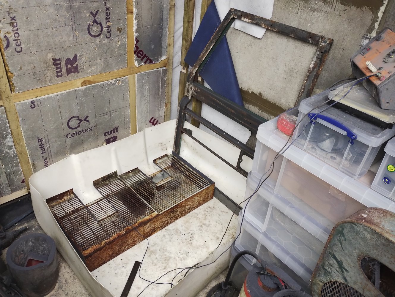

Trusty IBC tray. Normally used for tipping the cement mixer out into...
A friend has in mind that I'm doing something to his dive compressor belt guard (which would have fitted in the more usual 205l drum) but I'm going to try getting a defender door frame hot dipped and I don't trust the local plant to leave it in the acid long enough to clean the inside of the box section.
I'm hoping that caustic electrolyte will strip the paint but I don't hold out hope.
The plan is to do the defender fuel tank, the 101 fuel tank, and then get back the 1.2sq mtrs asap.
Psu is just 8 amp, but I never see anything like that with a clamp meter.
I've got a 20a 48v somewhere... I wonder what that would do?
