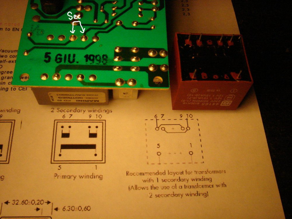

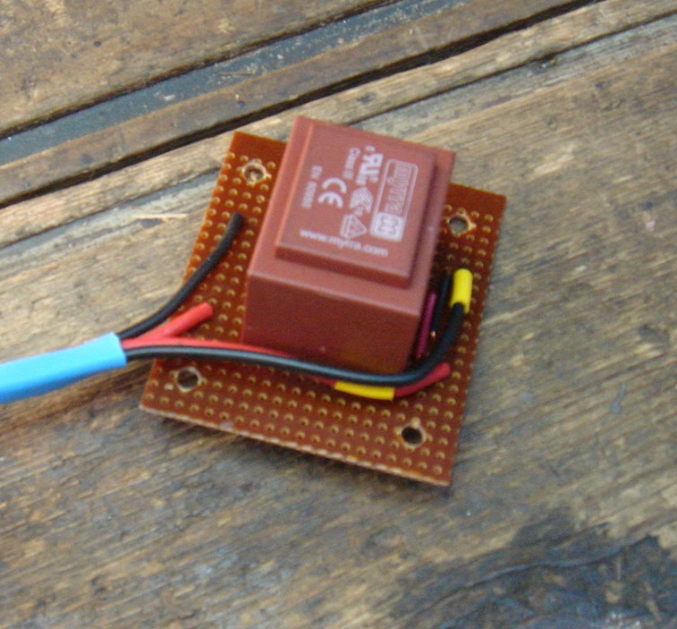

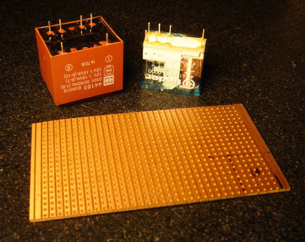

If it comes to it you may be better mounting the transformer off board and running 4 wires to it if the pin con fig is that different. Could even mount it upside down on the pcb if that allows the pins to work out ok. When shopping for the transformer go for a higher rating than original as they tend to be poorly rated for cost.
