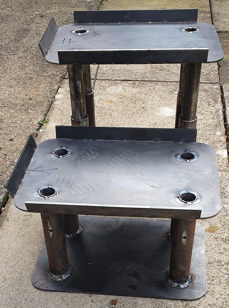

I have a problem with my (very low) car and need to get under to fix. About 12 months ago I had some parts laser cut from 4mm cold rolled steel and have now started to build these 'ramps'.
They are based on a youtube video ...a guy in the USA came up with the idea but never sold them over here. To use these, you jack up one side at a time and place under the wheel ...once both are under you then jack up under the ramp to get almost twice the height. There is an automatic locking mechanism (which I have yet to do) to lock them in place. I have made these to give me a total height of 360mm under the wheels....... I have also made them to attach to my home made (very low entry) ramps swo I onle need to jack up once. I'll post more pics when I'm using them. Excuse the rusty tubes ...it's only surface and I'll clean before I paint!!
I've sent for some 8mm steel bar for the locking pins so will finish these then and give them a coat of paint.....watch this space!
Not sure if allowed ...but I had 4 sets each of the 4 parts laser cut to make the price reasonable ...so three sets available if anyone interested ...pm me if so.
