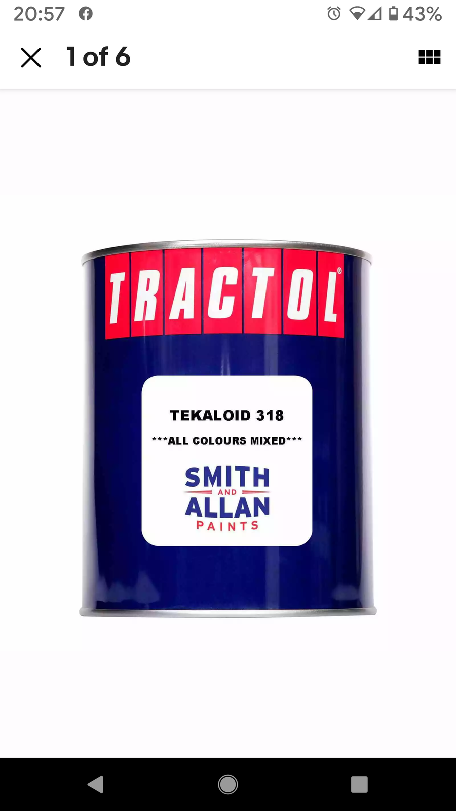

  7. eLuSiVeMiTe
    eLuSiVeMiTe Member
    Messages:
    10,857
    Location:
    Bedfordshire England
    This stuff for top coat on my machines.
    jimbo84 likes this.

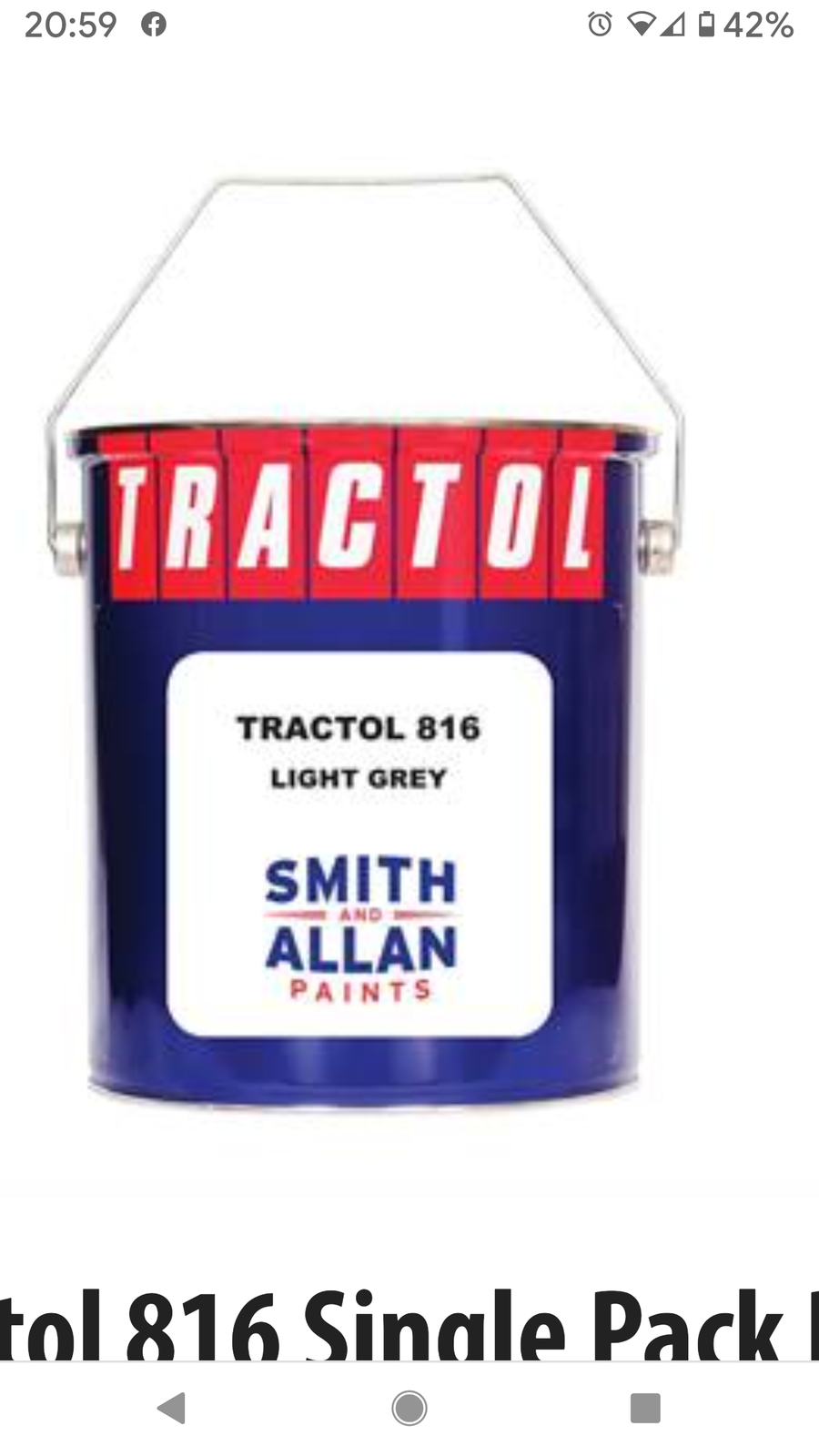

  8. eLuSiVeMiTe
    eLuSiVeMiTe Member
    Messages:
    10,857
    Location:
    And this as a primer

  9. jimbo84 Member
    Messages:
    983
    Location:
    Up North
    cheers fellas so it seems Tekaloid might give a more refined finish than tractol then.
