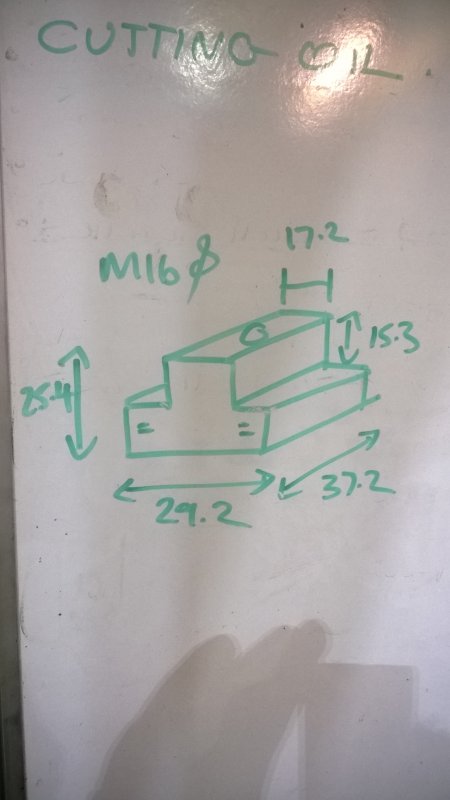

I need to get hold of some more tee slot nuts for our radial arm hole-chewer. Sizes below are in MM. (May well be imperial??)
No facilities to make them ourselves
