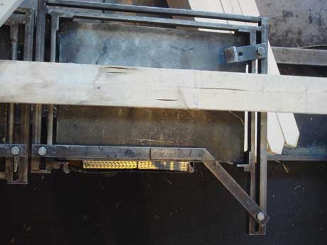

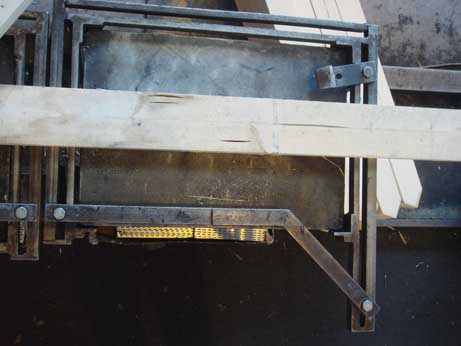

They're to fit between the underside of the two rails which are 15mm apart to allow something to be fixed on top with an M10 bolt without the operator having to use more than one tool .
What about, a coach bolt from the back, (pointing to the camera) and a nut on the front. the square section on the coach bolt will locate into the slot.....
and still only a spanner on the one side required.
If it was for myself, that's the way I'd do it but it's for someone else and they're using t-nuts now and want some more. As they're a non-standard size I said I'd see if I could get some made.
