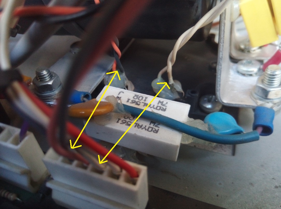

I think that are probably connected using small faston connectorsA longer test waiting for it to stabilise would be a pain with the hand torch as it seems to be about 15 or 20 minutes of cutting before it stops dropping.
Yes, that is the next step when I get a chance, I have a new tube of thermal paste waiting
It will be a bit of a pain due to the way everything has been constructed but hopefully I can manage without having to separate too much.

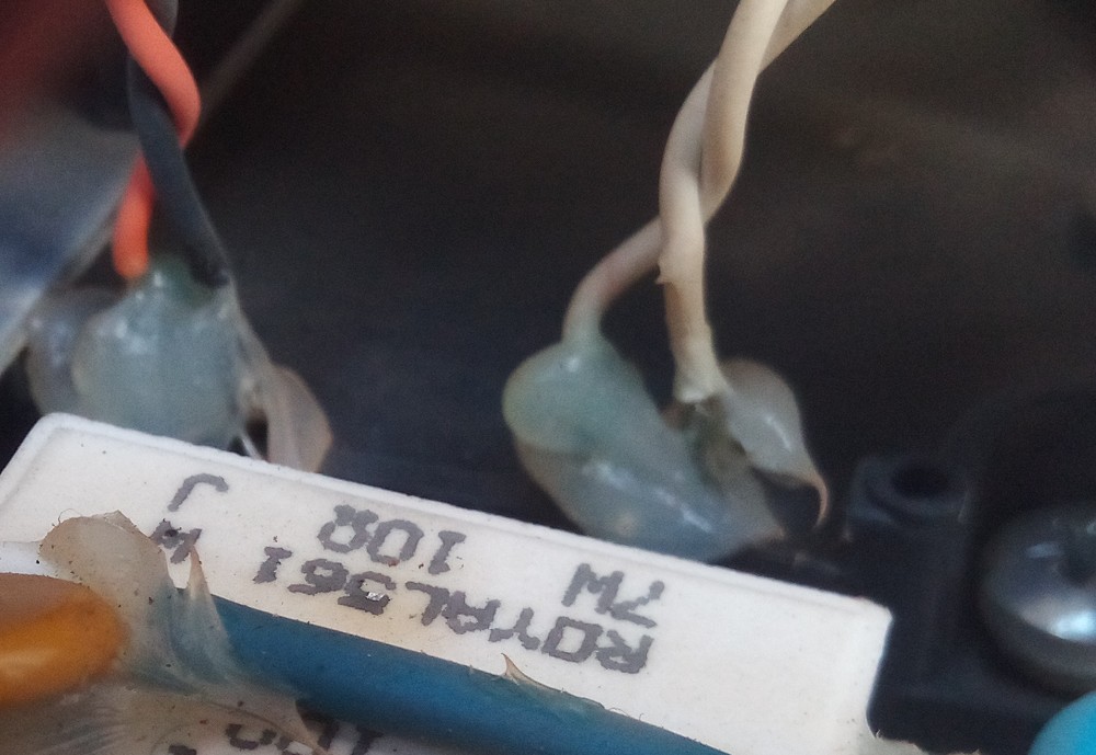

I am also going to have a look at the connection of the wires under the silicon/glue as potentially it could be a dry joint or even a fractured wire there that is heating and increasing the resistance.
