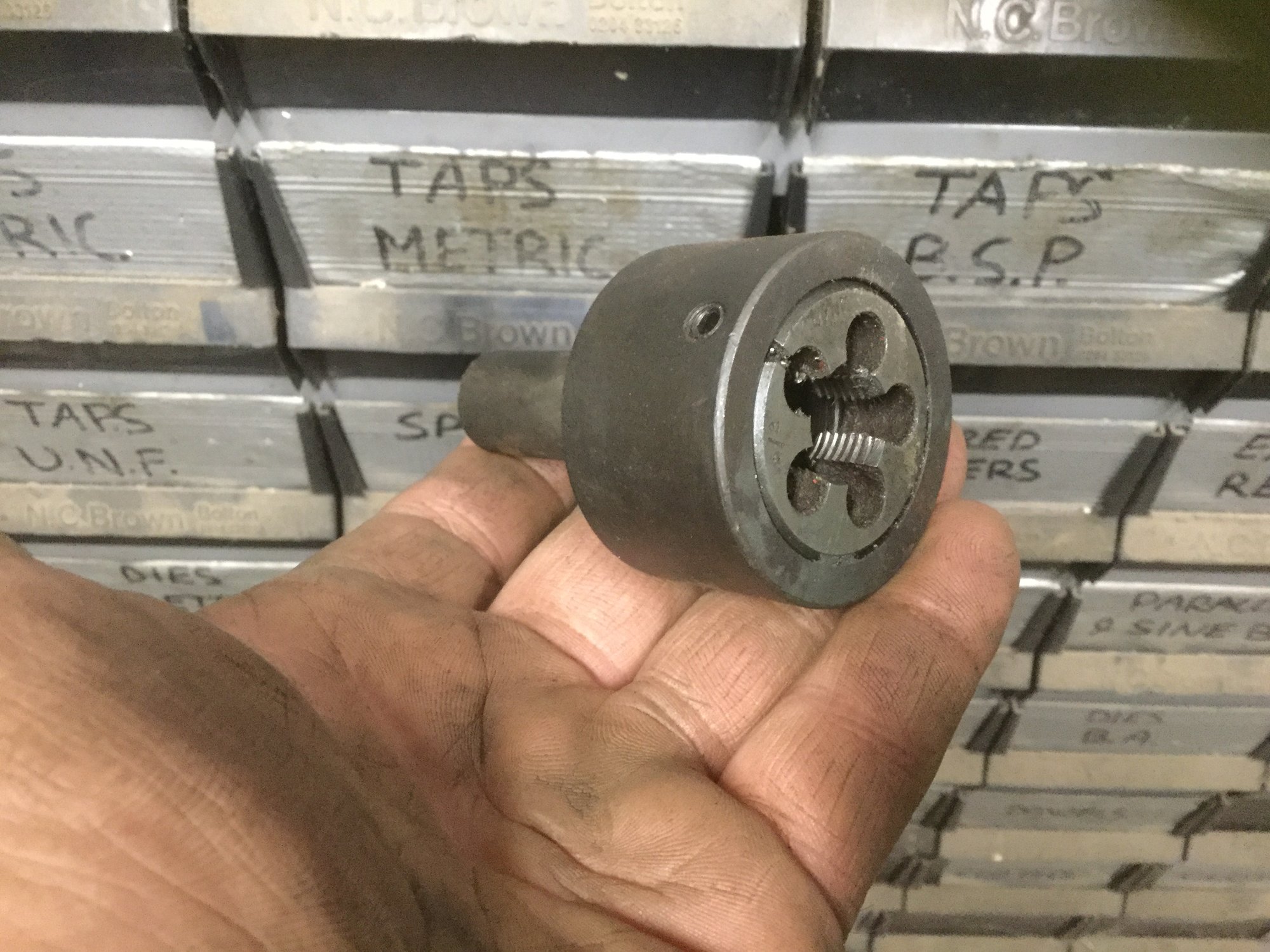

I have done if the thread does not need any great degree of accuracy, the reason for starting in the pillar drill is to get the thread square.
