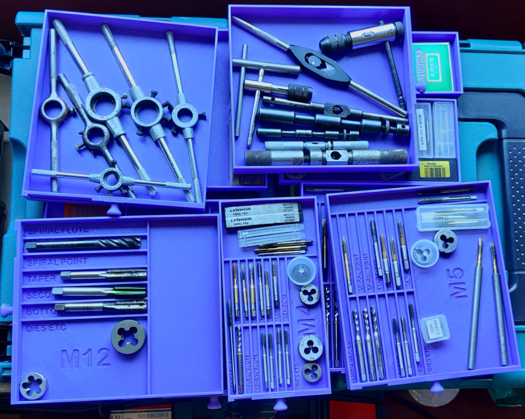

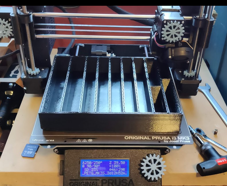

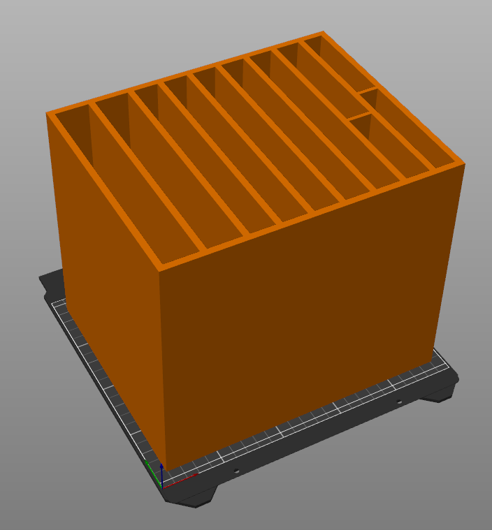

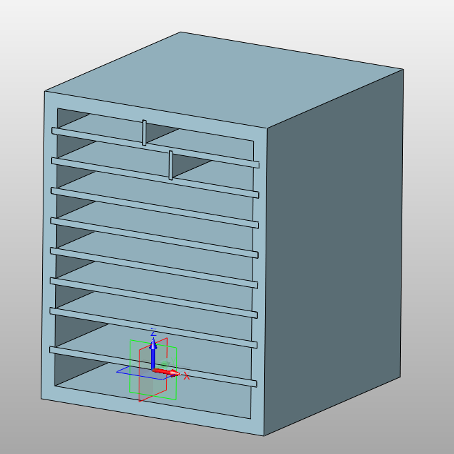

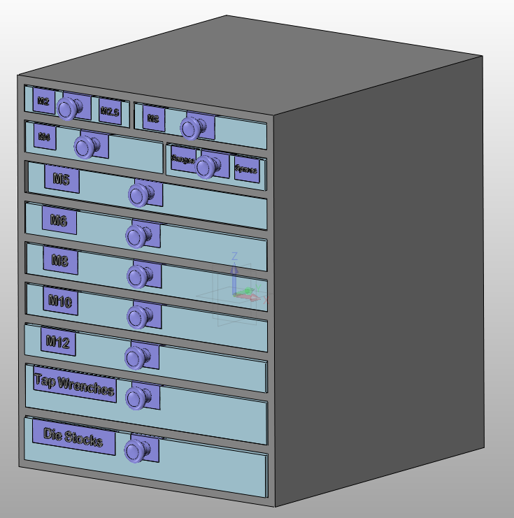

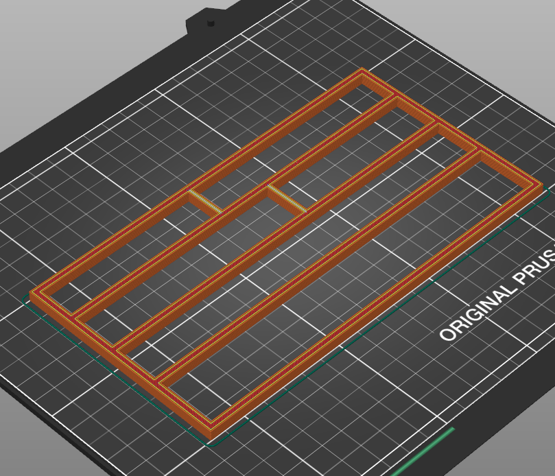

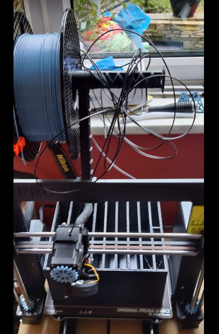

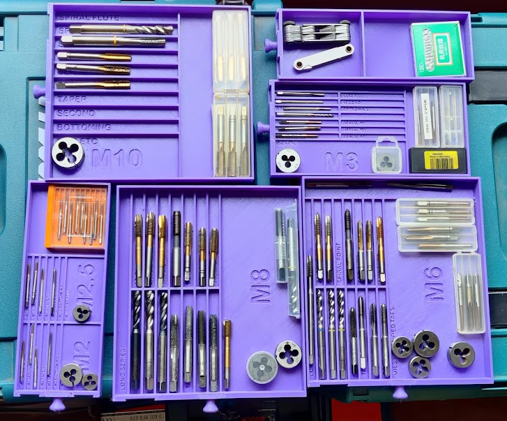

In for a penny, in for a pound... I've decided to add two more drawers at the bottom for some of the smaller tap wrenches and die stocks. I also split the "Gauges" drawer in two so now it's Gauges & Spares. Finally I increased the clearance around the drawers from 0.5 mm to 1 mm. I'll probably stick some UHMW-PE tape on the bottom corners of the drawers to make them slide nicely and the extra clearance will give a bit of space for that and give me more confidence that the drawer unit print won't have been 5 wasted days!

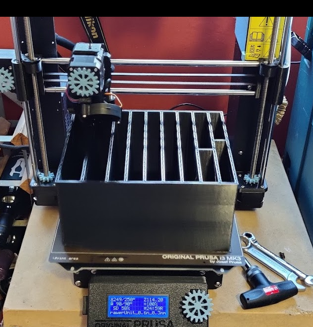

The frame still (just) fits on the bed of the printer...

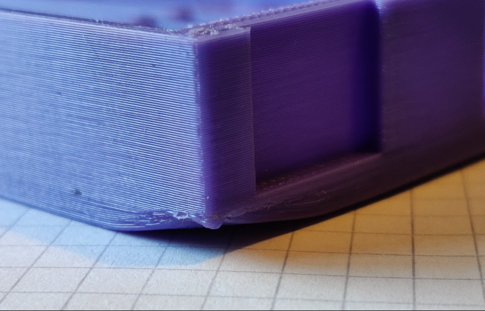

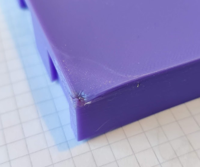

. The really annoying thing is that the M4 drawer is the one that I printed twice after one corner didn't stick to the bed properly and I had a tiny chamfer on the bottom corner. I reprinted it because I knew it would annoy me, but I didn't have the sense to check the taps fitted first
