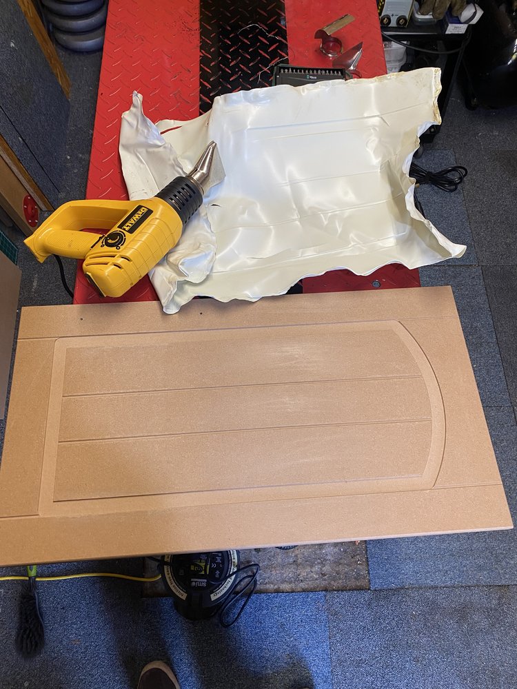

I'm guessing you got that off with plenty of heat, has it left any sticky gunk behind or did it come off clean and leave a good surface?1 down 22 to go, tig gloves required
Yes, a fair bit of heat, but carefully, the knack on these is to get all 4 edges fully curled up before working down the fronts. Sounds obvious but it's not even splitting like that. Just done another 3, working out approx 20mins a pop.I'm guessing you got that off with plenty of heat, has it left any sticky gunk behind or did it come off clean and leave a good surface?
zinnser primer for the raw mdf ive painted a few bespoke kitchens with dulux diamond egg looks great it almost impossible to markAs I'm looking on line for replacements, Confucius she says,,, just try one that is really stuck down with no damage and see if you can get that off - shot to nothing ain't it...
Spot on! she is using zinnser primer sealer, it is really good stuff.zinnser primer for the raw mdf ive painted a few bespoke kitchens with dulux diamond egg looks great it almost impossible to mark
