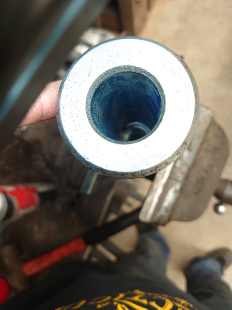

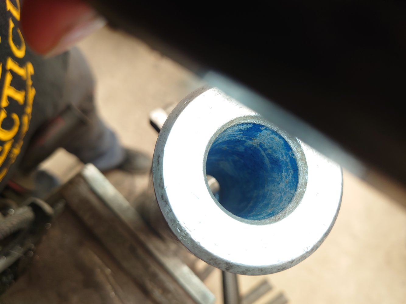

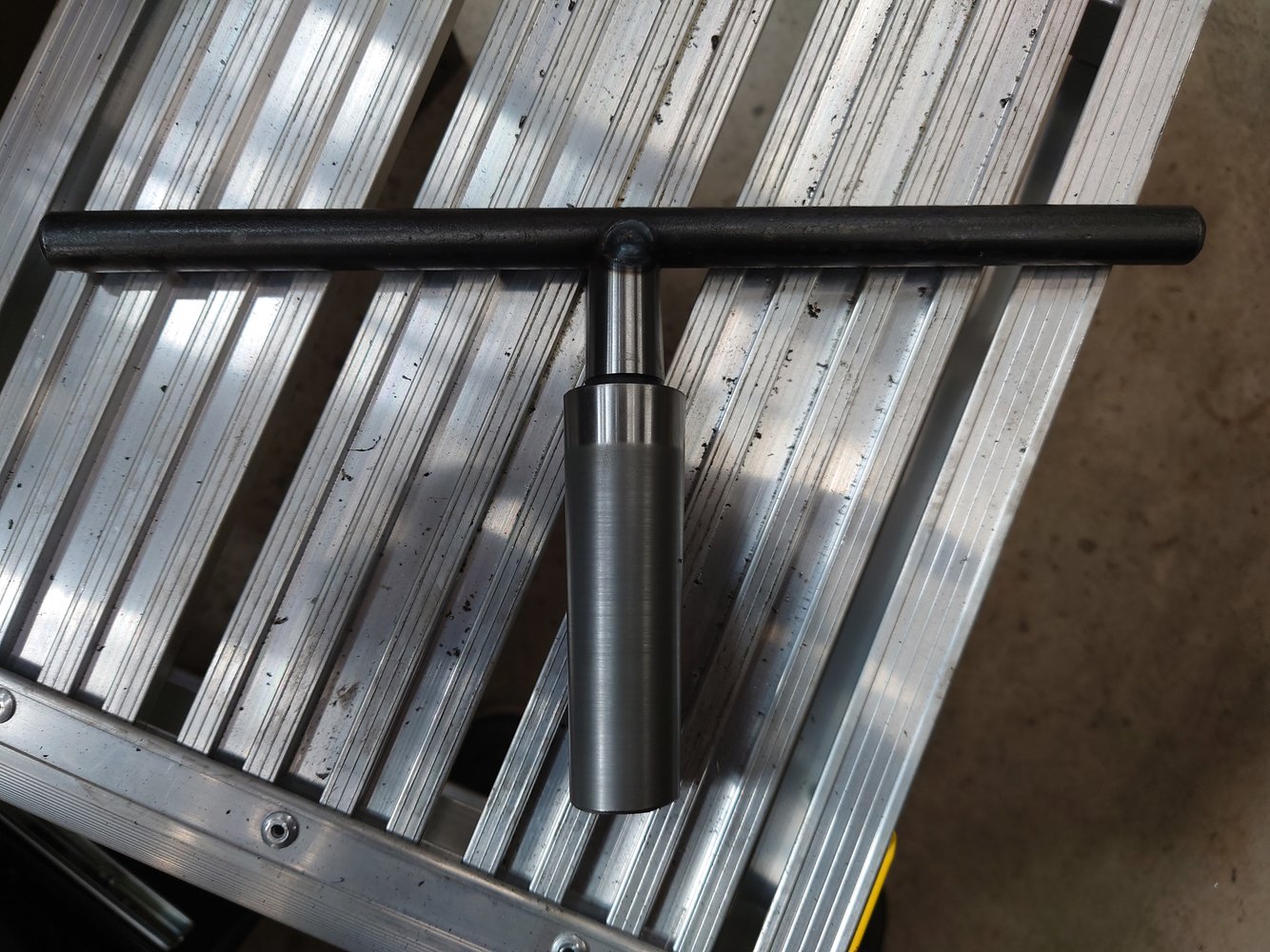

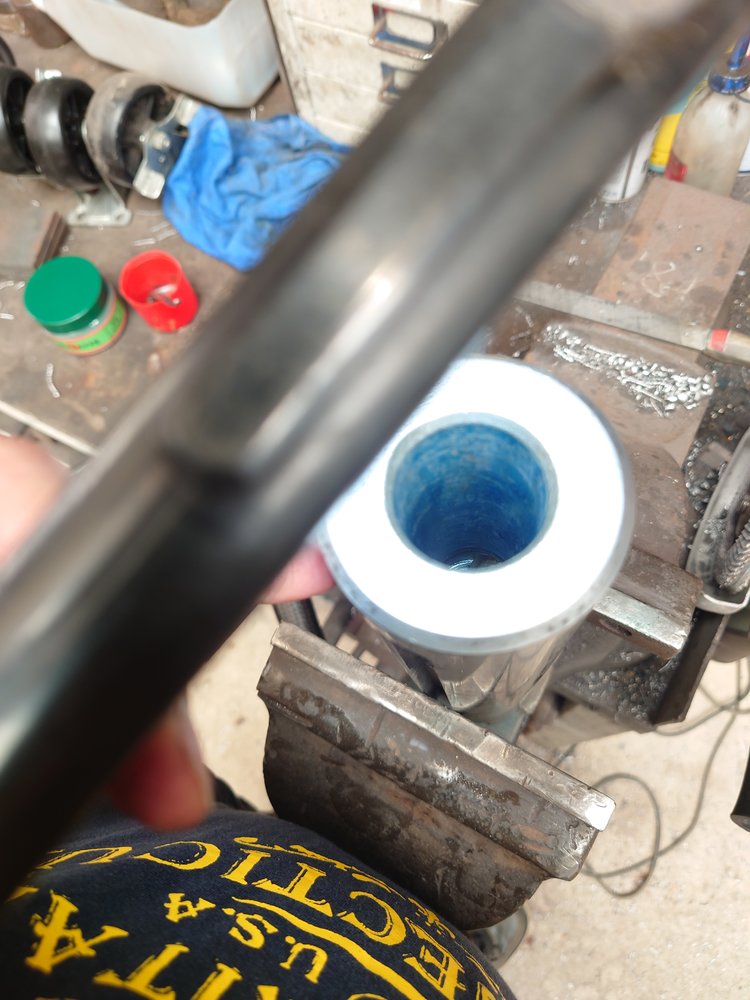

What lapping paste did you use in the end?Here's the tool I made, cut the tang off a new MT4 Arbor and tacked on a bar. You can see from the grey area it's pretty uniform.
