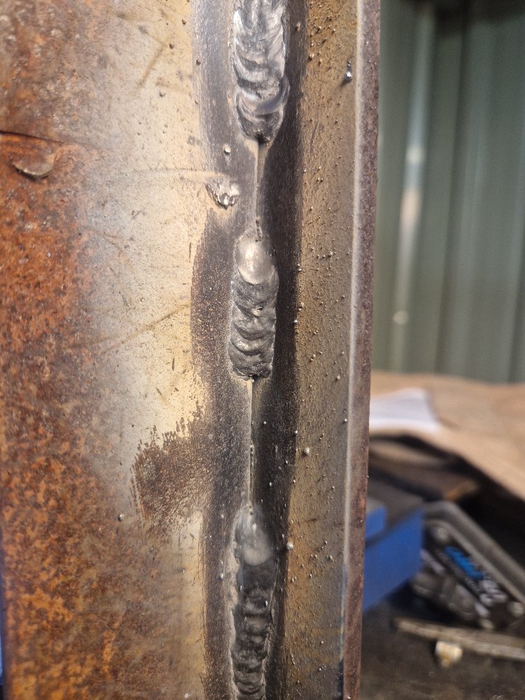

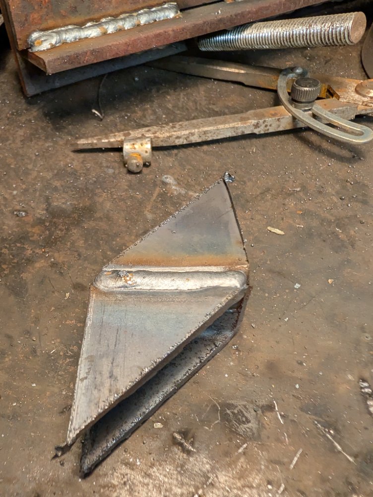

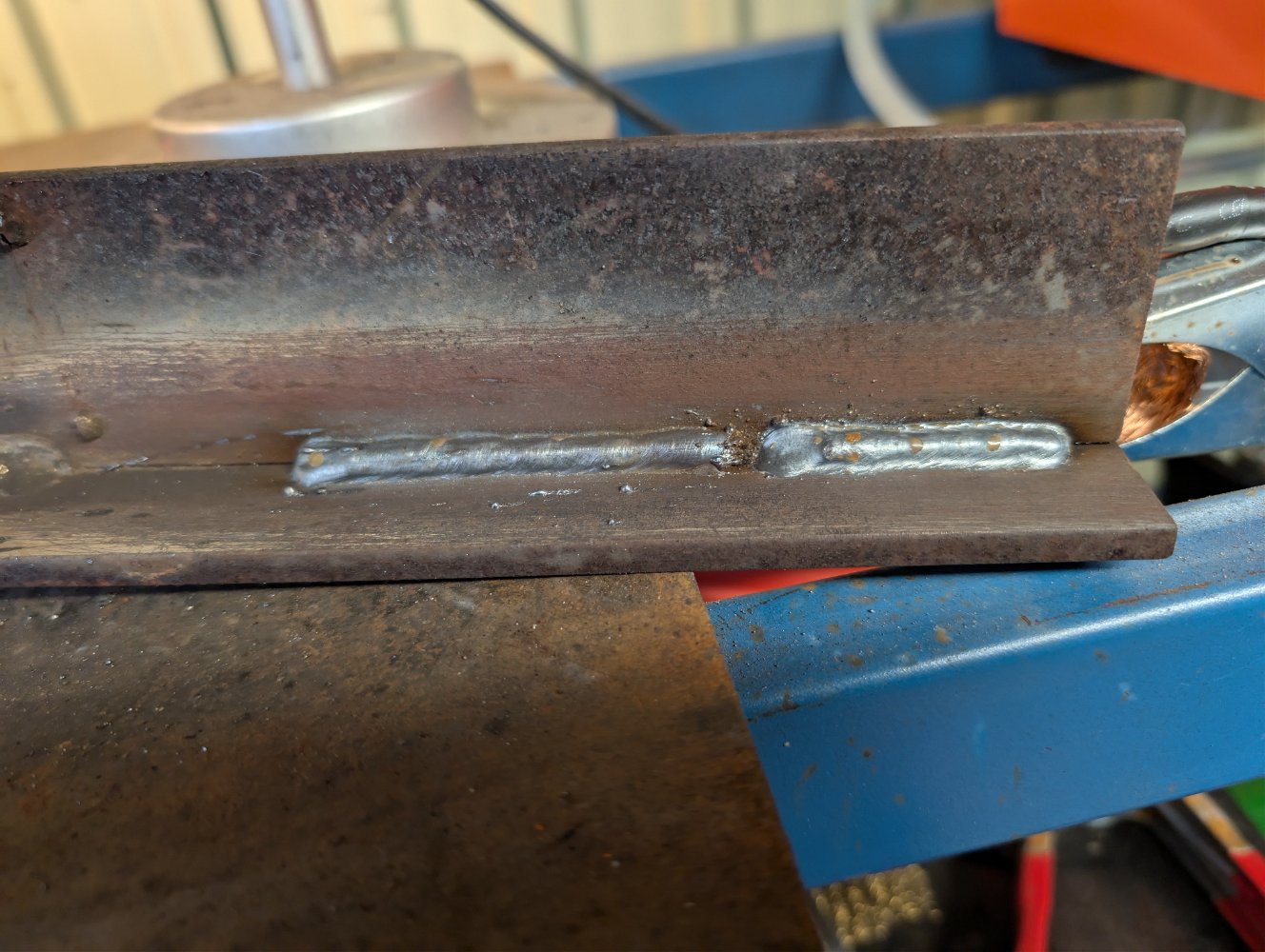

Just for fun, 250amp uphil with a very slight weave. Torch was getting hot at this point so only short runs

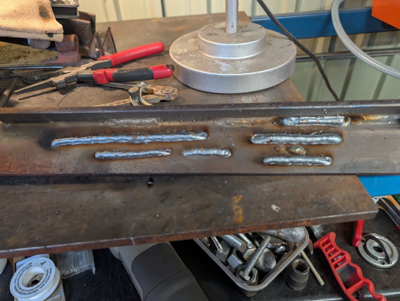

yes...not sure why though as a few of them were set flat out 250 (claimed) amps and full voltage!they are classic caterpillar welds ,,, sort of Saturday Night welding ,,

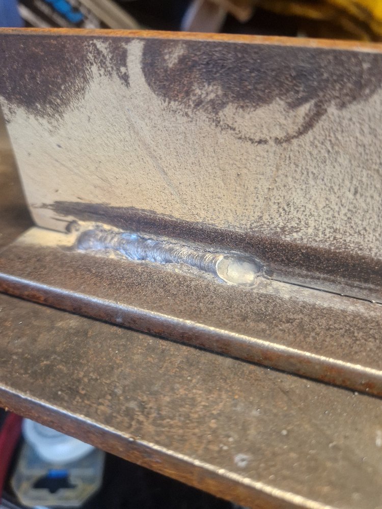

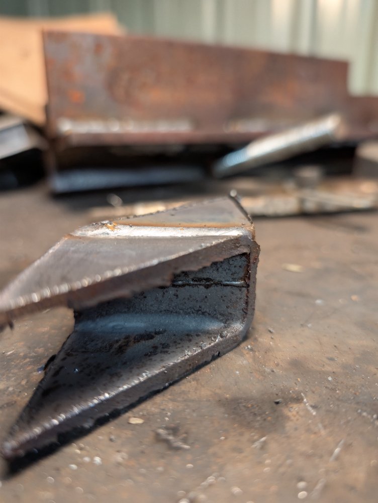

heaped up on top , but no penetration
(I also turned my mask shade down as that was still on 12 from stick welding the other day...surprising how much difference it makes, being able to see)Don't have a clamp meter otherwise I would.Could you put a clamp meter on the earth lead, set the welder to max amps and see if it does produce the full 250 amps? I suspect sometimes Chinese amps are not quite the same as ours. It doesn't really matter if it produces enough for what you want it for, but would be interesting to know.
