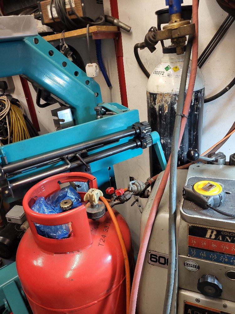

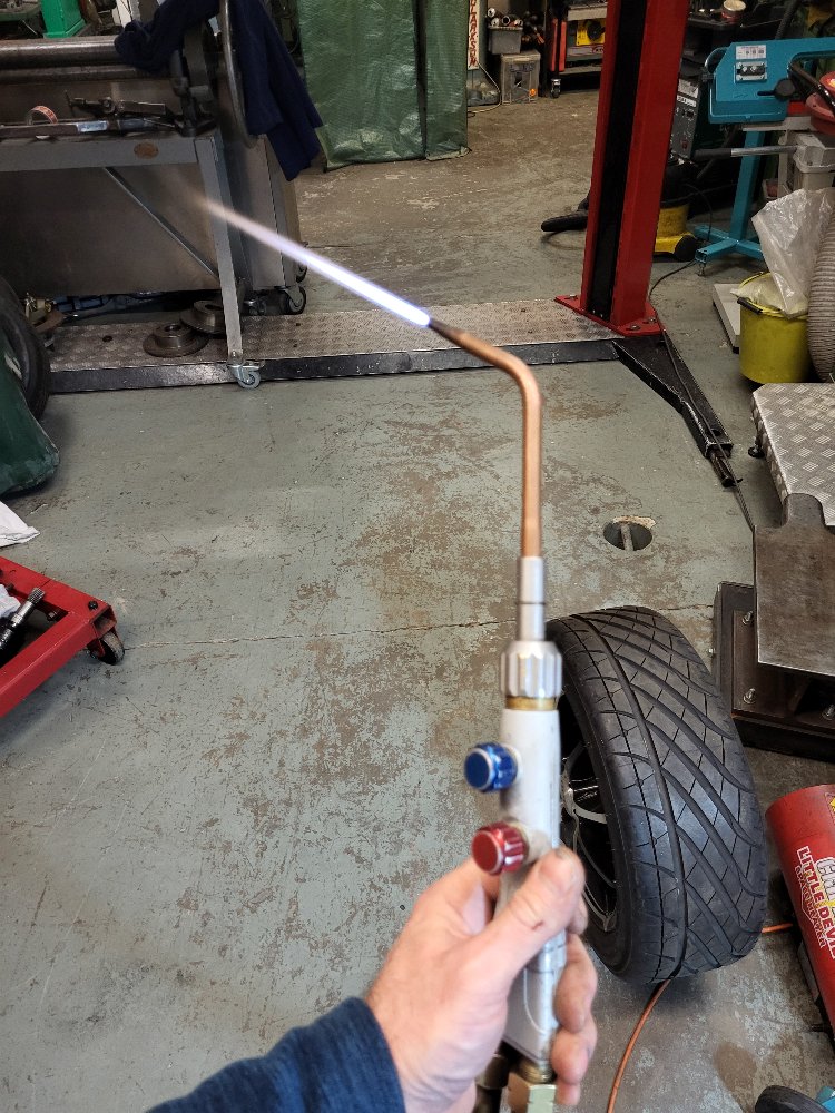

You can't weld with oxy propane bur you can do everything else. I use all my oxy acetylene gear and just use an adjustable propane reg. I use a BOC saffire torch with the acetylene tips and they light just fine and are very controllable.

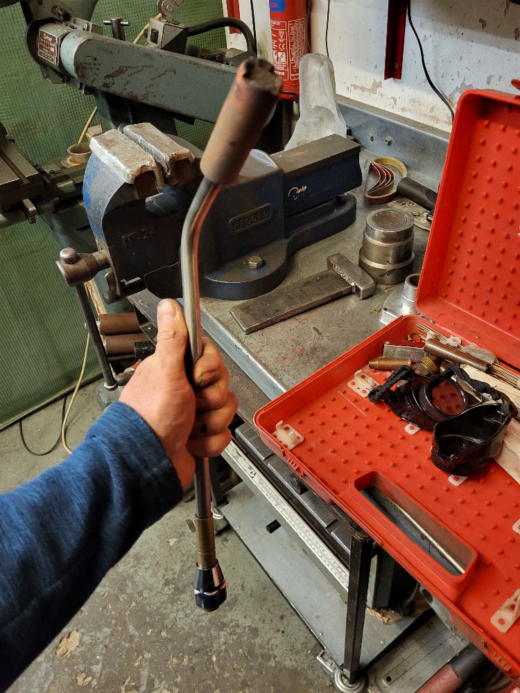

I also have some rose bud tips on an extension for some serious heat on big stuff.

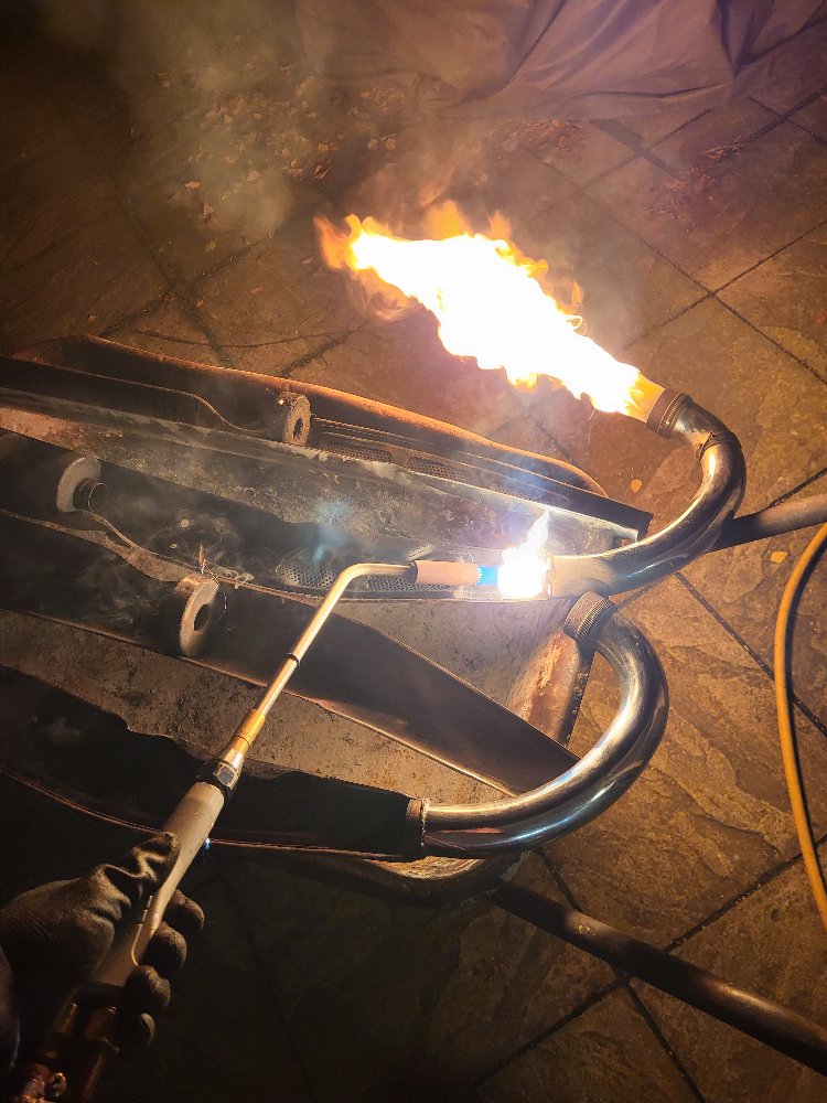

This is running on oxy propane
View attachment 522490View attachment 522491
Those rosebud heating tips are a serious bit of kit! That looks like a 4H or 5H.
I have a 3H and the roar of the flame on full chat is scary. I think I have a 5H too but it is a different fitting to my swan neck.
