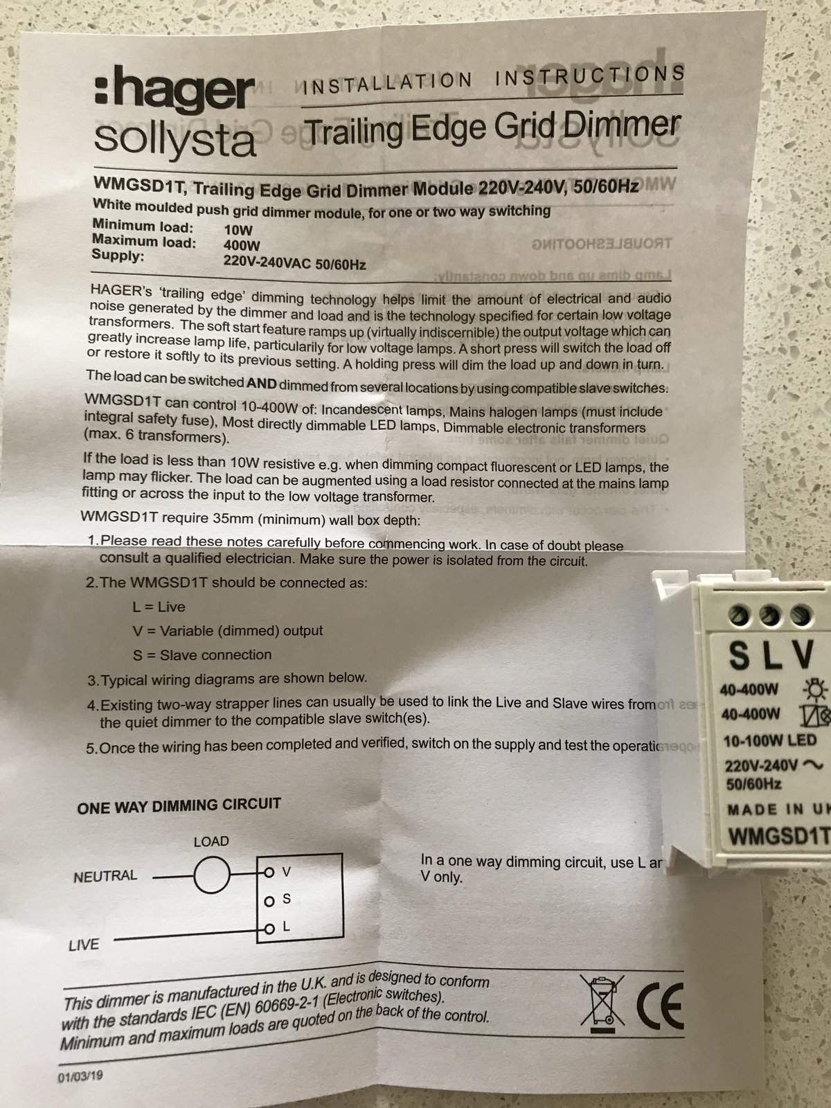

ther 2 lives together that was common in to L the single switched wire that was live one in to V on new switch . the neutrals just kept together separate in connector block . how much did u end up spending on the switch![]()
Thanks.
£84![]()
they told me 82 theres a 10 year guarantee on them though I think so don't loose your bill . id be well choked if it jacked in after a few years and I couldn't find the bill
to operate on 2 way u need a slave dimmer for the other end instead of just a 2 way switch
here explains
