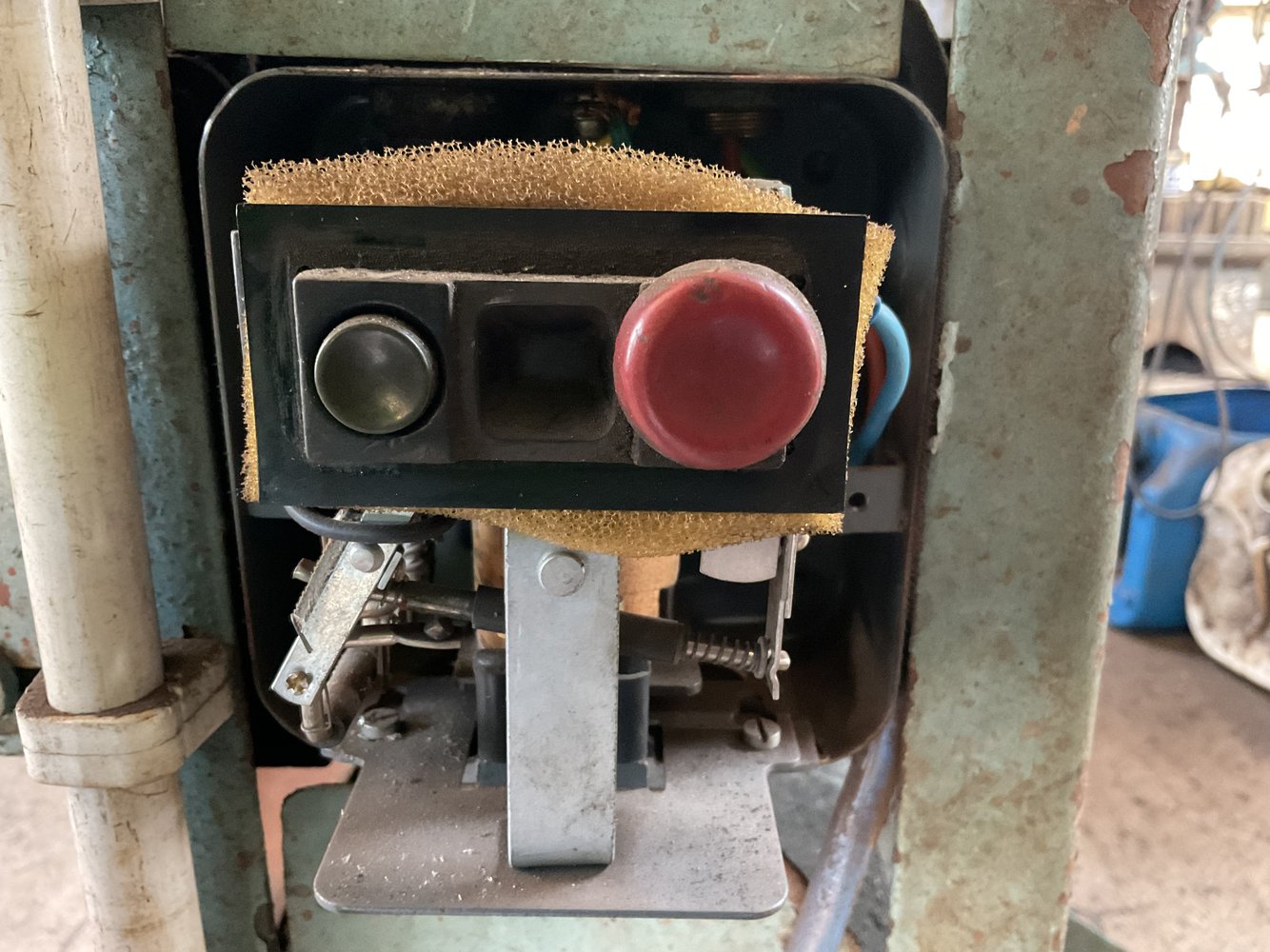

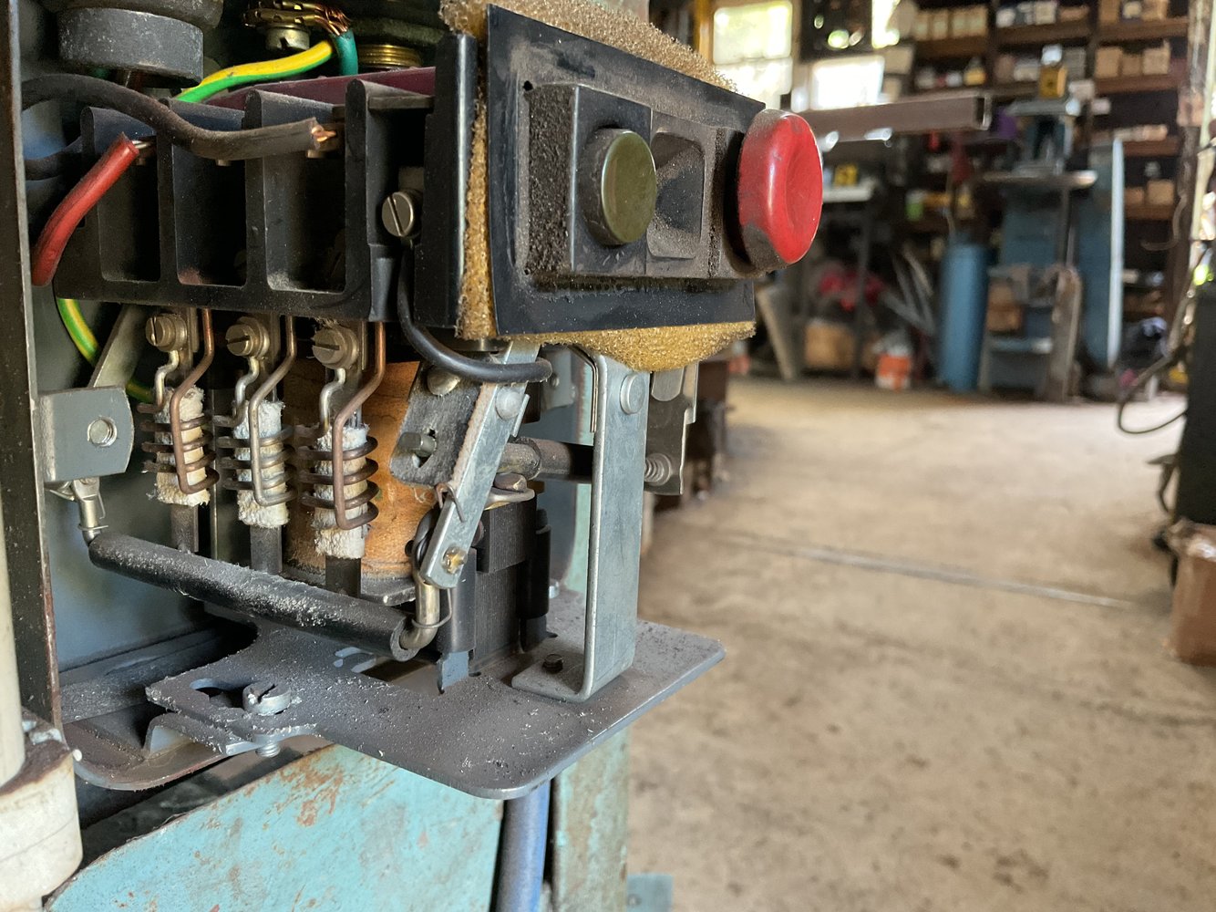

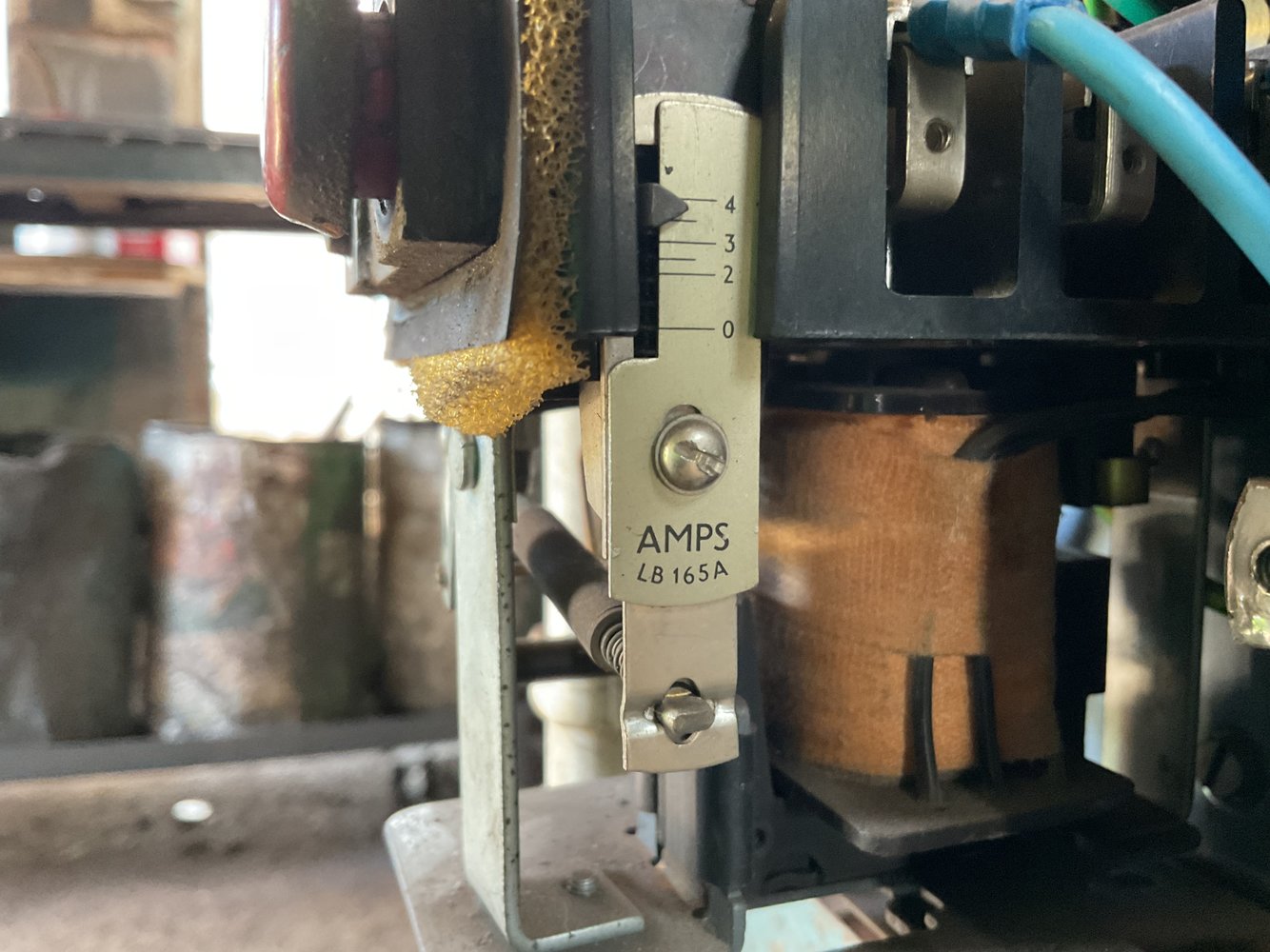

best using a clamp meter to test the amperage of the motor it could be either motor or the trip coils faultyDefinitely not a good idea looking at the internals of that gear.and blew the dust out
there fetching a fortune honestly if there in working orderBin the contactor it's ancient.
The coil is loosing its holding powerSingle phase. It doesn’t stop with the drive belt removed,could it be vibration,the linisher belt is cantilevered several inches outboard of the drive belt pulley,although I’ve used this almost daily for 21 years.
