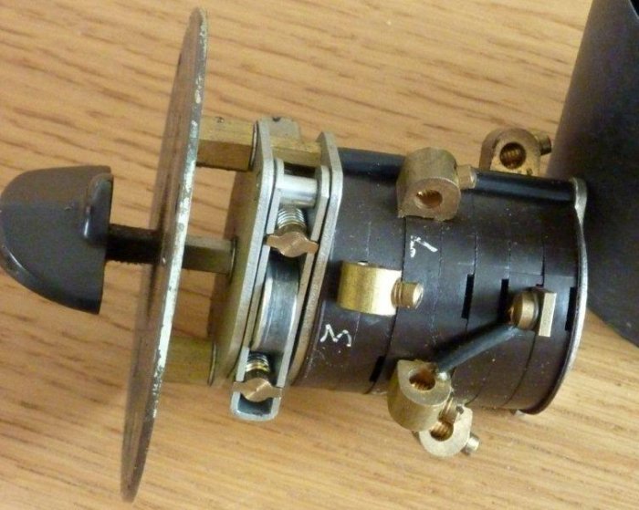

J jordan1 Member Messages 2,049 Location Yorkshire England Mar 23, 2012 #1 Hi, can anyone tell me if this forward/reverse switch from a three phase machine will be ok for my single phase drill. Thanks switch.jpg 69.9 KB · Views: 257

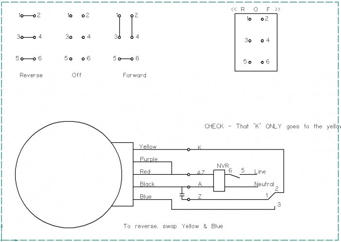

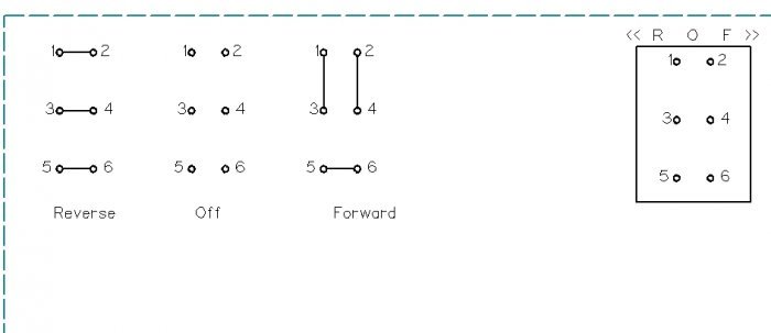

rtbcomp Moderator Messages 18,575 Location Sheffield UK Mar 23, 2012 #2 Depends on the motor on your drill, if it's reversible and what connections are required to reverse it. Can you identify the switch make and part number? If so a Google may find the connection diagram for it, If not you will have to draw a connection table for each position of the switch, this is one I did for mine: Once you have the switch and motor connections you can then look for a way to connect them both up!

Luke Forum Supporter Messages 1,929 Location Whitchurch, Shropshire Mar 23, 2012 #3 In short, it probably wont work. You would need to be able to get at the motor windings for it to have any chance of being reversable.

A awemawson Forum Supporter Messages 4,666 Location East Sussex, UK Mar 23, 2012 #4 Depends on the motor - if the run winding and the start winding both are presented in the connection box, it is only a question of interchanging the start and finish of one of them for it to run in the opposite direction.

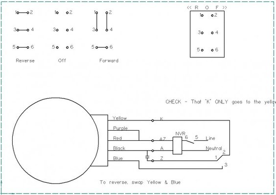

rtbcomp Moderator Messages 18,575 Location Sheffield UK Mar 23, 2012 #5 I have a reversible motor on my drill, the proposed setup will be
