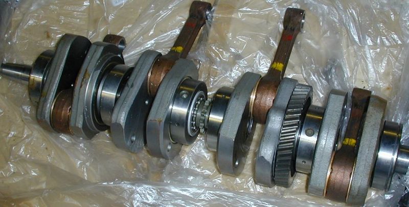

i used to get my gears undercut...
No matter how much the bearings are that's not going to take much thinking about.
