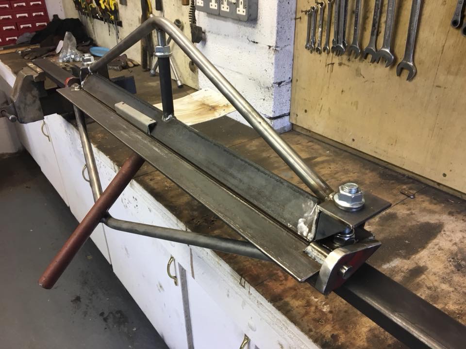

I was thinking ideally one each end.Are these going to be spaced along the length ?
What sort of width and thickness do you plan bending?I was thinking ideally one each end.
Thanks, but the whole idea is that I make one myself just for fun. Thanks anyway though.What sort of width and thickness do you plan bending?
I have a small home made bender, about 24” wide, laying in my shed.
12mm x 80mm Weld-On Hinge (IBFM 400080) - F H Brundle
12mm x 80mm Weld-On Hinge. Buy gate hardware online at F.H. Brundle. Free delivery on orders over £150.www.fhbrundle.co.uk
Length of bending ?I was thinking ideally one each end.
You can’t really have hinges along the length, as they’d have to sit on the centreline of the fold, which is where whatever you’re bending needs to be.Are these going to be spaced along the length ?
You cannot ?You can’t really have hinges along the length, as they’d have to sit on the centreline of the fold, which is where whatever you’re bending needs to be.
have a look for the original magna bend ,,, theres an article online about it , and theres a 3d model of the hinges , they are a work of art on their own , well worth a look , I might have the link stillYou cannot ?

Never seen one, and can’t see how the hinges work on the pics.You cannot ?
Magnabend Centreless Hinge - Fuzhou Jdc Equipment Co., Ltd.
MAGNABEND CENTRELESS HINGE Following many requests I am now adding detailed drawings of the Magnabend centreless hinges to this website. Please note however that these hinges are too difficult to make for a one-off machine.. The main parts of the hinge require accurate casting (for example by the...www.panbrake.com
not the article I was looking for , but you will get the idea the google search one gets you the video ,,, the article I was looking for was written by the inventor and had a lot of details in it , even down to a diy instruction sheet ,,,
Yes, I have followed it since it's inception.have a look for the original magna bend ,,, theres an article online about it , and theres a 3d model of the hinges , they are a work of art on their own , well worth a look , I might have the link still
