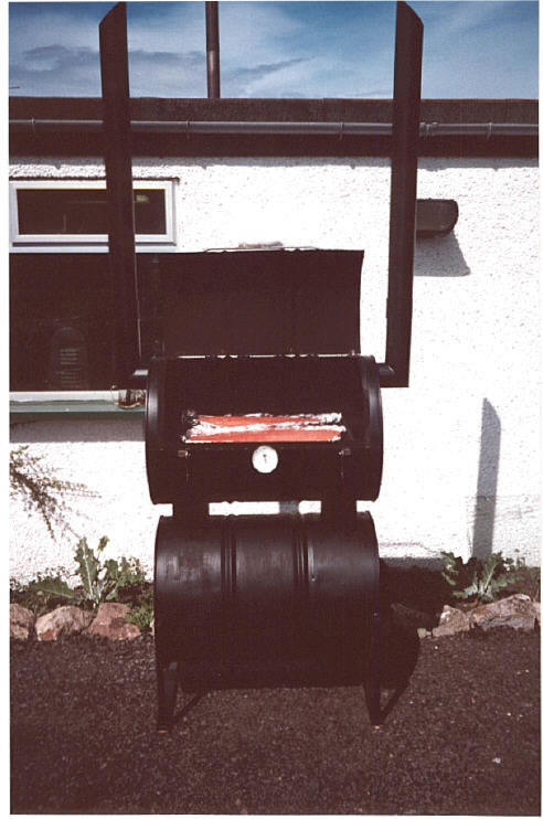

Time to get the barby out if you are like me you get too involved with socialising (drink) and burn everything why not try smoking no not the weed a smoker.
Made from two 45 gallon drums the fire box is located in the bottom and is connected with two flues into the cooking compartment a quarter section is cut out on the top barrel to form a lid and a mesh inserted half way accross to form a cooking platform you cook with the energy that is in the smoke.
You must use hard wood pictured is a twenty pound salmon, I have found out through several attempts that it is better to brine first before smoking as it takes in more flavour.
The salmon was then basted with brown sugar and Rum all you have to do is keep an eye on the temp. guage and socialise thats how it should be.
