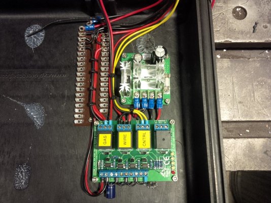

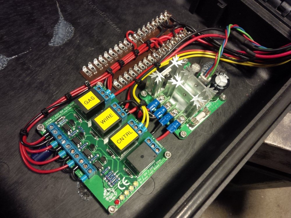

you can see it soldered onto the back of the relay board in the above picture. The wire relay is setup so it brakes the motor by shorting the motor wires together as soon as it is de-energised, couple this with a 4.7u cap across the control relay, should see me get a rudimentary burn back control set up. I need to have a hunt for a 4.7u cap at work...Lovely Job Hugh, really well done mateControl wiring done... needs a protective cover and a plate making for the front telling the user what each switch does and it is finished.
