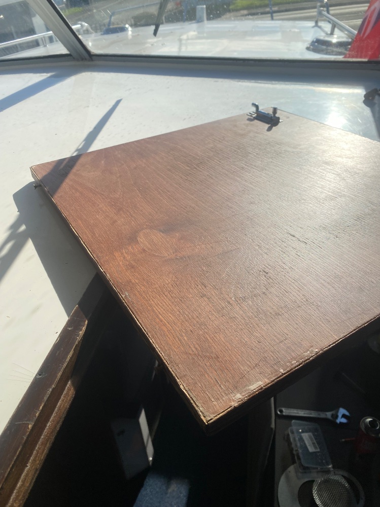

Any real wood in that size and location is going to move. Something impregnated with resin would be best
That's what I would do if the original just wants refinishing.I think that I may be best using a temporary board and refurbishing the original.
but seal the edges or it will peel and bubble .phenolic ply
It won't change shape with moisture content.
Solid laminate work tops perhapswhat about that plastic granite they use for posh worktops ,,, corinthian or something like that ,,, its tough stuff ,, and will be water proof etc
What size are you after ?
This is also my experience...when I did some digging I think the main marine ply stamp is a voluntary code!Good quality marine ply is now available from very few sources
I probably have a piece of Baltic Birch Plywood that size you could have. Birch plywood has about 12 layers and they look much prettier than normal plywood. They do need a really good sealer though as left damp they can stain.500x480x18mm
No Teak and Iroko are two separate species of timber. Iroko is less oily than Teak but equally good for external use if well maintained. Used a lot for hardwood window frames.I thought Teak was just another name for Iroko?
Looking at your existing hatch cover, I would be inclined to reduce the dimensions by an inch on width and depth and add half inch solid wood Teak, Iroko or Mahogany lippings to all four faces. Attach the lippings with epoxy adhesive (and pins if your don't have sash clamps). They will never come off and will be a lot cheaper overall. The epoxy adhesive is waterproof and will never come apart. Simply plane / sand the lippings level and then stain varnish the whole lot. There is nothing wrong with the bulk of the hatch just the veneered edge coming off. I would attach the lippings level with the top surface so that you only have to plane / sand one side. Have fun!
Looking at the way the veneer is coming off; I would take a cut off every one of the four sides so that you have a clean surface to attach the lippings to rather than take it all off one side. I don't know your wood working ability, but ensure the amount you cut off includes the thickness of the saw kerf (blade thickness), otherwise you will cut off half an inch as well as the saw kerf and end up taking about five eights of an inch off. Apologies if I am teaching you to suck eggs! The easiest way is to fix two on opposing sides and then fix the other two when the adhesive on the first two has cured.
