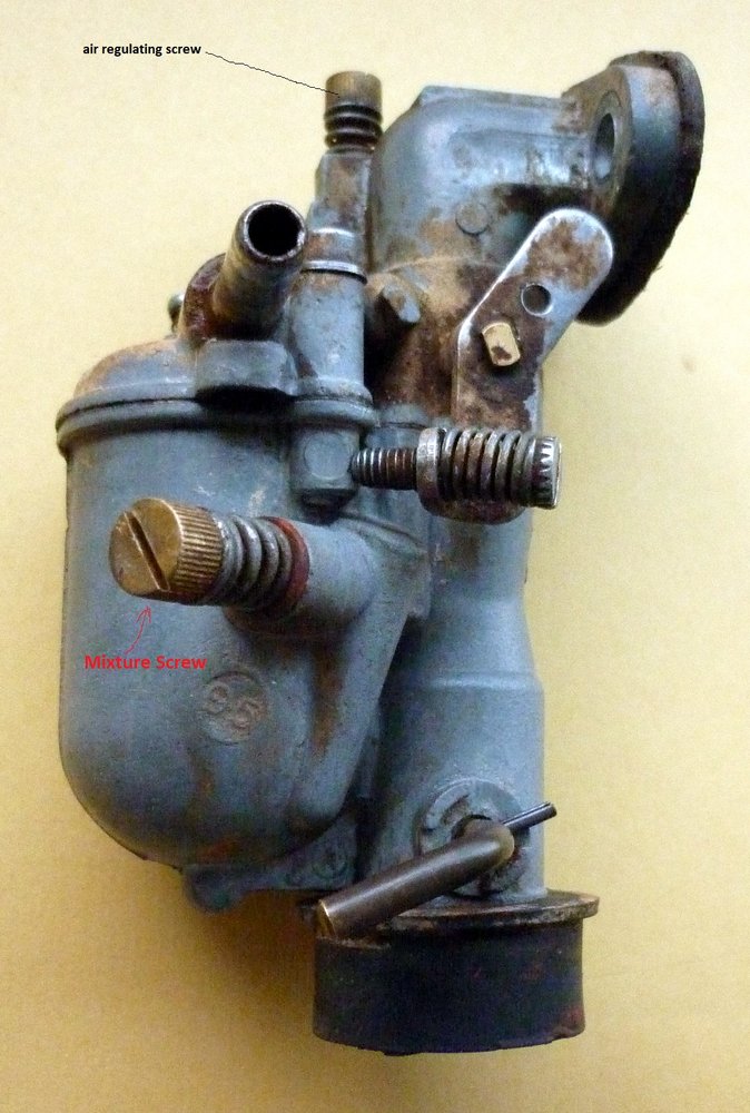

I have an old Suffolk Punch petrol lawn mower which has a Zenith carb, model 13 TCA-2, as pictured. Something I’ve never quite understood about this carb is that it has two screws that control the mixture. On top, there is the air-enrichment screw and on the side is the mixture screw - see pic.

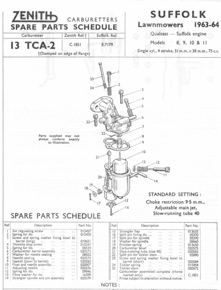

I’ve never managed to find any info on how to adjust these screws other than that the enrichment screw should be ¾ of a turn off its seat and the mixture screw ¾ to 1 turn off its seat.
I wonder if anyone knows anything more about how best to set these up?
