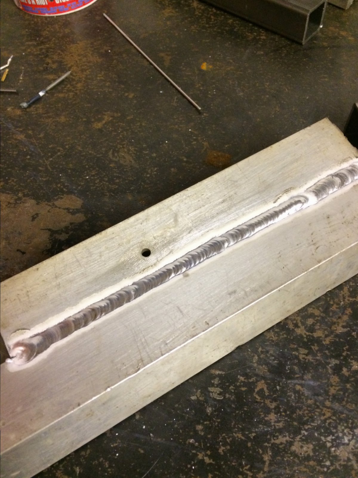

been looking forward to firing up the new water cooled setup, ck flex torch.
Just couldn't figure out why I was frying the tungsten and ceramic.
Well it was glaringly obvious, had my hoses wrong!!!
Arrrggggh
Piped the gas to the cooler, not thinking just treated as I do with aircooled, dinz adapter gas inlet is now the water collect inlet.
Now I have a gas line with coolant in it!
As luck would have it though I have a spare gas hose. But ran out of time today.
