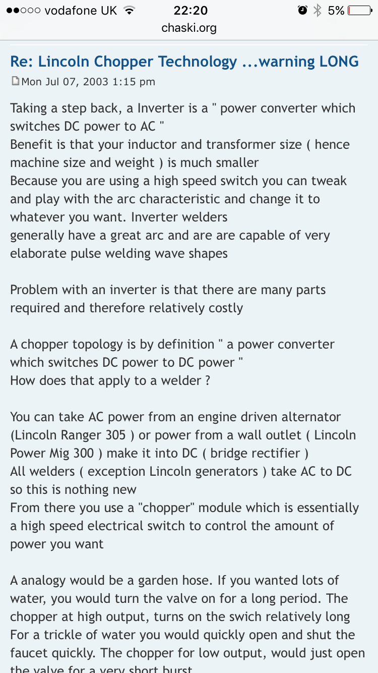

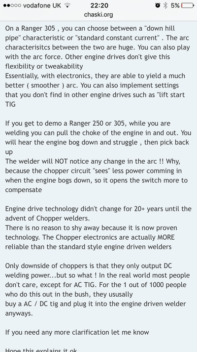

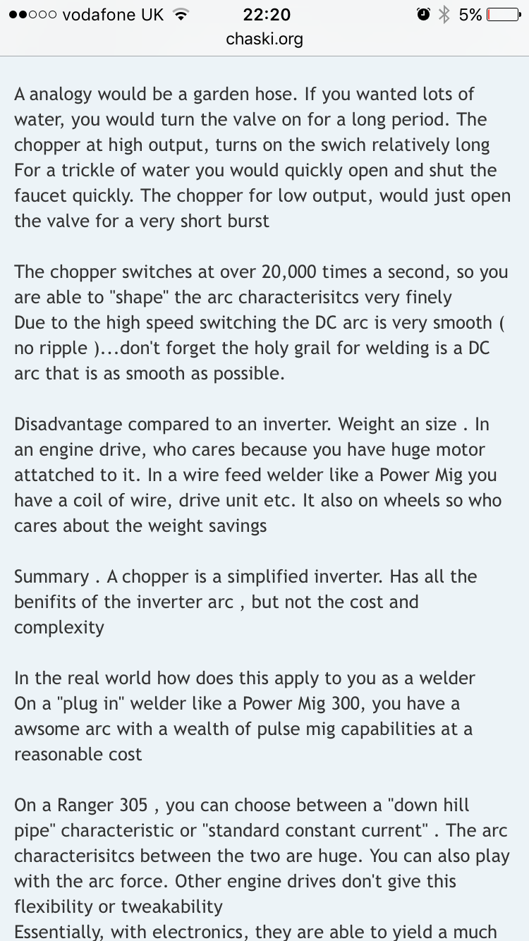

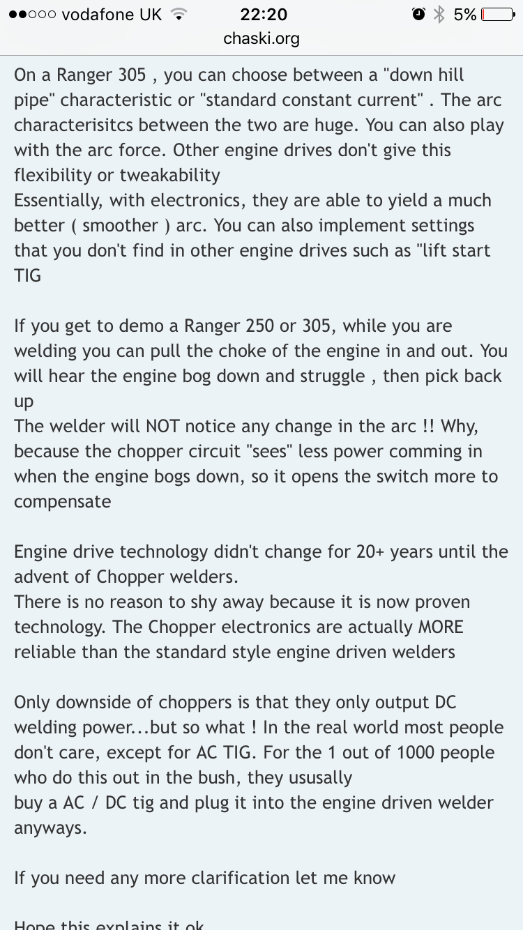

OH they must be wrong then http://www.sgs-engineering.com/sw200ac-welder-petrol-generatorHow can they have a higher Hz @normspanners engine drives put out DC current. Not AC
Well you asked a question and I gave a few answers, I am not bothered if you dont like the answerquite a few various welders employ HFDC now.
IIRC it is not a circuit persay in the old midgets for instance it is the fact they are an alternator which is chopping the dc when rectified some say it is that action of that pulse that keeps the weld puddle free of contaminationI think the point of the high frequency chopper circuit is that it is able compensate for fluctuations in engine speed whilst presenting an output that is, to all intents and purposes, pure d.c.
