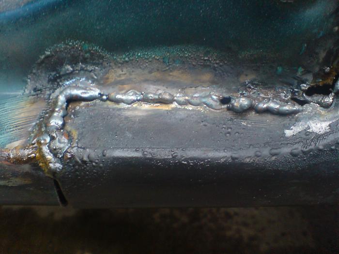

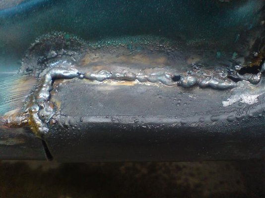

Right hope I make sense trying to explain this when I got my mig welder set up with the gas it worked great on an old quarter panel from a rover 200 even at low amp I got good welds nice sizziling sound. Now when I try to do anything now I get a stuttering sound and I can't get a good arc.I have to go really close to get a good smooth weld but it last a few seconds then starts stuttering again. I have replaced the wire liner and contact tip still no difference. I have been welding outside could a slight wind effect my arc any ideas or am I doing something really wrong
regulator freezing?
