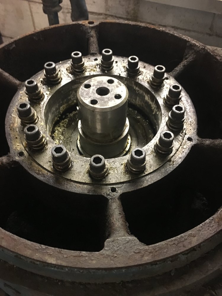

and the surprise is?Just wait until you install several grands worth of taper rollers with their specified spacer to set clearance . . . tighten everything to their specified torque . . . and it locks solid . . . Pick 8 tonne of machined fabrication up to press the main spindle out to investigate . . . no find anything and reassemble . . and it works . . .

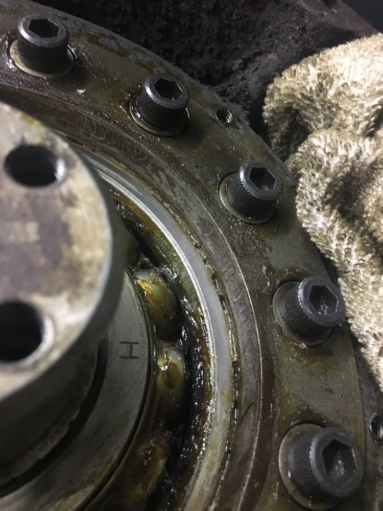

Done that many times but in this instanceYou've never heard of the old trick of running a bead of weld, letting it cool so it contracts and practically falls out?

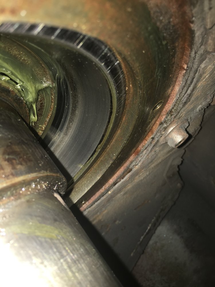

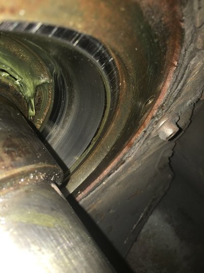

No fineThe bearing housing wasn't knackered at all ? I've seen a few where the bearing has spun in the housing and most of the wear has been there rather than the bearing outer.
