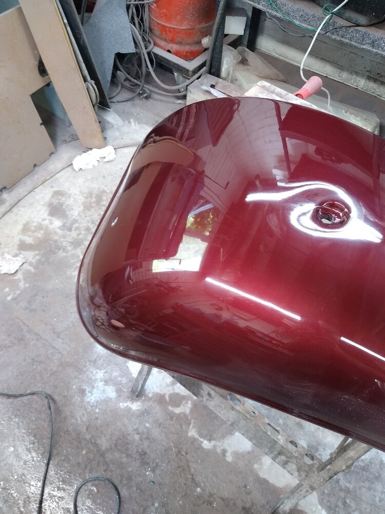

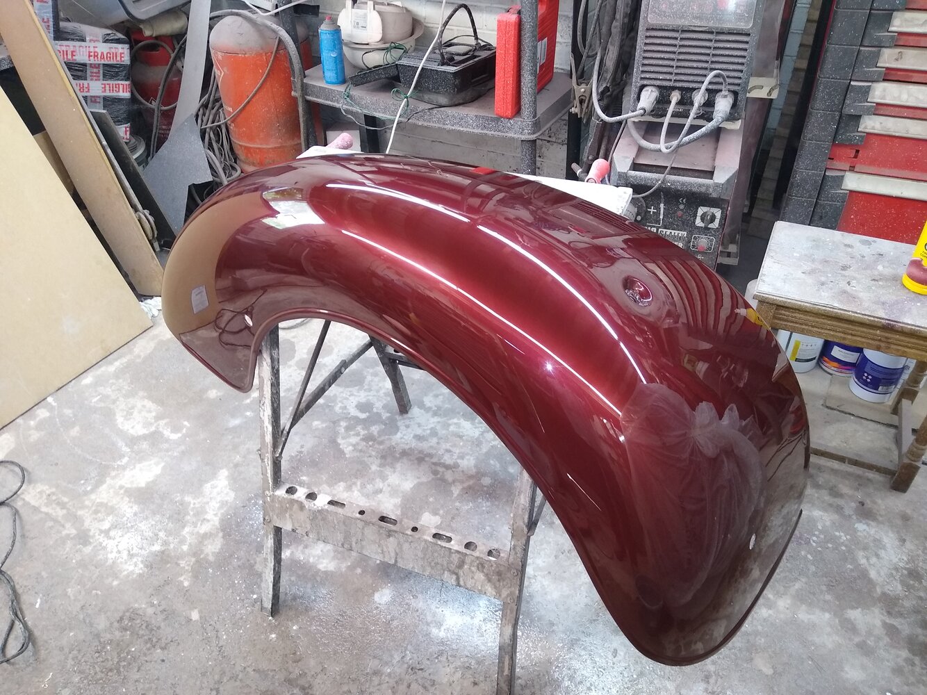

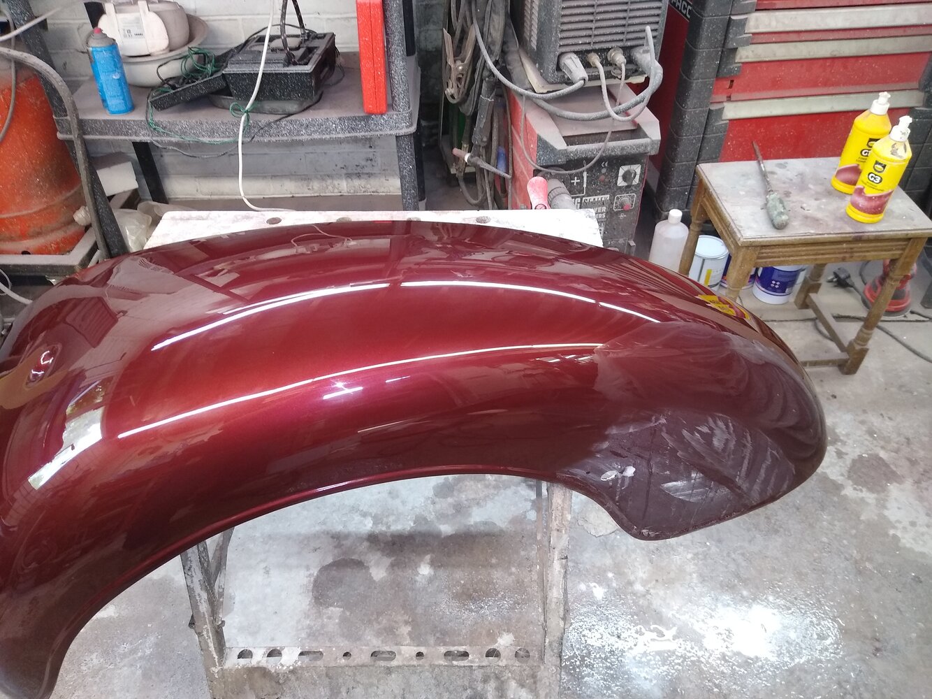

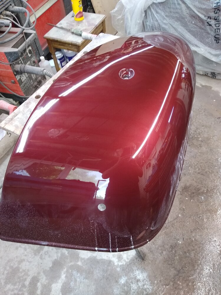

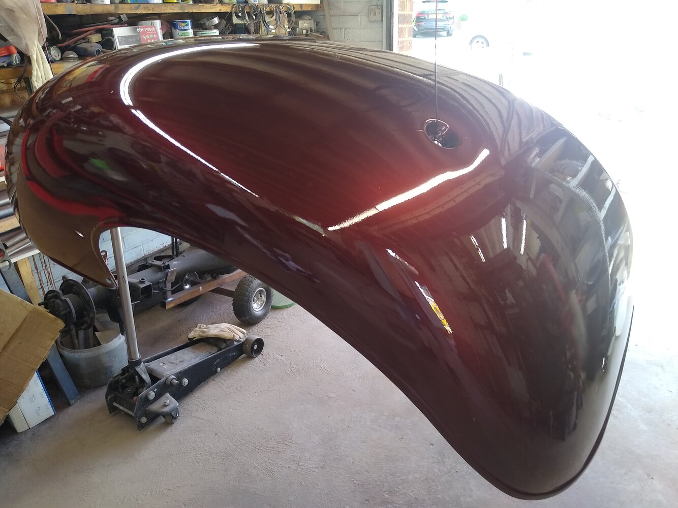

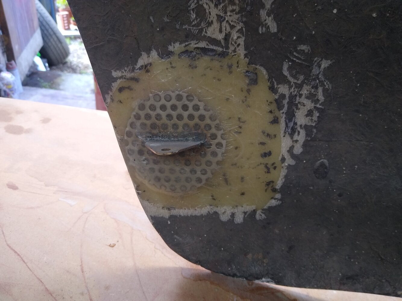

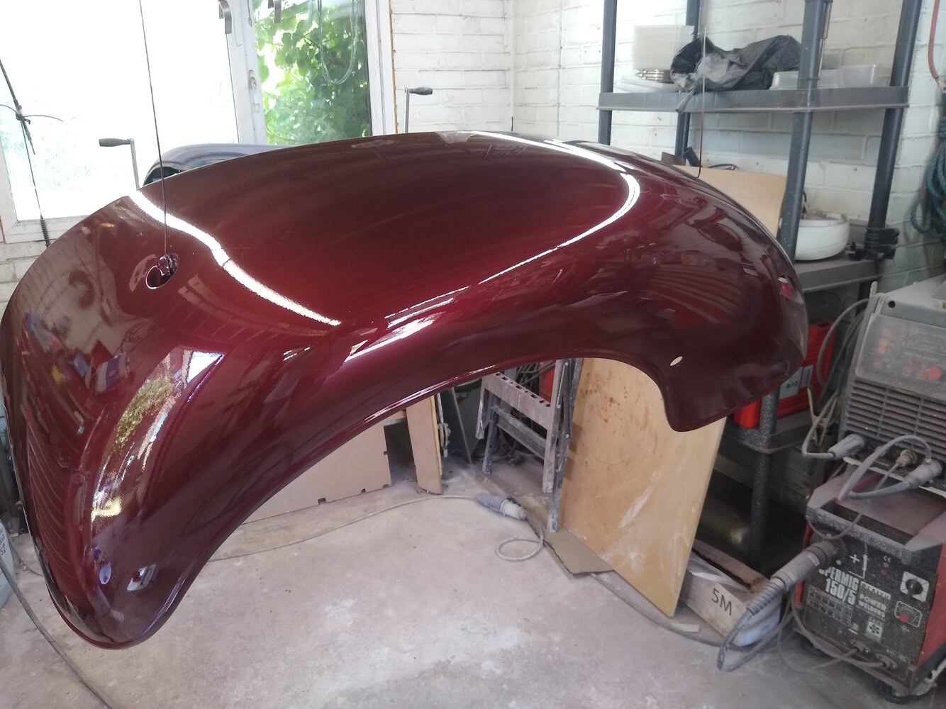

Looks greatThe two front wings for wifey's pop. These are fibreglass and were not very good mouldings. I've had to do a lot of work to get them to an acceptable standard. I've added some bonded in brackets for wing braces.

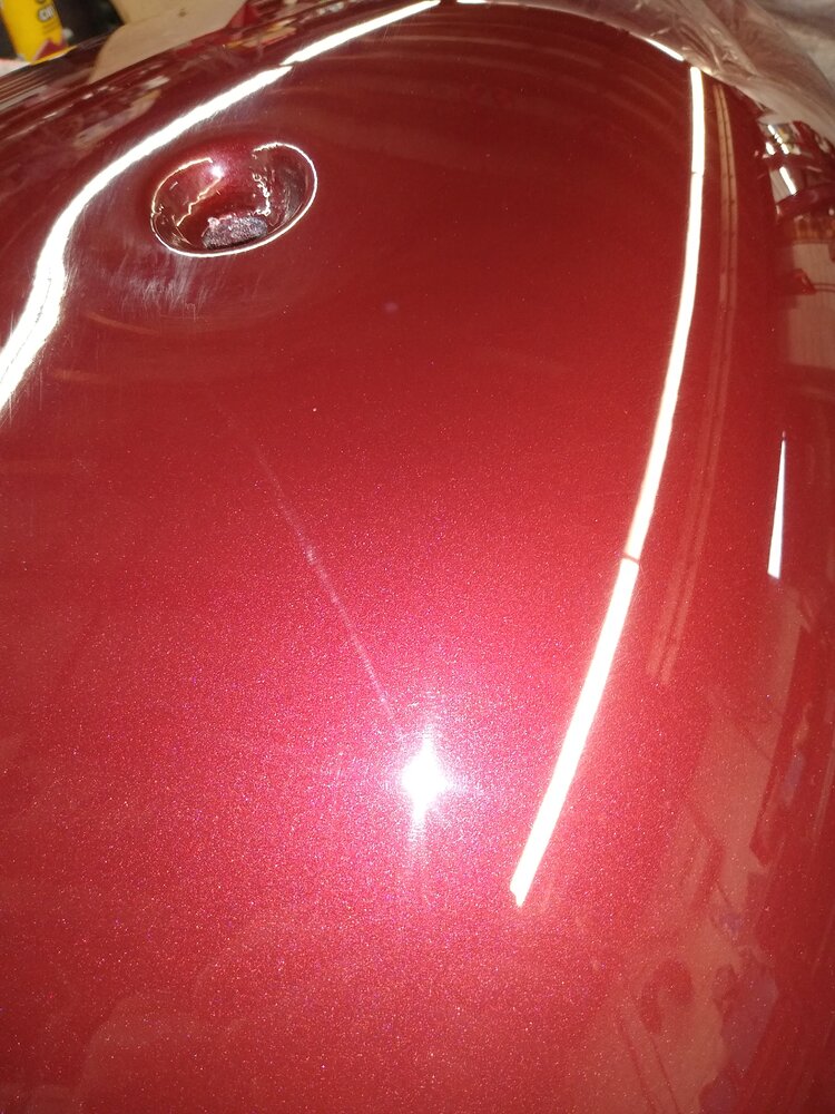

From the gun, one has a run and some orange peel to sort but that's what sanding and polishing is for.
To get enough space for spraying these I had to roll the Pop out into the drive for the first time in some years, the first time I had seen the paint in the sunshine. It really pops, pleased with that.

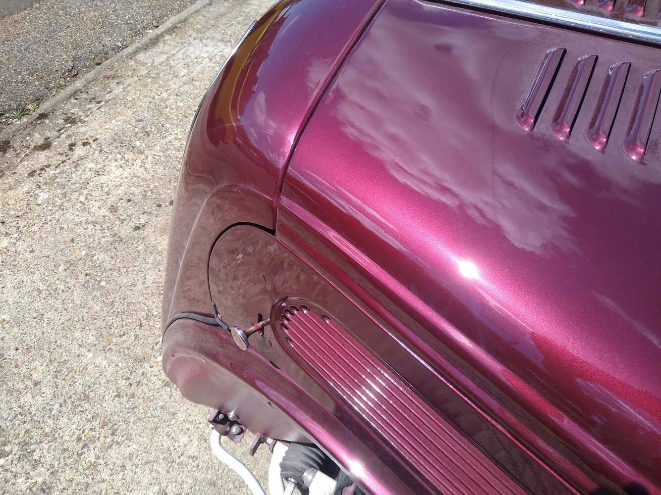

Not so far except for the bonnet panels. I'm not totally happy with them but I strongly suspect the amateur doing the job rather than anything else. I need to see it properly outside (it was mostly sheeted over today) before I decide if I need to redo it. I'll leave it until after the BIVA anyway.Looks great
Do you have any problems with the paint looking different doing the panels individually?

The other one now done.

Re colour matching did you spray them all at the same time and the above is you working through the final wet flat and polish stage?
I wonder could spraying metallic paint at different times / angles cause colour mis matches.
