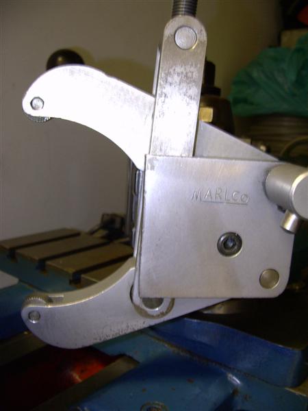

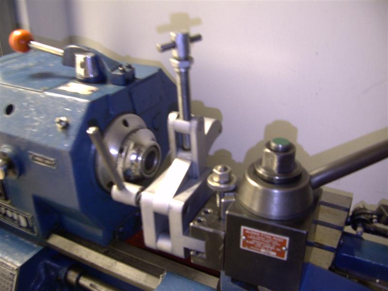

I use a clamp type on my Myford. I wouldn't use the push in type....I have a knurler of my 'to buy and try' list. I'm minded to go with the 'clamp' type over the 'push' variety as I'm conscience of the potential strain on the small Myford.![]()
Clamp type is the way to go, but Id recommend making over buying it. My one is not great quality for the £25 it cost - the wheels are on pressed pins, one is a sloppy fit on the pin and in the frame, so it wants to walk to one side.I have a knurler of my 'to buy and try' list. I'm minded to go with the 'clamp' type over the 'push' variety as I'm conscience of the potential strain on the small Myford.![]()
Although I generally prefer making tools if I can, I was too lazy in this instance and bought a clamp type one and it has been excellent. Can't remember where I bought it from though...Clamp type is the way to go, but Id recommend making over buying it. My rgd one is not great quality for the £27 it cost - the wheels are on pressed pins, one is a sloppy fit on the pin and in the frame, so it wants to walk to one side.

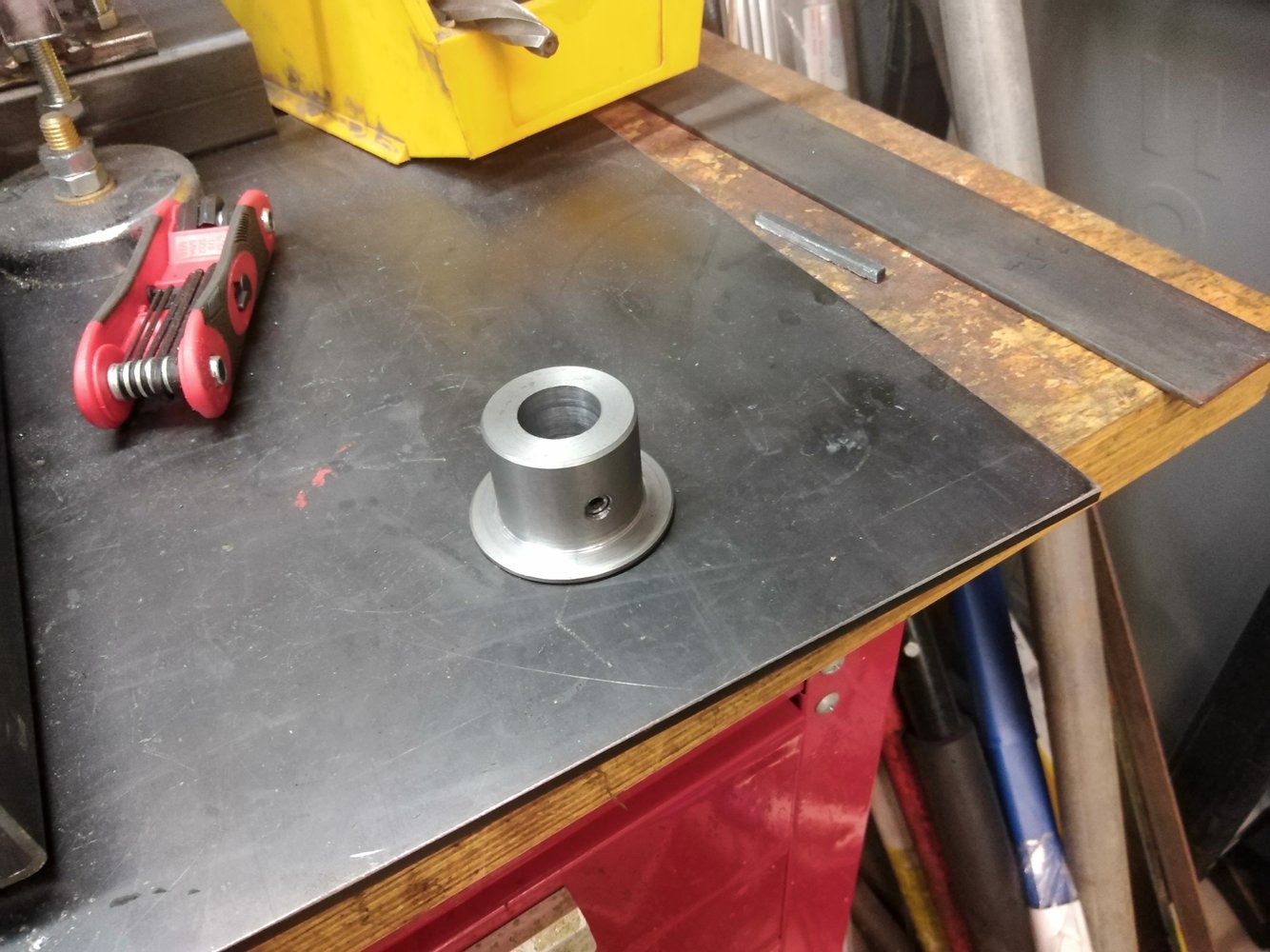

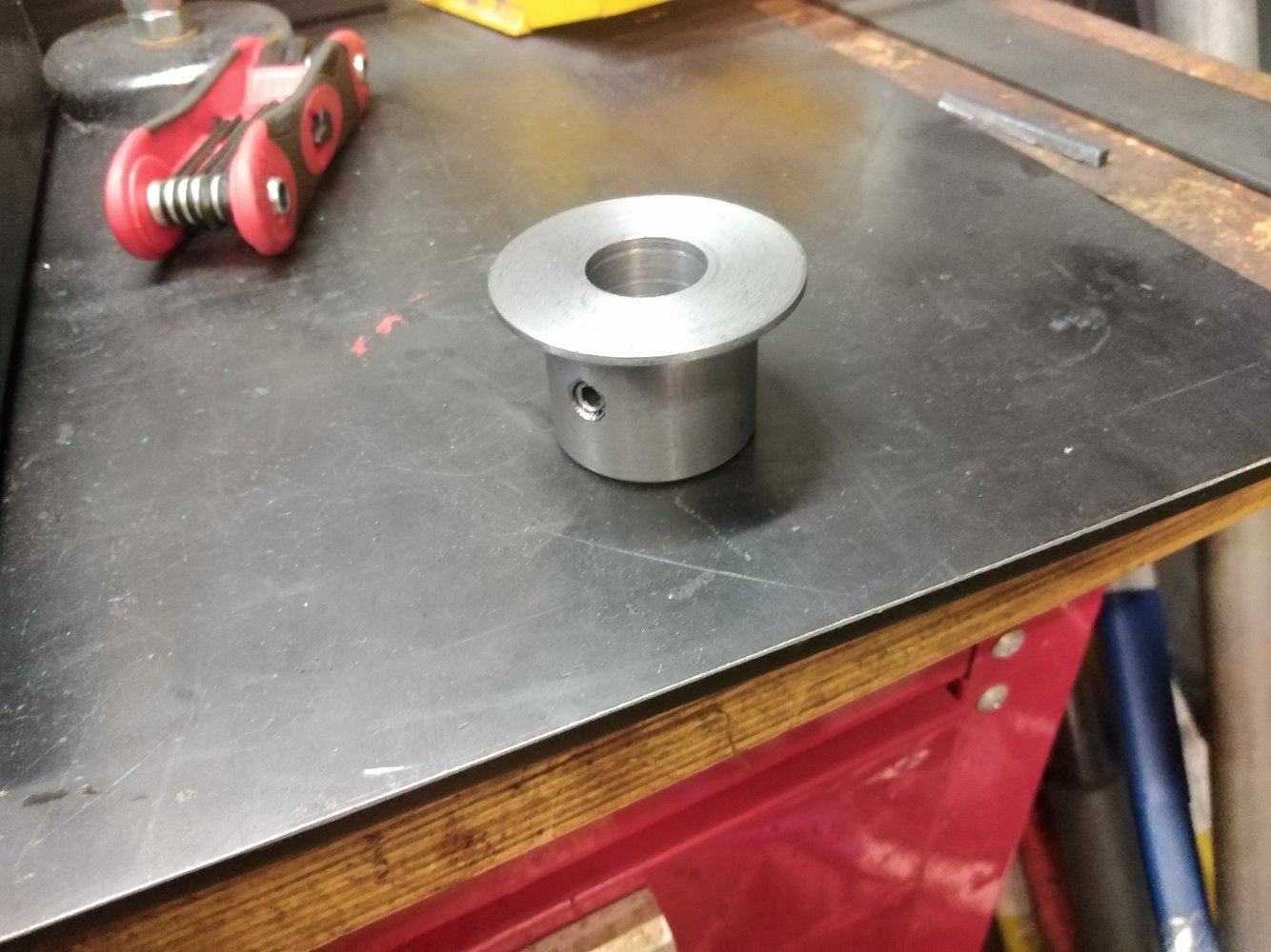

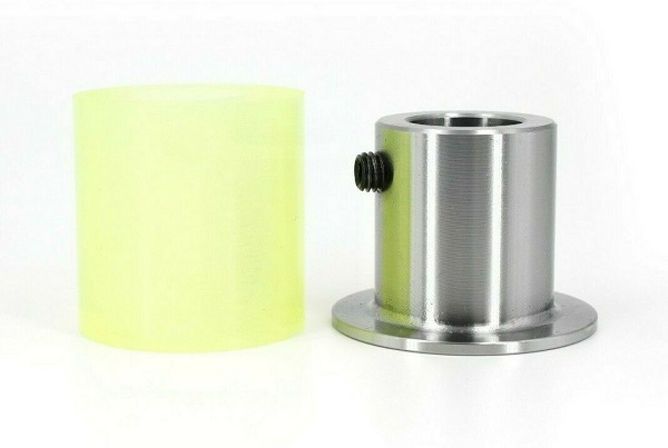

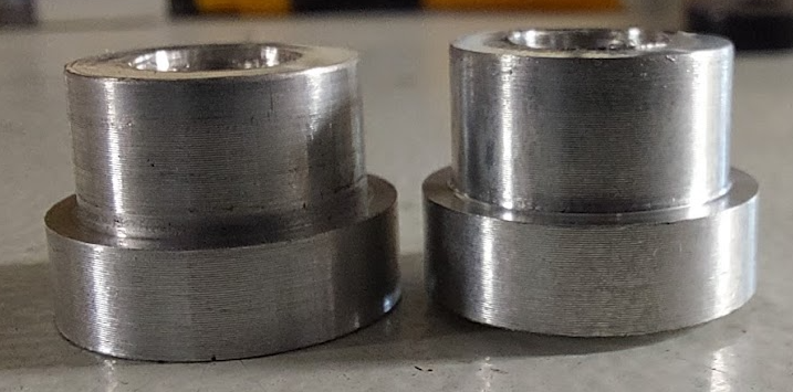

I turned up a seal insertion ring for a mate.
I didn't ask him what he was doing with itMarine biologist is he?
"Cut knurling" is the way to go if you can get or make the tool - I discovered them a few years back and wouldn't go back to clamp or push styles if I had a choice.
That's been on my list of things to make for a long time, but I'm lacking in round tuits."Cut knurling" is the way to go if you can get or make the tool - I discovered them a few years back and wouldn't go back to clamp or push styles if I had a choice.
Please do, I'd like to see the details so that I can copy it!That's been on my list of things to make for a long time, but I'm lacking in round tuits.
