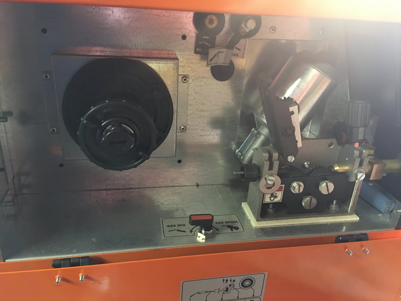

Interesting .When I didn't feel like drilling a hole in the end of my nice shiny new GYS Mig, I used the same tube on axle stand setup to sit the 15kg roll on, then wound wire from it onto an empty 5kg roll mounted in the lathe, running the lathe quite slowly, guiding the wire with a stick as I didn't want to see if mig wire would do a good impression of a cheese cutter on my fingers.
The really interesting bit is controlling two ends of wire on two rolls when you cut it . . .
