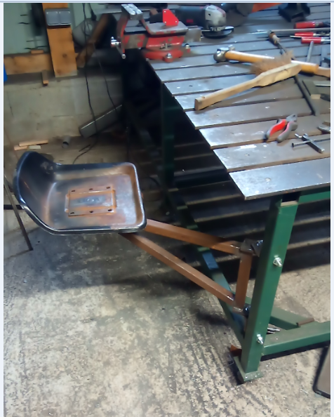

You won’t regret that. I use mine a lot.Been wanting to knock one of these up for a while, seat base has been in the fabshop for ages, well today finally decided it was time, have a few TIG jobs that would be far easier sat down. Seat swivels, and it folds out of the way..
Lawn tractor seat, some 30 x 30 tube, 20mm dia tube welded into the end of the frame, big bolt for swivel on seat base, 10mm plate and 50 x 50 angle for hinges.. Bolted on, as it might get relocated to a smaller dedicated table later.. Works well, height is spot on for table, might need to make up a box for the pedal to sit on, just a wee bit too low to be comfortable... Will try it first to see how it goes, that can be done later. Might even paint it, next time have some left over in the spray gun...
.Just need to get some 20 x 2 flat strip (removable) to seal the spaces between the plates on the bench to avoid spatter dropping through onto my lap....
Great idea but dont forget to cut those bolts down!!!! I can imagine the pain of catching a knee on them ........................![]()
