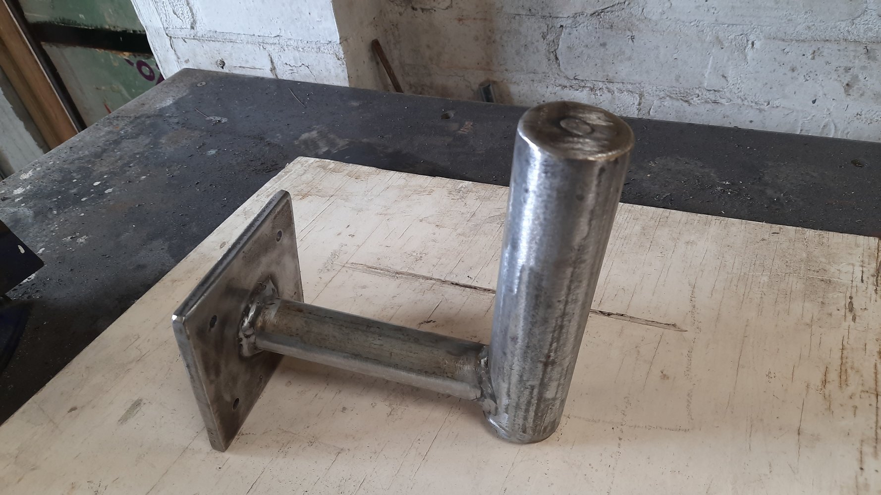

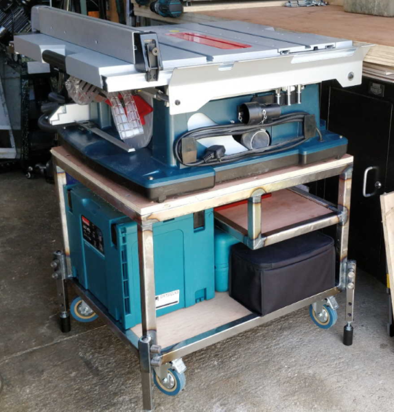

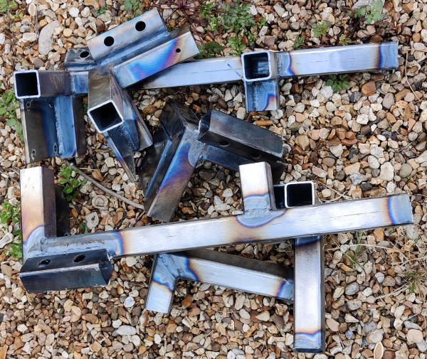

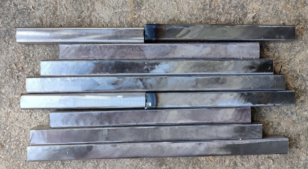

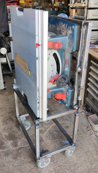

Today I made some progress on turning this table saw trolley I made a while ago:
Into this:
and this:
and (along with another length of box section and some flat bar) from thence into this:

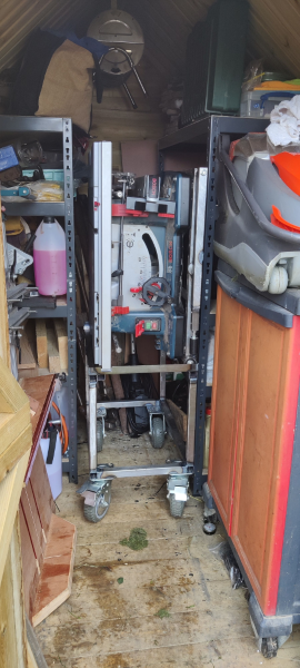

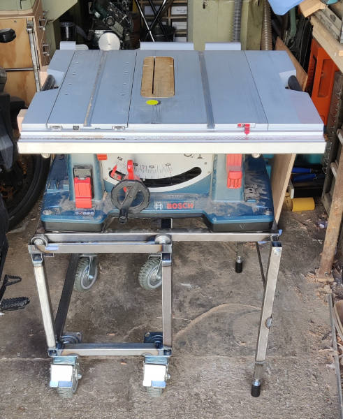

The new trolley (which will probably gain some drawers in the bottom bit) allows the table saw to be parked on its end like this:
which in turn allows me to take it on an obstacle course down the garden path and across the lawn and put it in the shed like this:
Thus freeing up quite a lot of space in the garage. It still needs more stuff doing to it (including the drawers, but also some other welded additions probably) before it gets painted (and this time I probably will paint it as the shed is a little bit more prone to corrosion than the garage.

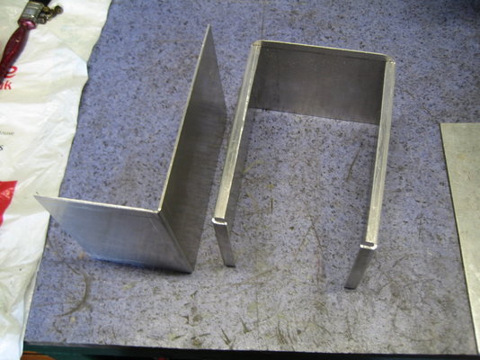

Into this:
and this:
