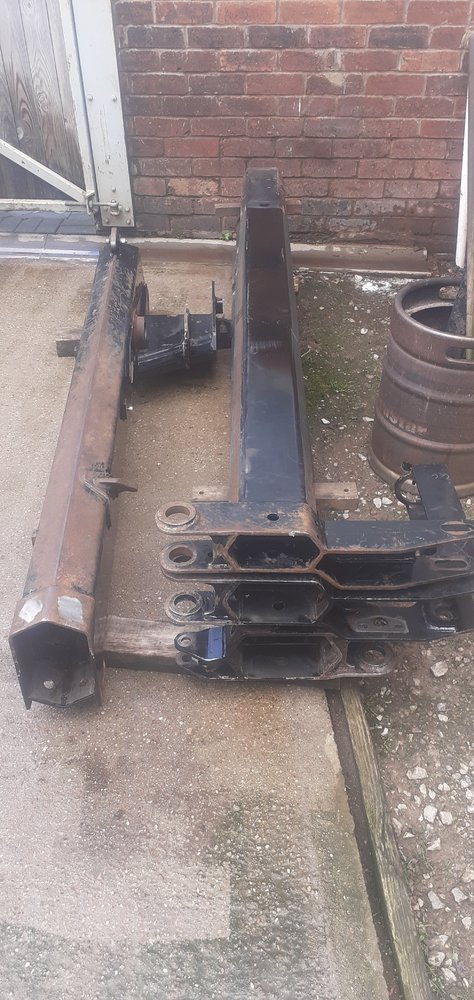

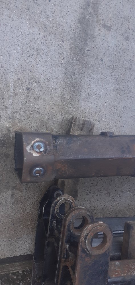

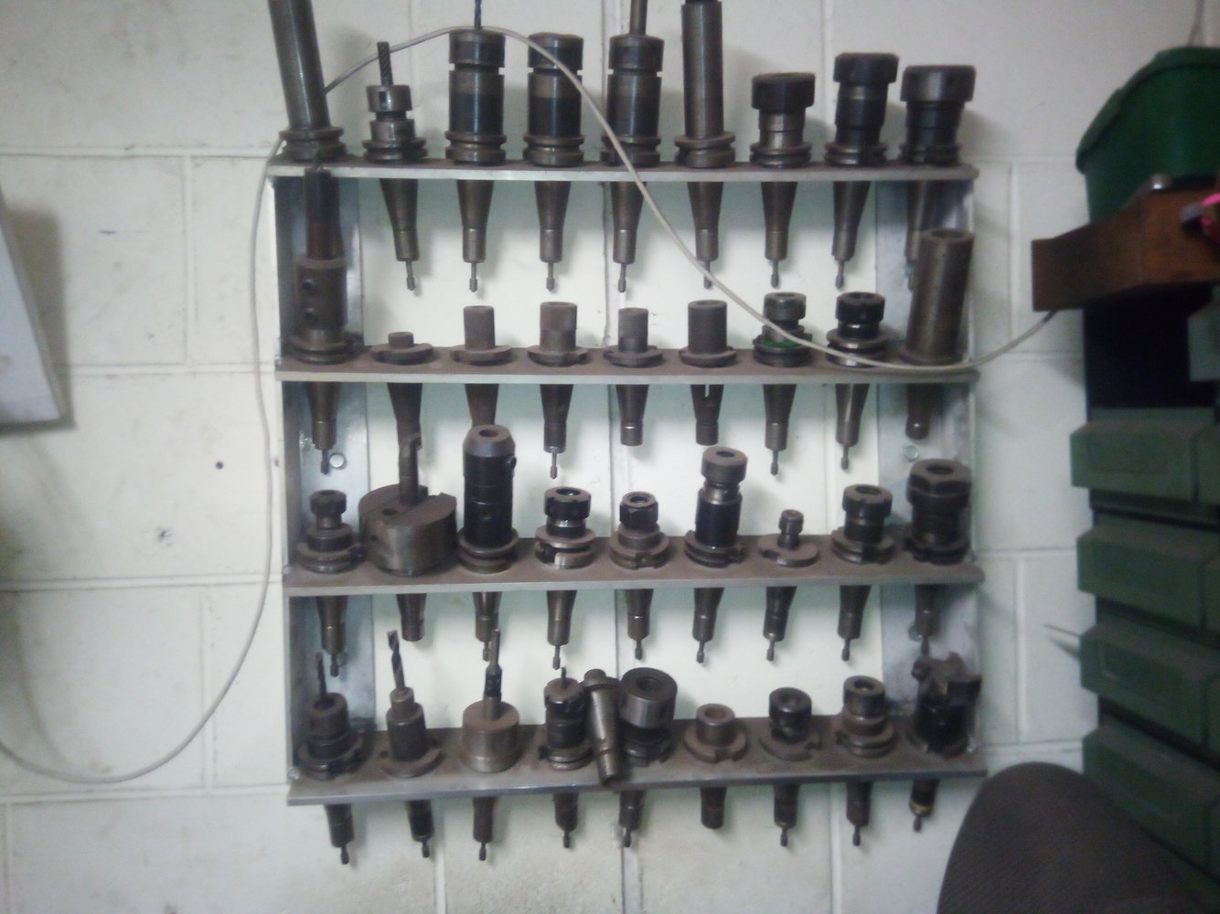

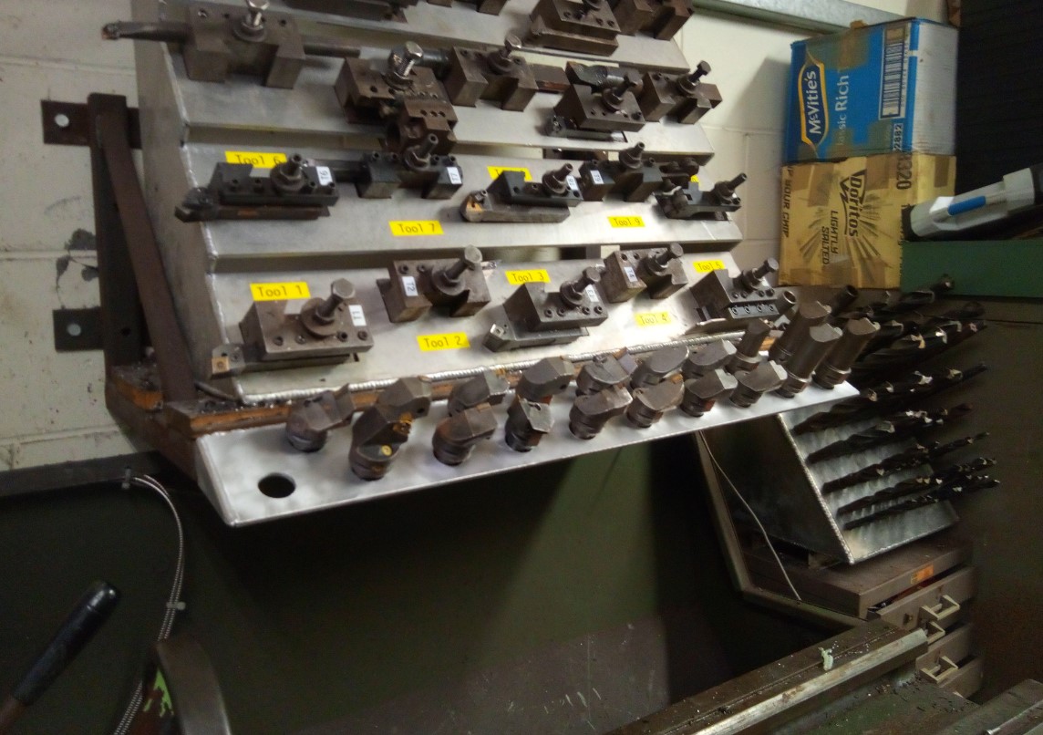

Getting the proper branded Thunderbolt ones is a world apart to the cheap onesThey hold exceptionally well as long as the hole you initially drill is the correct size. I have heavy transformers, lathe tools, milling tools, welder brackets etc all held up with them.
A couple of pics below.
View attachment 292069View attachment 292070
