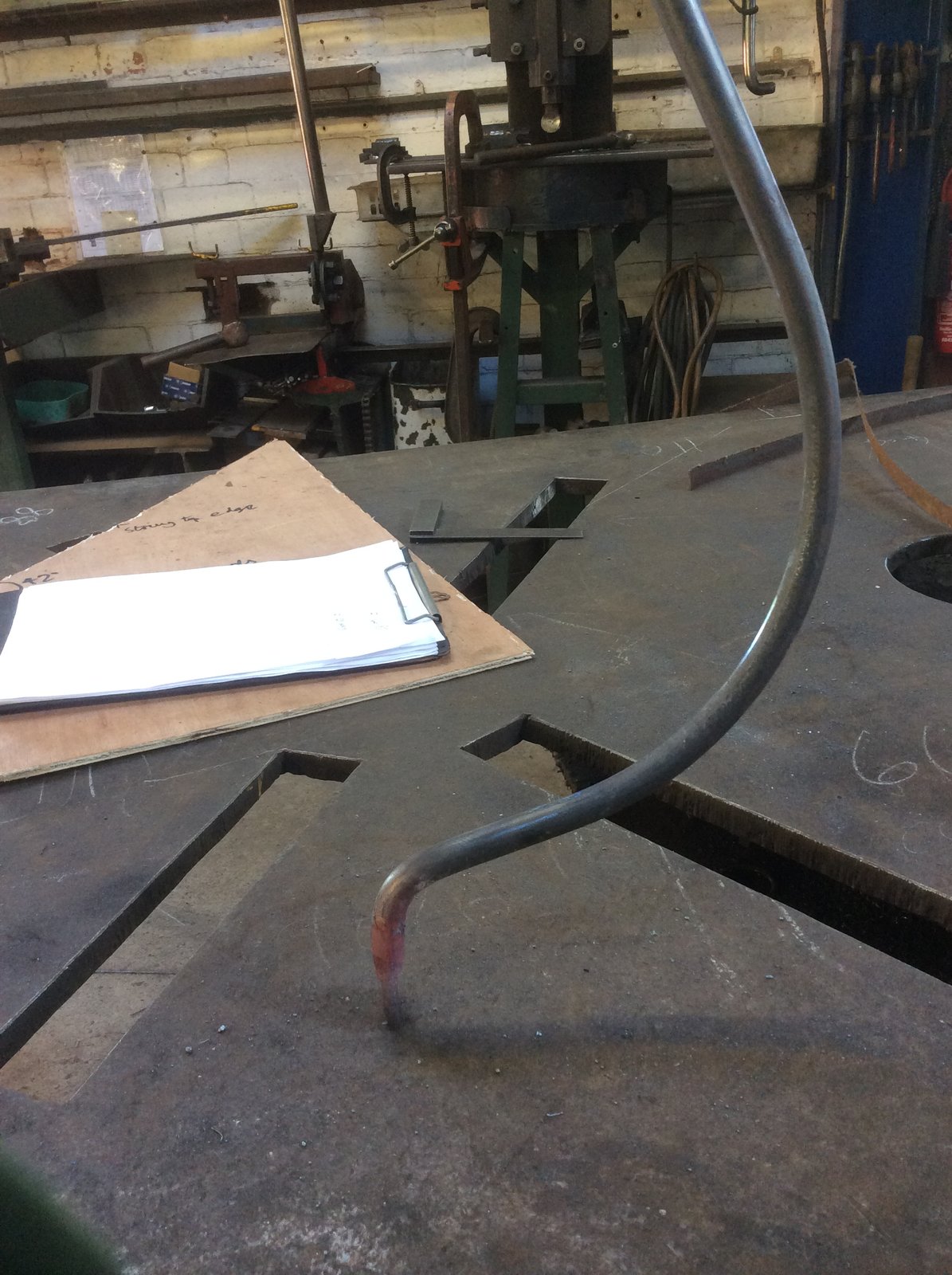

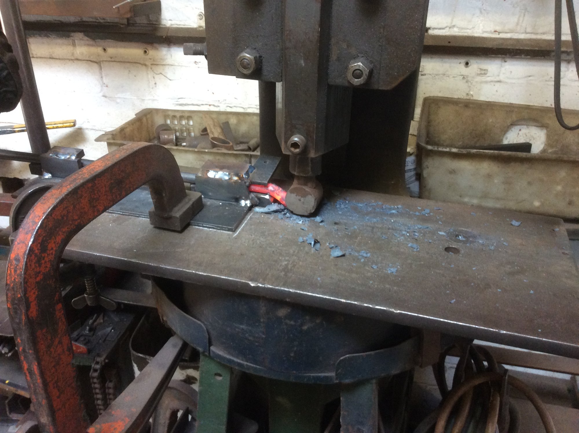

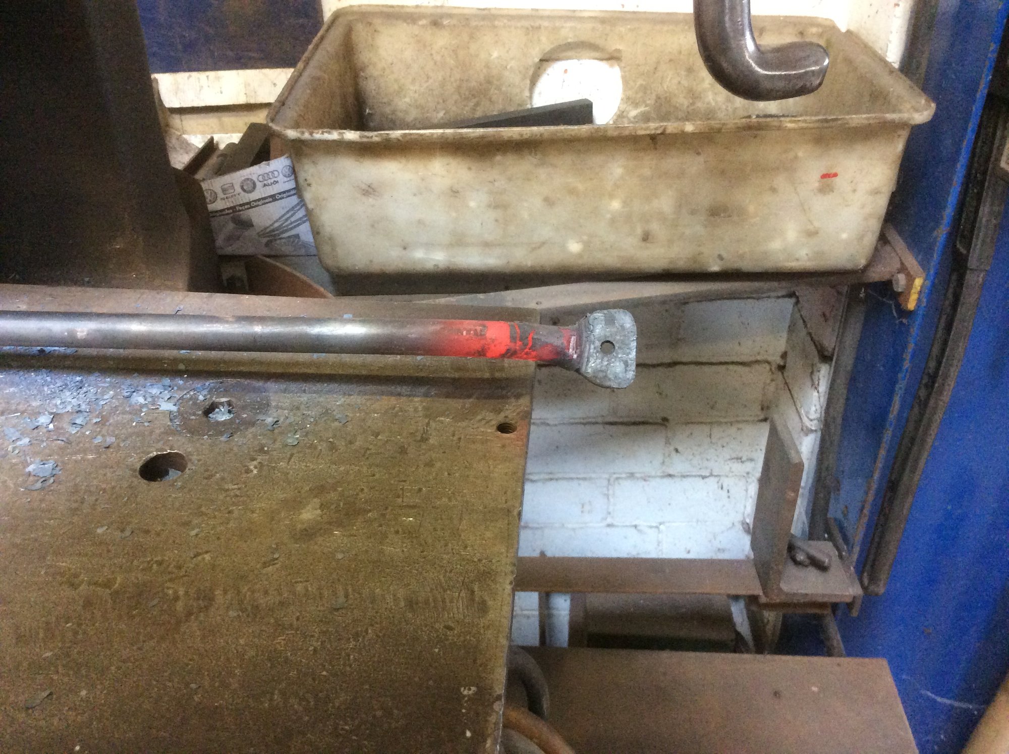

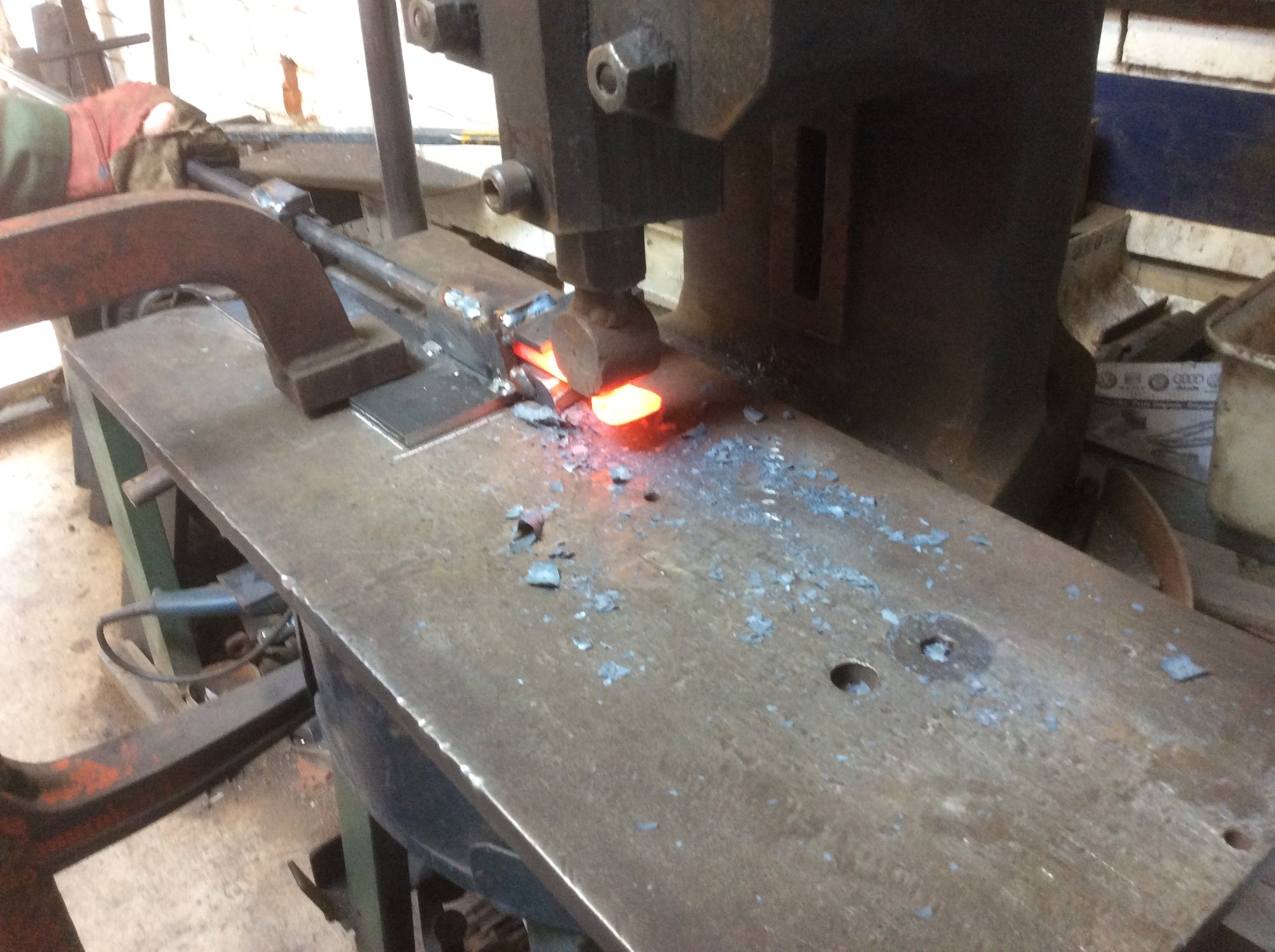

I first forged a splayed end on the bars for a screw mounting,then made a crank to keep them on centre line,the top end was drilled & tapped for screwing into the half round.

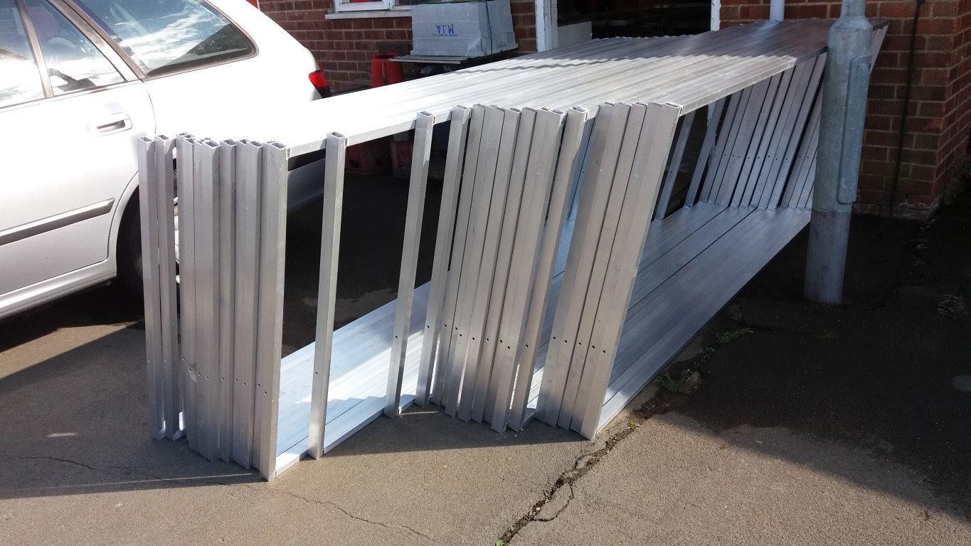

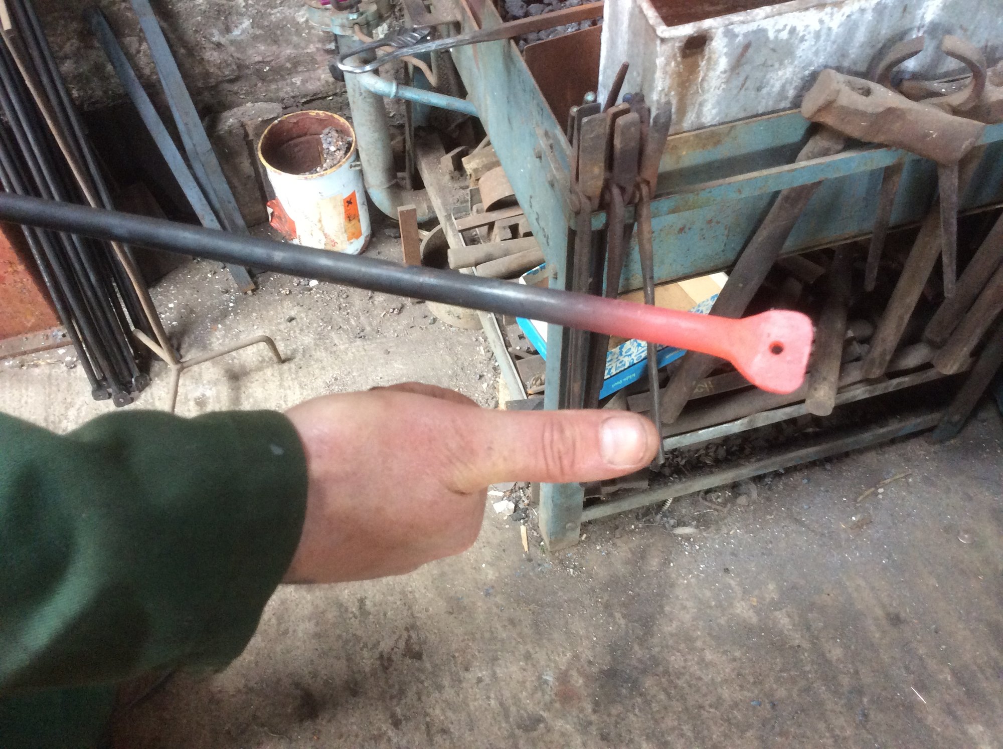

Nice nick. Always been interested in your work. I'm only in three cocks so I should call by one day.View attachment 119390 View attachment 119391 View attachment 119393 View attachment 119395 View attachment 119397 View attachment 119399 View attachment 119400 View attachment 119401 View attachment 119402 More photos of the balustrade with the half round handrails I posted 2 weeks back.
